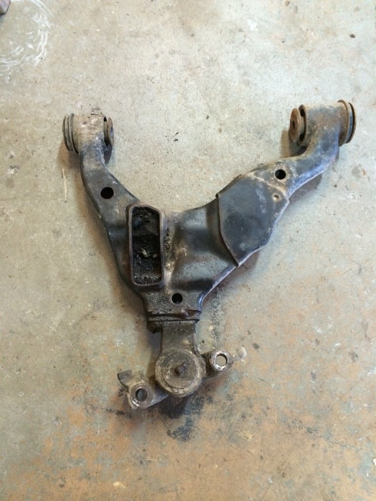

    the small front one popped right out the rear one took some persuasion

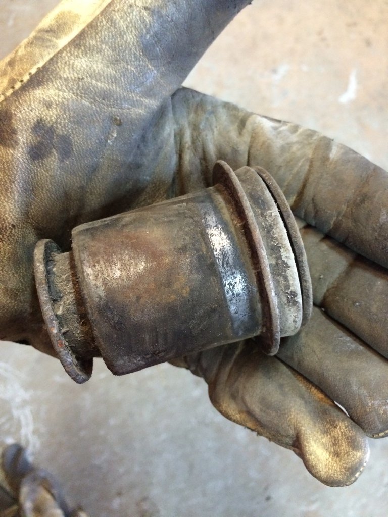

    this was the driver side front that was clunking you can see the witness marks where the bushing was moving inside of the control arm

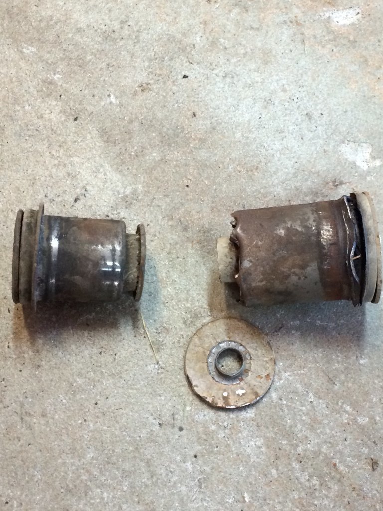

    rear took persuasion just like the passenger side rear. that is how a bushing should fight to come out. clearly moog has their dimensions incorrect for the front bushing

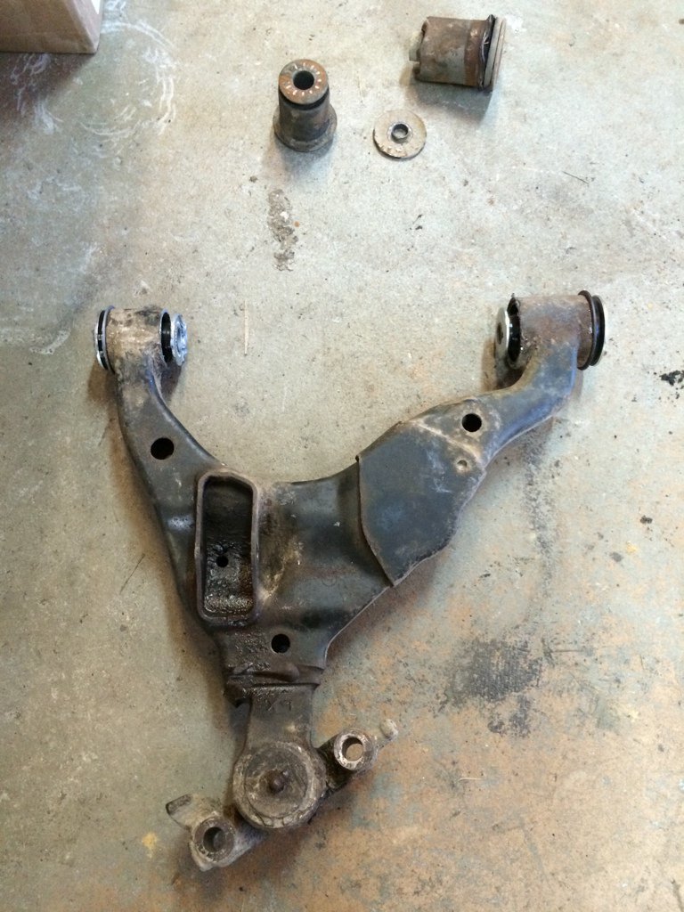

    driver side done and going back in
