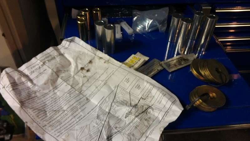

    Hey Crom. Yes that is my truck. I have not had any issues with the Whiteline bushings. I visually inspect them every other month when I hit the dirt. I had my buddy at a dealership install the bushings, he said that they were a pain and he had to use their heavy duty press.
    One thing I do remember about the Whiteline bushings is that the kit came with different size washers and sleeves. But the instructions were pretty good and gave specs on what went where. The kit I believe crosses over with the Prado?, but I'm not 100% on that anymore, it's been awhile.
    I'm actually in the process of upgrading to the TC 3.5" LT. I'll post up some pics of the bushings when I get around to pulling the parts off.
    Here's a pic that I found....
    Ignore the gold sleeves on the left. The whiteline kit came with the 6 silver sleeves and all those washers.
