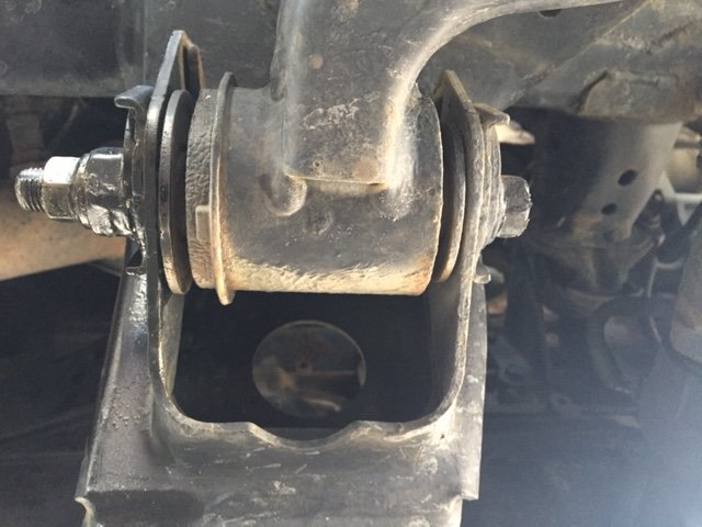

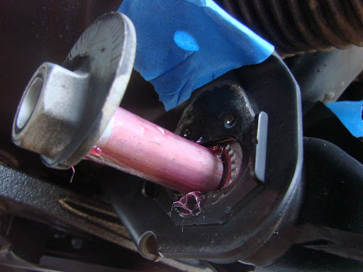

    Hey all,
    In preparation for installing my 5100's I took a look at my LCA cams/bolts, and I think they're probably fubar'd (truck spent first 4 years of its life in NY). But I also have never done anything with LCA's or alignment cams before so I'm not entirely sure what I'm doing. In the picture below, I want to loosen the nut on the far left correct? Once that's loose, in theory, does the left side cam just slide off the bolt and then the bolt slides out to the right? I'm going to try some wire wheeling and PB blaster but am mentally preparing myself to wage war against the bushing/sleeve that are undoubtedly welded together with rust/corrosion. Assuming I can't get the bolt out, do I want to sawzall in the gap between the right side of the LCA and that disk (what is that disk anyway)? Once the LCA's are out, I'm hoping I'll be OK armed with a ball joint press set, impact wrench & breaker bar, gallons of PB blaster, and a plethora of colorful 4 letter words...and of course new bushings and cam bolts (I think I might try Moog).
    Thanks,
    Josh

    Hey Josh, I used a sawzall -- load up on blades. That "disk" is part of the bushing. If you like cursing, throwing tools and wrestling parts it's not a bad job. I have the OEM hardware and just grease them yearly.

    Boyd's picture of the lower control arm hardware may give you a better idea of what should come out of the control arm if not seized.

    Buy good quality blades. I went through 4 blades and only got halfway through 1 side of a bushing. Picked up some better blades and the same one I used still has some life left in it. Get some cutting oil too. It helps extend the life of the blades significantly. I just pulled all the cam bolts on my 07 FJ and surprisingly 3 of the 4 came right out. The rear passenger side though not so much. Not only was the bolt fused to the bushing, but the metal discs on the bushing were fused to the frame.
    I originally cut inside those discs to stay away from the frame, but since both of the discs were fused to the frame I had to do more cutting. I ended up cutting about half way down on both sides and stopped cause the blade started to deflect and cut into the frame. Then I got a chisel and went to town with the deadblow hammer until the discs were freed from the frame. What a pain in the balls, especially since the first 3 bolts came out fine.

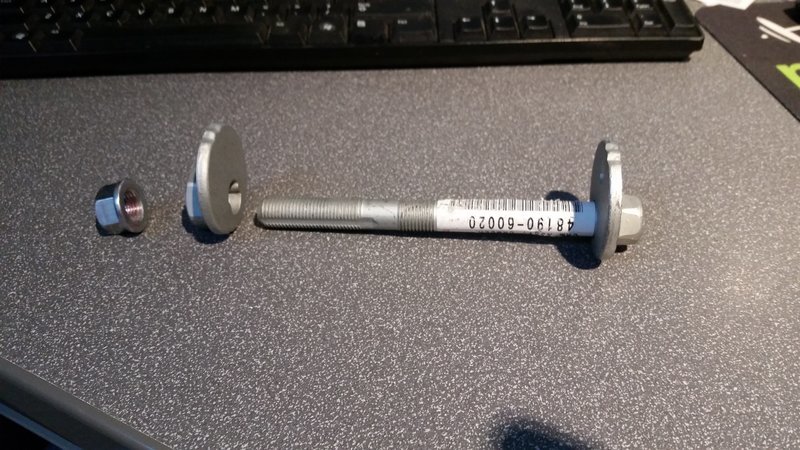

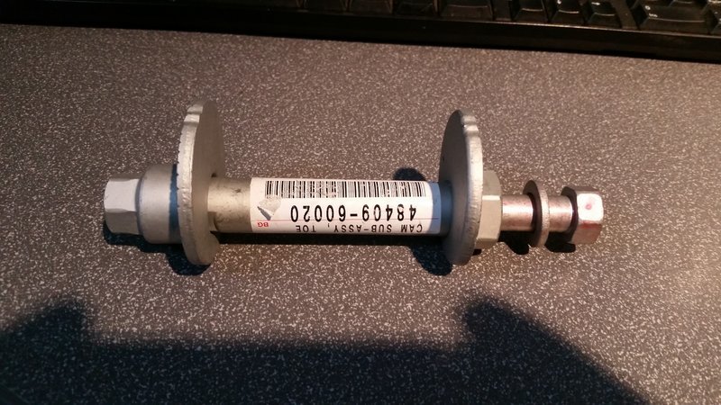

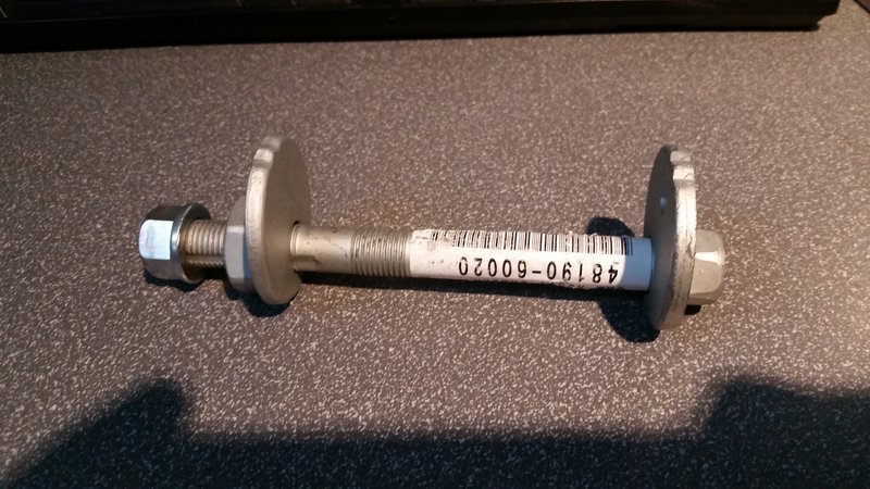

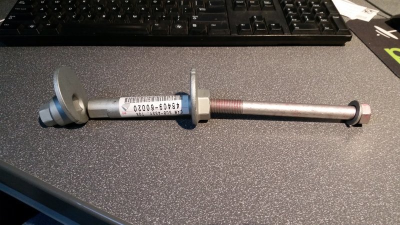

    If it helps any, the bolts look like this. I see pictures of guys greasing the bolts but you should also be greasing the cam on the large bolt because it can become frozen into the bushing itself. Also, looking at the bolts, it should be obvious how the frame tabs become bent as the cams/bolts seize and/or your tech doesn't understand how they are assembled and goes cranking on the wrong nut.

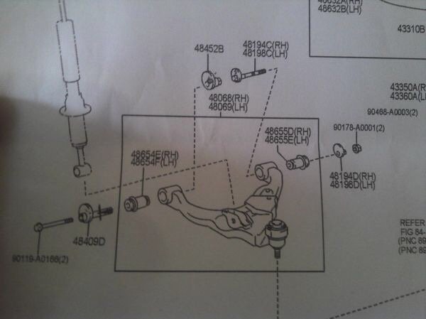

    Thanks pseudomike. Do you happen to have all the oem part numbers for cams/bolts/nuts/sleeves to do one control arm? I understand it is two different bolt sizes for one lca. And oem bolts/cams will work with moog bushings correct?
    Thanks.

    here ya go. I see no reason why Moog bushings should not work but read back through this thread a few have had issues with them lasting.
