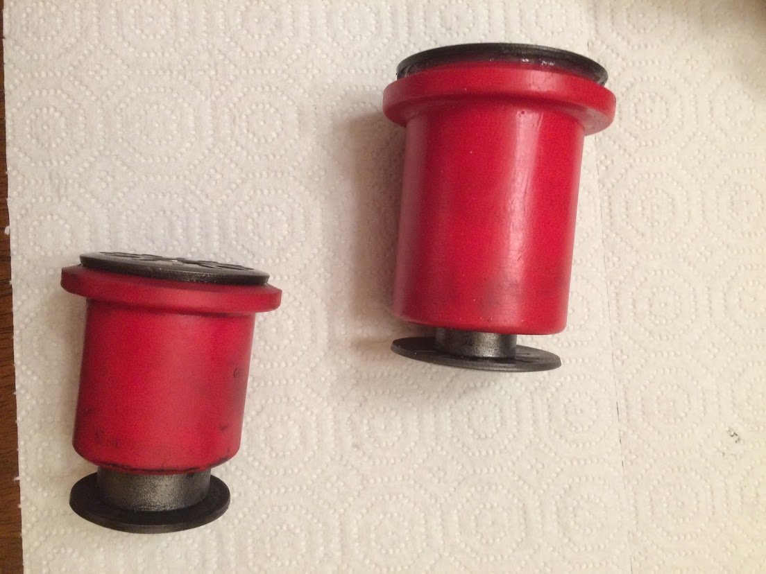

    So I got the Moog lower bushings and now I am trying to disassemble to put in energy bushings. Has anyone disassembled the Moog bushings? The seem to be assembled differently.
  18. Apr 2, 2016 at 9:15 PM
    #778
    Sevi88
    Sevi88 Active Member
    Mar 19, 2014
    #125663
    29
    Sevi
    WY-CO-PA
    06 TRD Sport 4x4
    5100 Bilstein, 5-leaf rear springs, Borla Exhaust
    7ZWVfWOnIl8lfHn2M6ZzcvC1gtL6u4nW8yp0WfxV_62085021cad6a5f9604cc69b980a5bd934dd67de.jpg
    Got them done

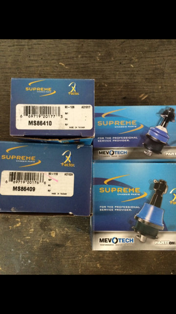

    I just replaced the lowers with the complete Mevotech Supreme LCAs from Rock Auto. They have the Supreme bushings and BJs installed and ready to go. Pulled out my old LCAs and swapped in these. New OEM cam bolts (all greased now) all around and an alignment and so far so good (less than 100 miles so far). All of the popping/clanking is gone from the old bushings/LCA. Also swapped in SPC UCAs at the same time to get more Caster.
    I'll see how these work out. I still have my OEM LCAs in case I ever want/need to rebuild them.
