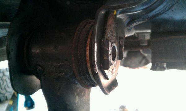

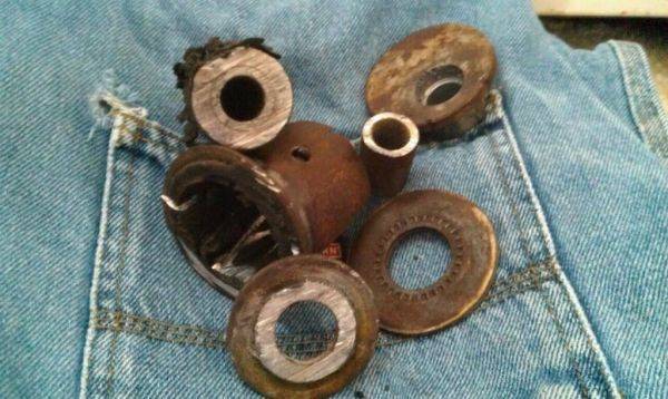

    Did my passenger front cam n bushing yesterday, and getting it aligned tomorrow. I went through 3 recip saw blades just for one bushing. 2 Dewalts, and 1 Craftsman. The Craftsman blade held up the best, and it's still usable, go figure. Here are some fun pics. Enjoy :D
    The culprit
    The end result
  5. Apr 18, 2013 at 2:36 PM

    They would probably be the same as the toyota bushing. I've found the rear lca bushings on rockauto, but the only other place I've seen the fronts were on the O'reilly site.
