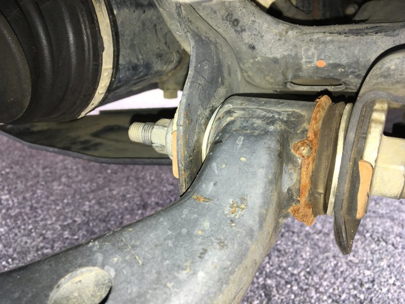

    I put my ground directly onto the tubular portion of the conctol arm and tacked roughly every 3/4 to 1 inch. The big bushing have about 6 tacks and the smaller bushing have 5. As soon as the tacks are done I dipped them into some water to keep the rubber from burning. Once dry hit with some black spray paint and your good to go

    I think that many tacks was over kill. I believe just 4 tacks per bushing would be sufficient but I wanted to be "sure"!

    Tacking the end of the bushing's outter metal sleeve to the end of LCA sleeve while its already in there. Do it in fashion that's easily accessible if you need to reverse it in order to get the bushing out. This will stop the loose tolerance sleeve from sliding/pivoting.

    ok, now i got it. didn't know that bushings could move inside of LCA, aren't they pressed in there?

    What he said. I already had my lca out because I had to (re) press my new bushing from where they had backed back out. Here is a pic from the front passenger side view. I did not paint them but I would recommend it.
