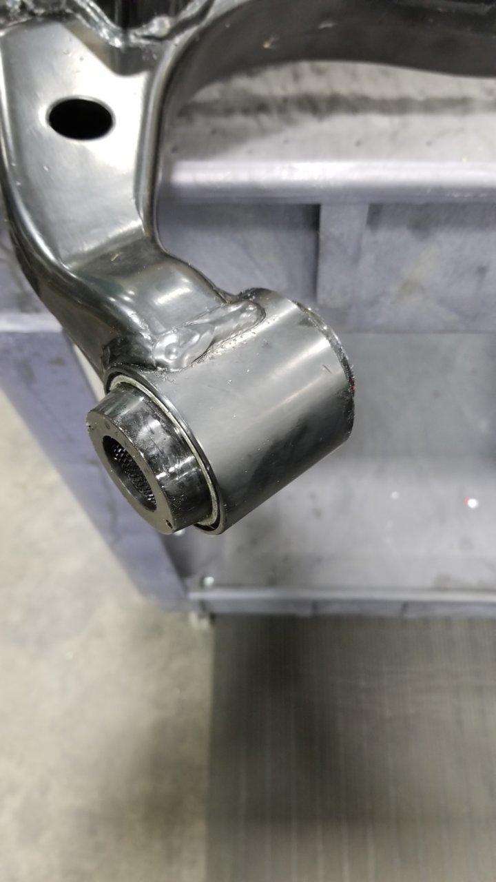

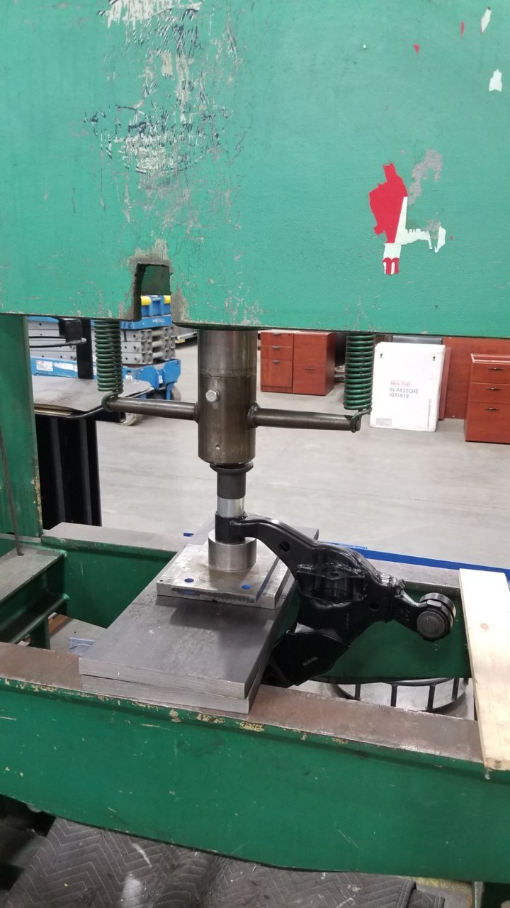

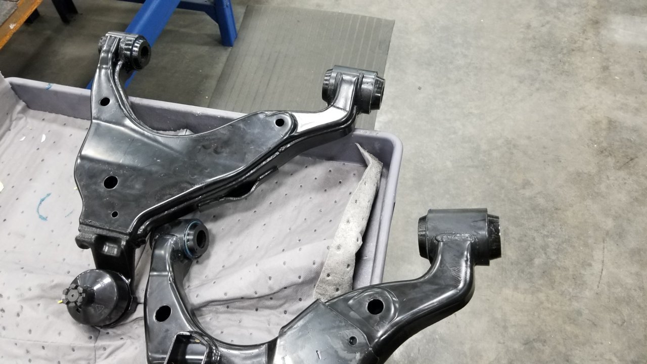

    I ended up pressing in the whiteline bushings at my work last night.

    @SC2SC pretty bushings
    SC2SC and gunn_runner[QUOTED] like this.
