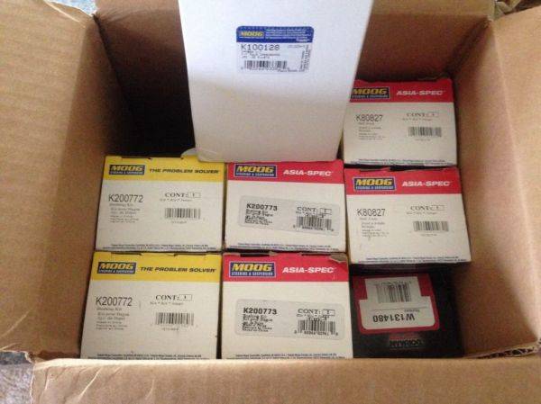

    They don't look to be completely hollow :thumbsup:

    HOW COULD I NOT $12 OR SO A BUSHING AND $33 FOR A SET OF CAM ADJUSTERS AND THEIR GREASEABLE...

    IM GETTING MY ASS KICKED INSTALLING OR SHOULD I SAY REMOVING THE BJS....
    LOOKS LIKE IM TAKING THEM TO THE SHOP TO BE PRESSED FOR $25....
    OH WELL
    OH AND TO WHOM EVER PRESSED OUT THE OLD BUSHINGS GOD BLESS
    GOD KNOWS I TRIED MY ASS OFF......THREADED REDNECK ROD, BJ PRESS, IMPACT GUN, HEAT, ECT NOTHING
    ENDED UP CUTTING JUST AS OP SAID.....SEE RUST STOP LOL
    THANKS OP
    AND FOR PRICES + PART #'S
    MOOG K200772 Control Arm Bushing $ 12.55
    MOOG K80827 Ball Joint $ 26.79
    MOOG K200773 Control Arm Bushing $ 13.54
    MOOG K100128 Caster / Camber Cam Bolt Kit $ 33.79
