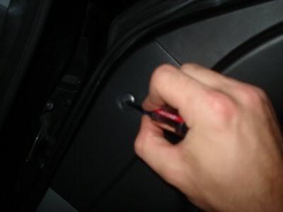

    2. With the same screwdriver push in on the center of the fastener that is on the door panel near the mirror. Then pull it out.

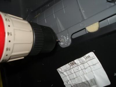

    4. Once the panel is removed, turn it over and look at the back of the arm rest. The arm rest is fastened to the door panel with a series of small melt points. I used a 3/8" drill bit to drill down about 1/4" into the centre of the melt points. Do not drill too far because you will need enough plastic to put screws in later. The melt points are like plastic rivets.

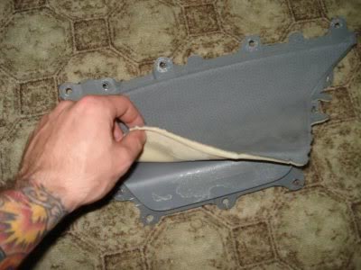

    5. Once the melt point are drilled out you should be able to pry the armrest off. Next remove the old fabric.

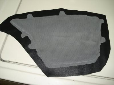

    6. Now cut out a piece of leather slightly larger than the original fabric.
    7. Use a spray adhesive to attach the leather to the arm rest. Then cut off the excess.

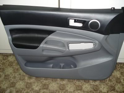

    9. Then all you have to do is put the door panel back in your truck the opposite way you took it out. Here is a finished picture.
    Any questions, just ask. Hope this helps.
