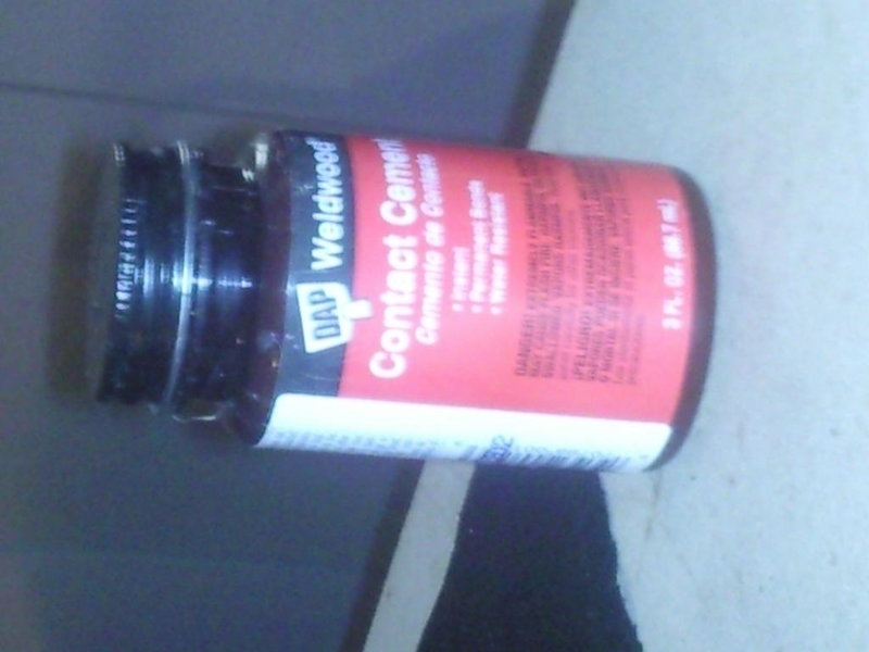

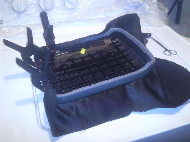

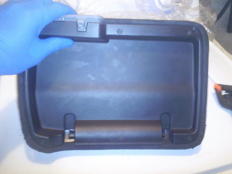

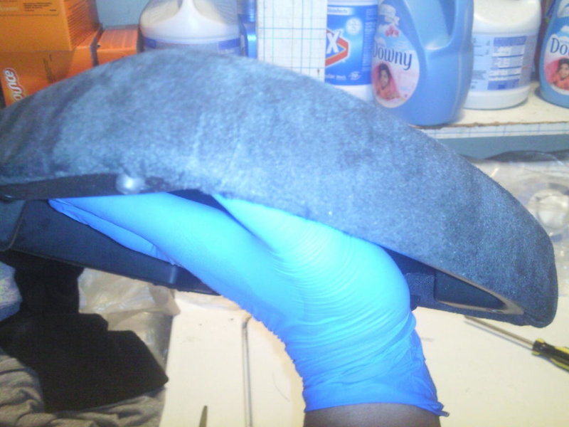

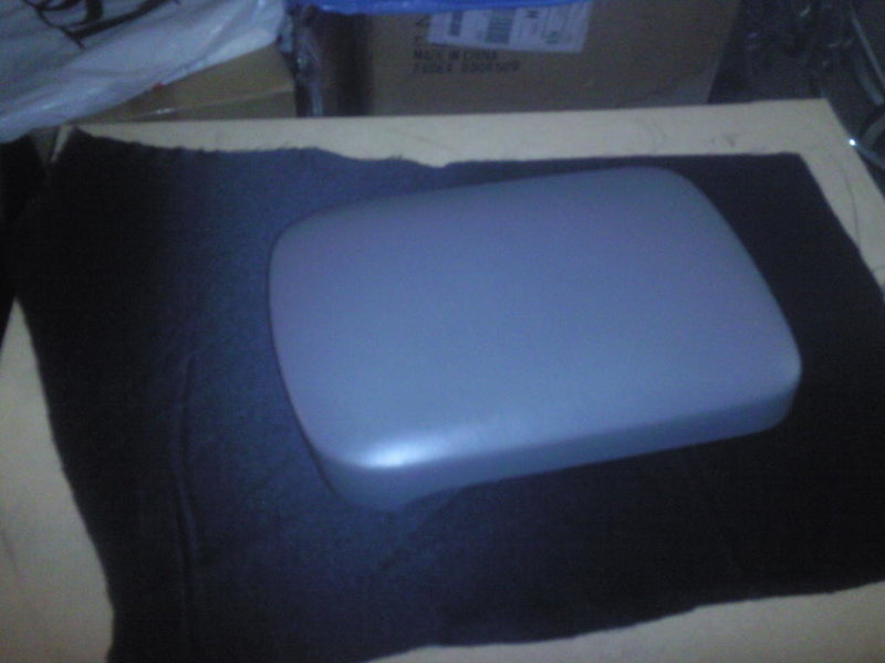

    so I finally got my fabric and some contact cement. trying to figure out how to wrap the fabric on the center console cover ... it's proving to be very complicated :/ Anyone know how to make the wrapping seamless? I can only figure out how to wrap it on opposing sides, when I get to the side where it needs to bend or what not .... it looks like complete SHIET! plz help!!!

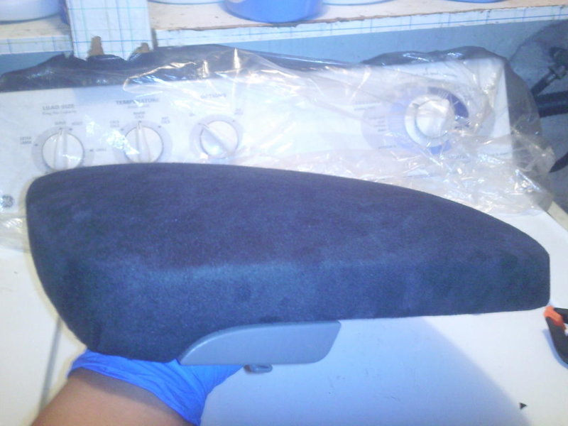

    well it was HELL the first two tries. but I guess third times a charm lol. FINALLY got done with the console cover. Decided to let it be till the morning (when my temper was at it's norm), and give it one more try before throwing in the towel to get it done by someone.
    Still have A LOT of fabric felt (1 yd. is PLENTY to do your door panels as well as center console - given that you have an AC).

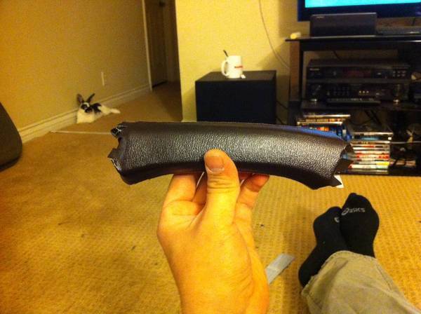

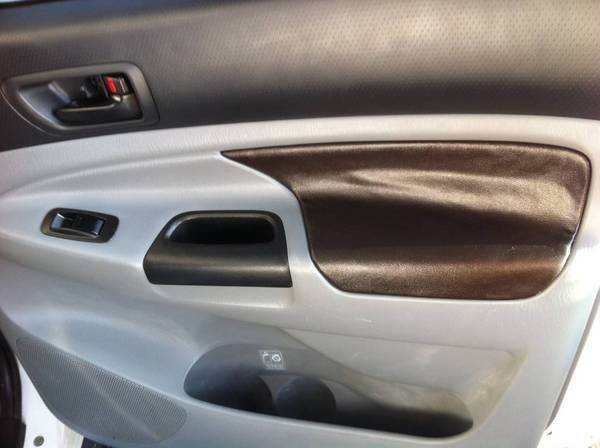

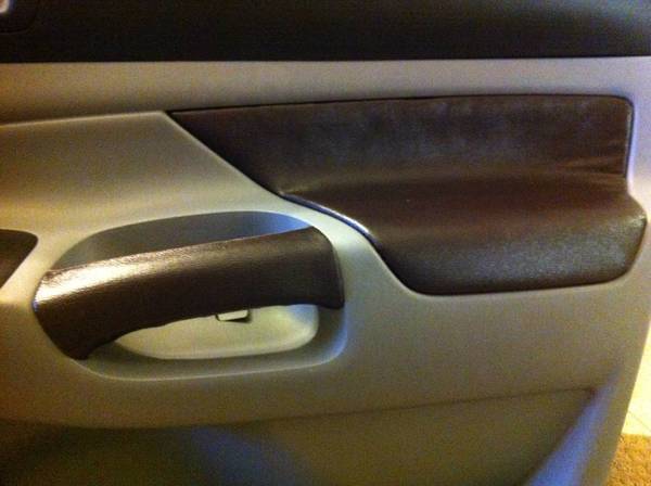

    Just completed my doors. A few wrinkles but overall I am very pleased with them. While the doors were off, I decided to plastidip my rear passenger handles, the housing for the power windows, and the running boards. I went with a chocolate brown vinyl and added some foam for cushion.
    I had my gf work on sewing some vinyl and wrapping the front door handles. They were a pain!
    Maybe we tackle the center console next... :)
    Be careful when reinstalling the panels if you decided to just solder the plastic back over the meltpoints. I had a few spots come apart as soon as I reinstalled the panel so I just remelted the points but also added the #10 sheet panel screws with 2 washers to make sure it didnt happen again... Also, when reinstalling the small triangular panels that go above the doors in the front and the long rectangular ones in the back, remove the small white clips from the door and attach them to the small panel first! This will prevent any chance of the clips falling into your door! I lost one in the front and two in the back before I finally learned.
    Vinyl Handles:
    rear passenger plastidip housing and handle
    running boards:
