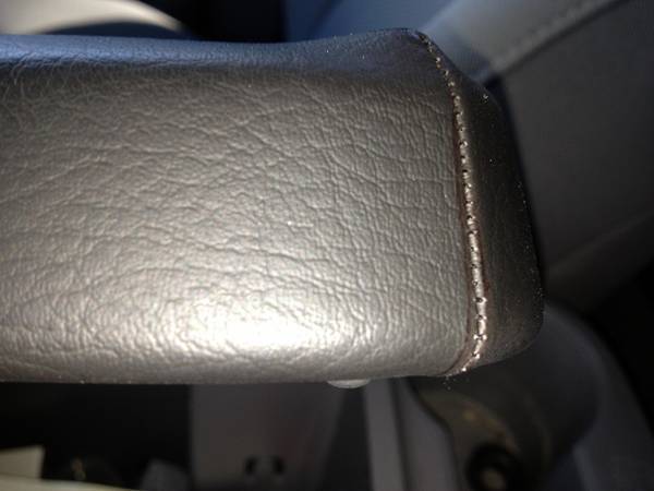

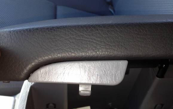

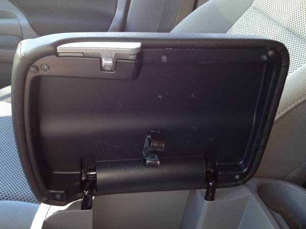

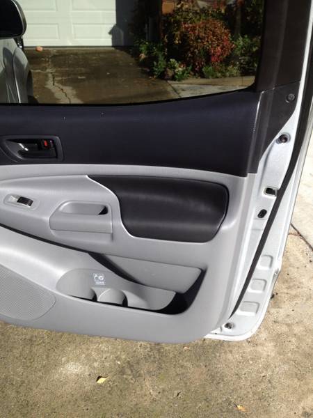

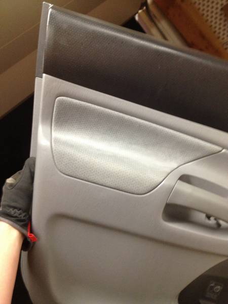

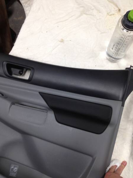

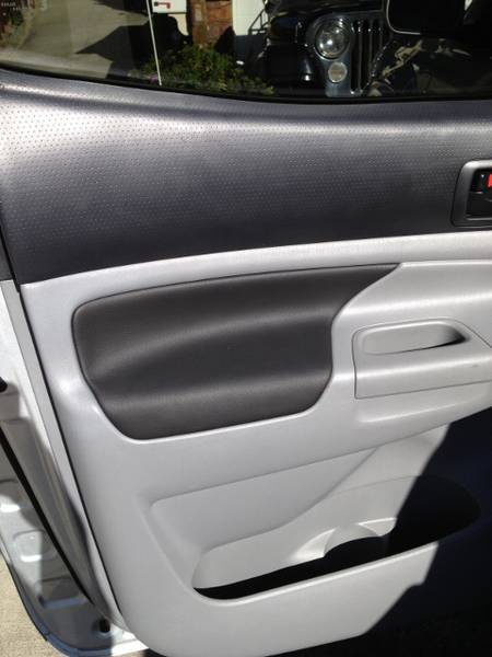

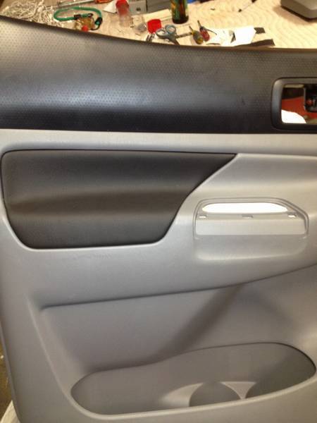

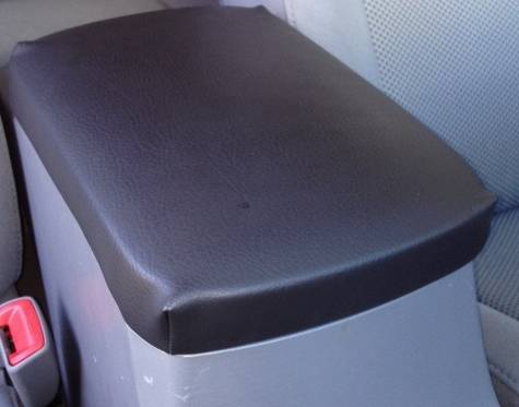

    Before:
    During:
    Installed:
    Center Console:
    Bottom:
    Latch:
    Rear Seam:
    I used Joann's Vinyl, it's basically a matte black. I would have preferred leather, but the vinyl was really inexpensive at around $20.00 with tax for a yard. It was more than enough to do all 4 doors and the center console.
    The vinyl is very thin, and I, against the advice in this thread, used the adhesive directly onto the original cloth. If I hadn't done this, the armrests would have no padding at all. They've been on since November and I haven't had any separation on any of the arm rests. I did have extra long flaps going around the back and adhered to the plastic. I strongly suggest using the 3M 90 high strength adhesive. Note: Make sure you use a light coat on both the new wrap and the panel. It's very easy to think you need a lot of adhesive... you don't, and it's actually detrimental to use too much.

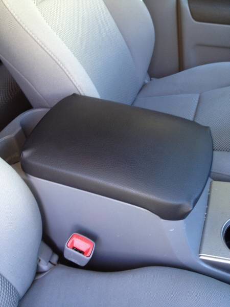

    As far as the console cover is concerned, my main goal was to use little to no adhesive on the original rubbery console covering. I have a friend who has worked for Rolls-Royce and Tesla in their interior design and upholstery departments. He was the one who "designed" the console cover. As you can see, it is not perfect - by any means. In his words, a console cover like this would normally take a few hundred re-designs to get it perfect (by RR standards at least). We did this on a Saturday night in a few hours, using masking tape, sharpies, $20 worth of vinyl, and a sewing machine from the early 90's.
    The one you see on the truck is the second attempt. It has some peaking at the seams, but the pictures make it seem much more pronounced than it actually is. This console cover could be made by any one who's got a sewing machine (and knows how to use it), for far cheaper than any covers I've seen online.
    Good luck!

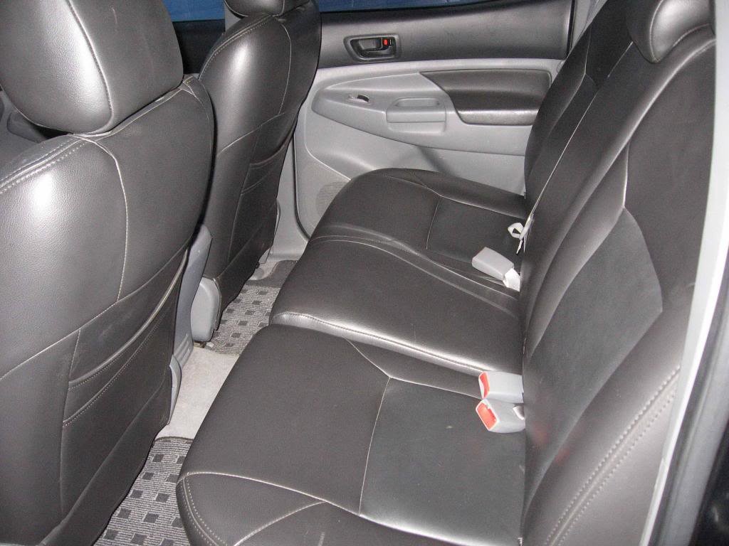

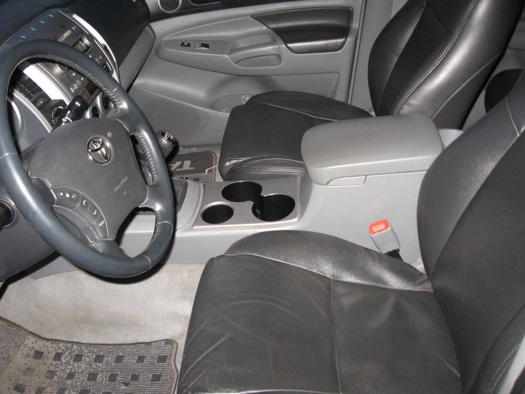

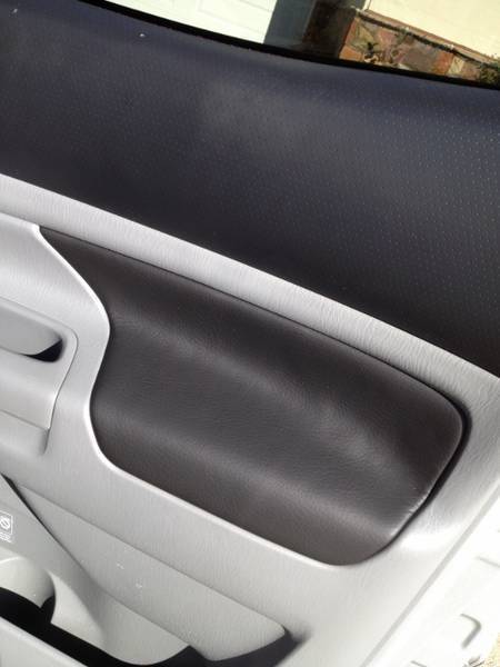

    Great sticky...here are pics of the OEM version (2007 Canadian Taco with factory leather heated seats):
