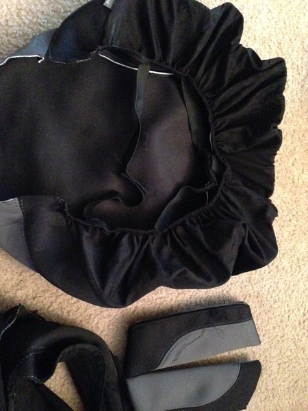

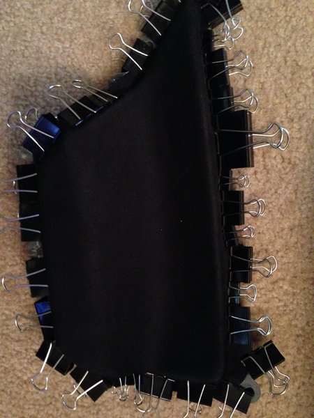

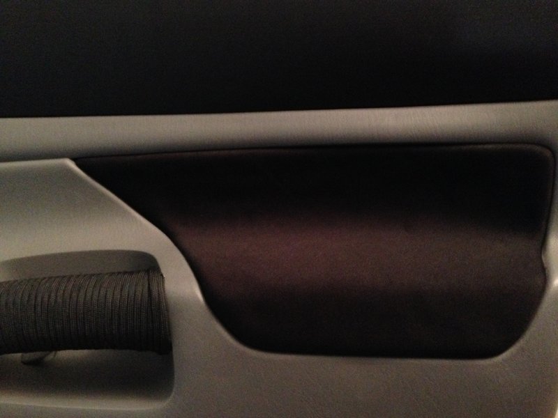

    Hello everyone:
    I did this repair with leather a few years ago when my armrest cracked. It held up well, but with the heat and time it cracked again so I had to redo the repair and have some updated information. Since I had the screw mod done previously it went pretty quick, but this thread was a great reference since it had been a few years.
    I happened to be at Costco a couple of days ago and saw that they had a pair of neoprene seat covers for $15.99. the colors were black and grey which matched my Wet Okle seat covers so for $16 bucks, why not redo the repair with neoprene. I purchased two additional items, Liquid nails silicone adhesive and JB weld plastic weld epoxy stuff in a syringe thing. The plastic weld was used on the backside to fill in the cracks and sets in 5 mins, so while messy it can be done.
    Then I cut up the seat covers and used the silicone to adhere it to the armrest with binder clips to hold it to the edges. I just cut out the whole panel of the seat covers so the neoprene was large and trimmed after affixing it to the armrest. Just make sure you leave enough so that there are no gaps once the armrest is put back in the door. The seat covers are black and grey, I used the back side so it would be black which seemed to match. of course, the passenger side i glued the wrong color out (grey) and had to redo.
    The silicone is squishy so with the neoprene, it is very soft and looks pretty good. the downside is it takes a couple of days for the epoxy to set and a couple more for the silicone, so it is a weekend deal. Pictures of stuff for reference.
