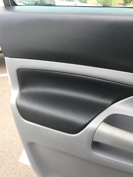

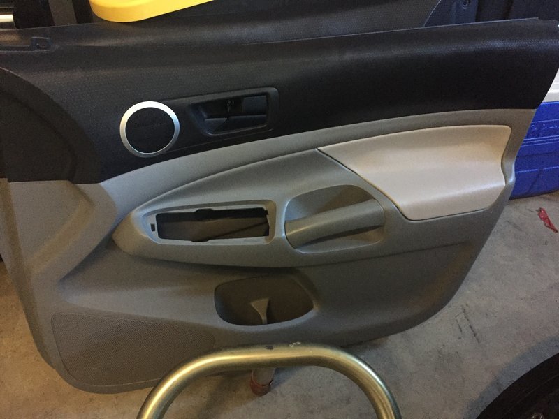

    There is a very thin pad under the fabric.
    You can kinda see it here:

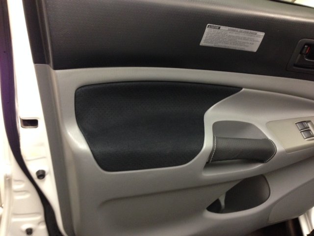

    Did something a little different on mine. Love how they turned out though, awesome write up.

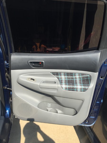

    I did this with vinyl.

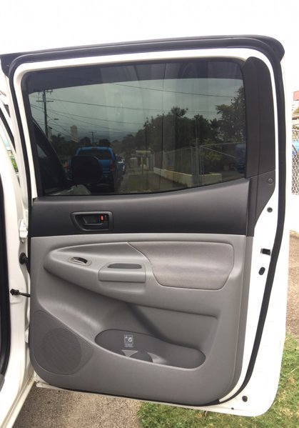

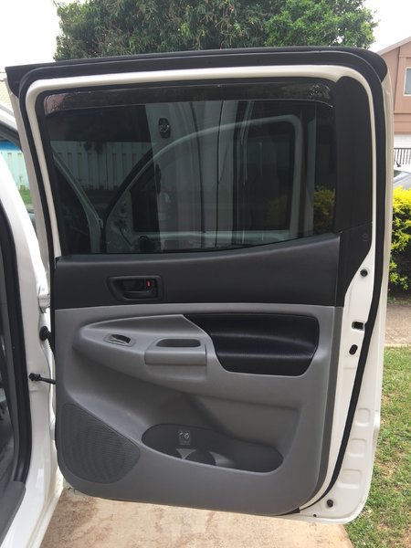

    Finally got the chance to install these! Layed it over the old fabric for some added comfort, turned out pretty cherry!
    Instead of a dremel i Used a switch blade to remove those plastic rivets, worked out very well :thumbsup:
    Before:IMG_0324.PNG.jpg After:IMG_0319.jpgIMG_0316.jpg IMG_0321.jpg

    Was it hard to get the armrest back on with both layers of fabric? I'm about to do mine and the extra padding would be nice.

    Did mine this morning. Took about 2 hours from start to finish. Super easy and love how they match my leather seats now
