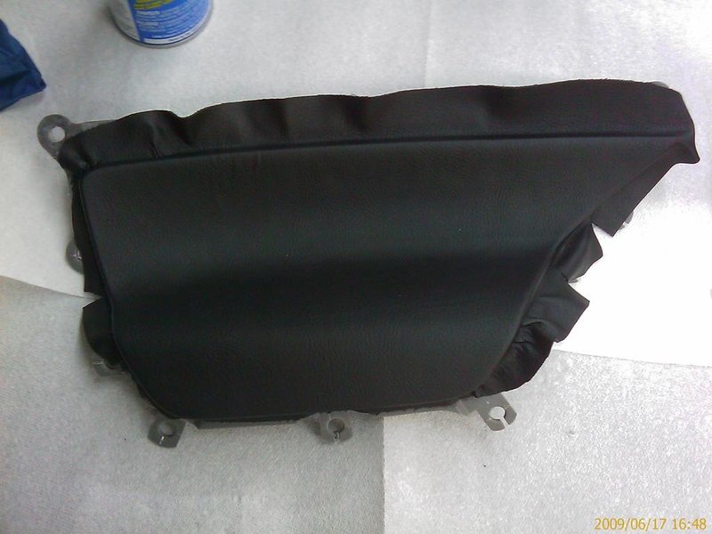

    I did the mod, used Locktite spray and soon as the Florida heat kicked in, major Fail. I took the inserts back out, clean off the spray adhesive and took to an Upholstery shop. They said first of all, the synthetic leather used was not the best choice, that you have to make sure to clean the plastic part with either Zylene of Denatured Alcohol (can't remember which exact one they recommended and/or used) to remove any existing oils, and a contact cement type glue is best. Removing the oils is key b/c when the heat picks up, the plastic will release the oils and cause the adhesive to release. I am sure others can agree or correct me on the information, but all I know is that they only charged me $18 per door including real leather (i did the removal and re-installation), and it has been 3 months - 2 of which have provide 100+ degree temps inside the cab during the day - AND they are still holding on perfect after the described method. Again, I am sure I contributed to the original FAIL, but also the extra steps outlined by the upholstery shop can not hurt. Good luck to all.

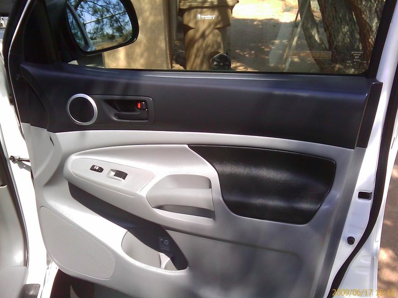

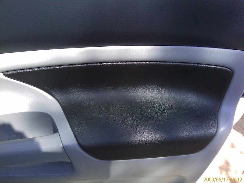

    Thanks for the info tacogator. I ended up doing my doors today. I went to joanns and bought some black vinyl that looks like leather, it was normally 35 bucks for a yard, but they had it on sale for 50% off, and I got a can of all purpose adhesive for 50% off also. I walked out of there only paying 22 bucks which was good in my opinion. I came home and did all the doors, took me a while, but I think they turned out great, now I will just see if they hold up over time. If they dont then I will just bring them to a upholstery shop like you did and have them do mine in leather.

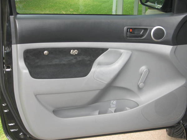

    Look up Tandy Leather. There are several in your area I believe. You will need about two square feet. I went with some fairly heavy leather as the real thin stuff just didn't feel right, I think mine is about a 6oz.

    They are conchos that you can pick up at the leather store, they just have a stud on the back that you can screw into. I wanted something different. It looked really plain so I figured I would dress it up. I also took a thick foam floor mat that my wife had and used it as cusion to add a little padding. If you are going to do this mod I suggest using rubber cement. The 3M works but the rubber cement holds better and if you screw up or change your mind it just rubs off.
