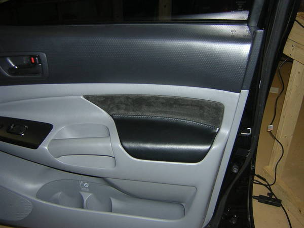

    I really like the look of that man! Good job

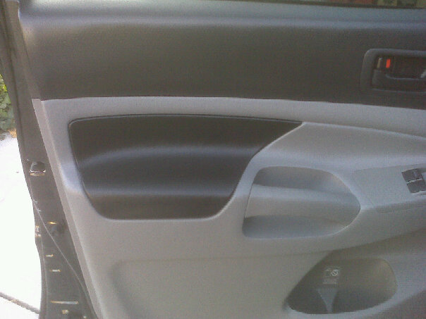

    Guys & Gals..... the dremmel is the way to go. Forget about drilling. Use the dremmel to sand and melt the plastic weld points off. After sanding for a few seconds, while the plastic is still warm, pull up on the tabs carefully and they will come apart and leave perfect holes for the screws. When you are ready to put everything back, use a cordless screwdriver to drive in the screws. BTW, I used Wet Okole Neoprene
