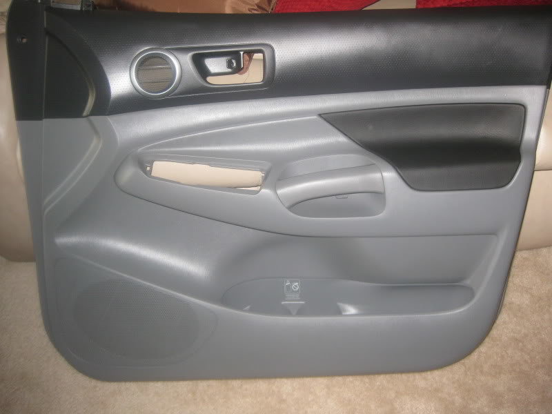

    Does anyone have any suggestions on finding a replacement elbow panel? Mine is cracked and the whole door panel is $500+. Until finding this thread, I didn't realize they were somewhat removeable. If not, any suggestions on repairing it? It's cracked right down the center. I broke it with my elbow when some jerkoff rearended my truck. Still trying to find a silver tailgate too!

    Just finished mine up this morning, only cost me around $10 for everything...took about an hour total for both front doors, now time for the rears

    I had most the supplies already from my car audio job I had, all I picked up was some cheap fabric ($5/yard) at JoAnn Fabrics and some screws. They had a section of fabric where it must have been precut but nobody bought it so it was like half off. I used an adhesive remover to get all the junk off when I pealed the old fabric off then sprayed both the new fabric and arm rest with a 3M adhesive spray. Been holding up great even with this 90+ weather we have been having lately.

    Has anyone done a perforated leather to maybe give a closer match to the black upper portion of the panel? If so, pics?
    Also, can someone post a pic of the door w/ the panel removed?
