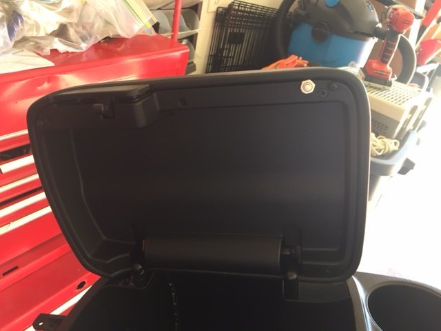

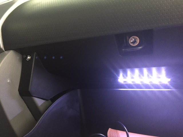

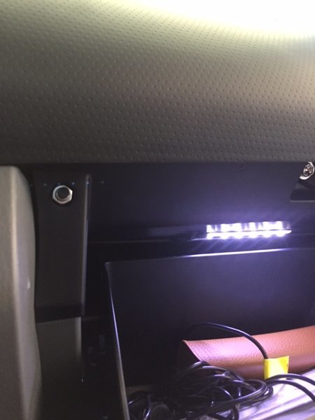

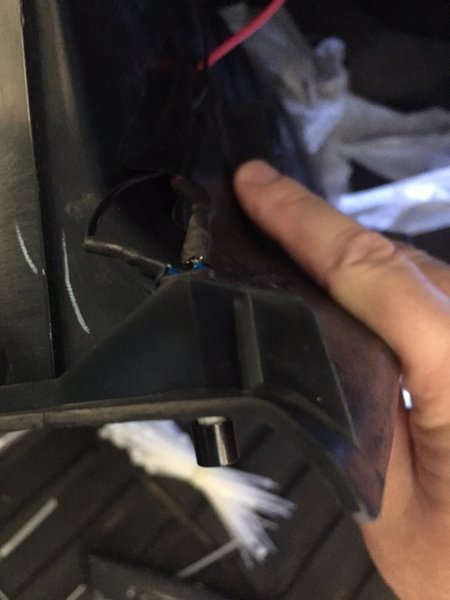

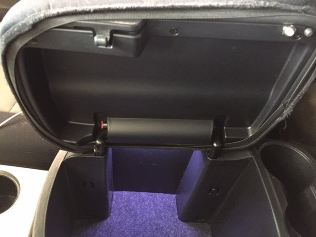

    Finally took the recommendations in this forum and installed mine...glovebox with momentary switch and LED strip, then moved on to the Center Console compartment. Worked out quite well, took some time but got through it all. Decided to mount momentary switch in console door to avoid breaking it off accidentally with the swipe of a hand or arm. Cover has plenty of room inside once it is taken apart with a few screws. Had to do some fancy wire routing down the hinge. Everything appears to be out of the way just like I wanted...used a tap to get to the console power from the glovebox power wire and a final Add a Circuit to the dash fuse box to finalize. The mini switches were available at my local Radio Shack and lights are from interior vehicle LED's at Walmart. Worked out quite well with the help of this forum...Thanks guys. Wes.
    Glovebox
    Center Console

    Great job! Just be careful that the wire passing through the hinge if the console lid is routed so it twists when you open and close the lid, and doesn't bend. If it is bending, it won't last long. The wire will break after a few bends.

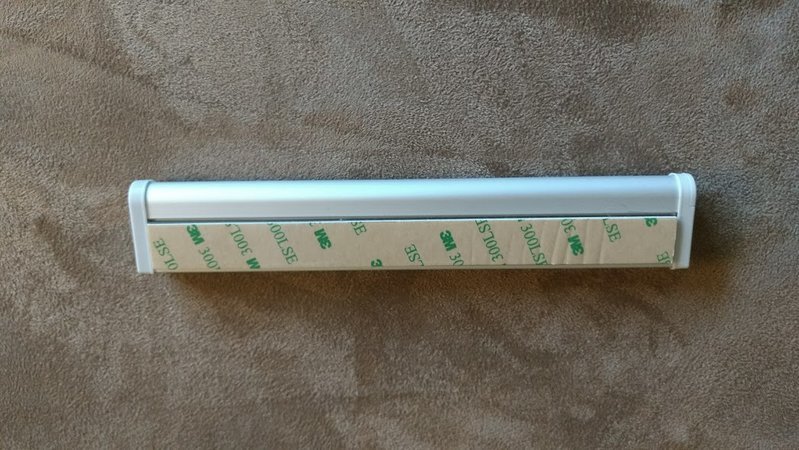

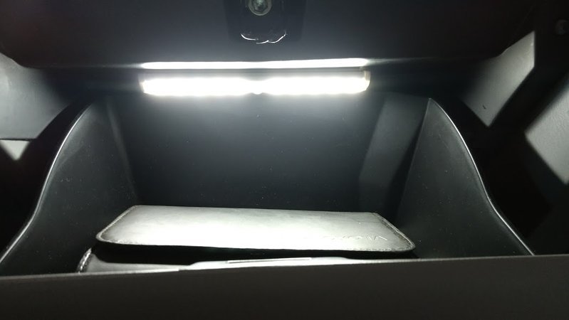

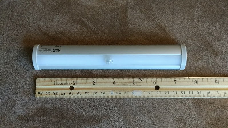

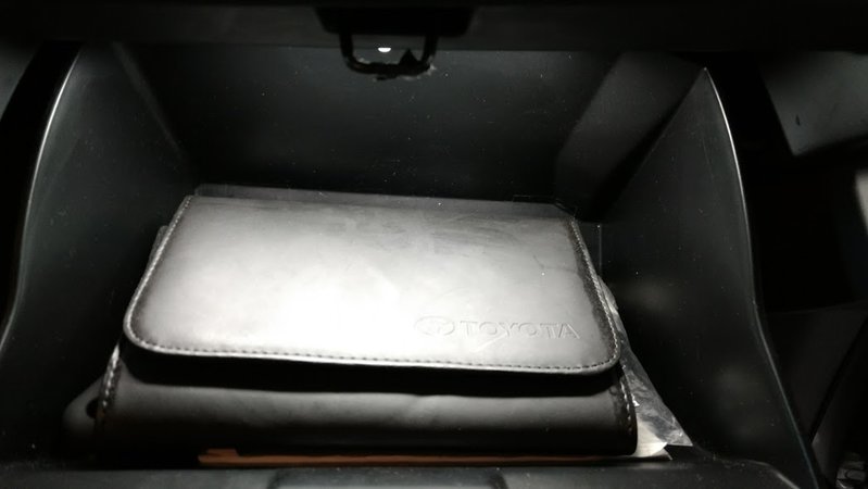

    Here's what I did. I purchased a 3-pack of motion activated LED strips from Amazon.com for about $19.00.
    https://www.amazon.com/gp/product/B010Y1U1JO/ref=oh_aui_detailpage_o05_s00?ie=UTF8&psc=1
    As the picture shows, they are about 7" long. The back has a self-adhesive magnetic strip. I put four AAA alkaline batteries in, removed the backing, stuck the magnet to the roof of the glove box, stuck the light to it, and voila. When I open the glove box the light comes on. Close it, the light goes off. So far, the lights have been working with the original batteries going on two years now. Cost to light my glove box... $6.34. No wires, no switches, no hassle. The other two lights are in my center console, and my Lear cap. Open the hatch, light comes on. These also work well under the hood, but instead of using the enclosed magnets, I used heavy duty Velcro. With the magnet mount, slamming the hood caused it to fall off. Lucky for me it ended up on the garage floor.
