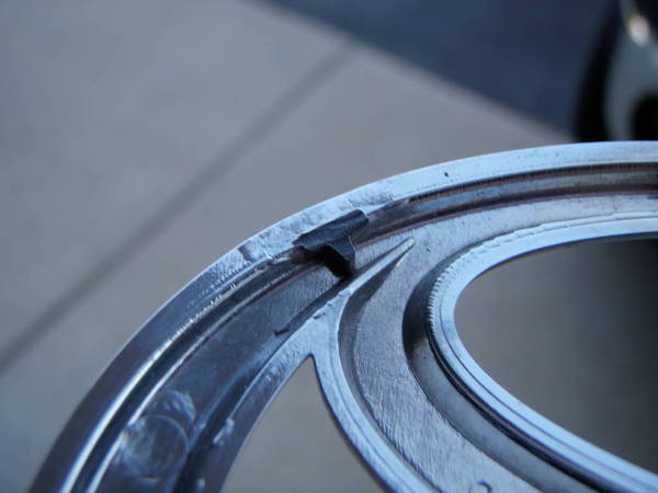

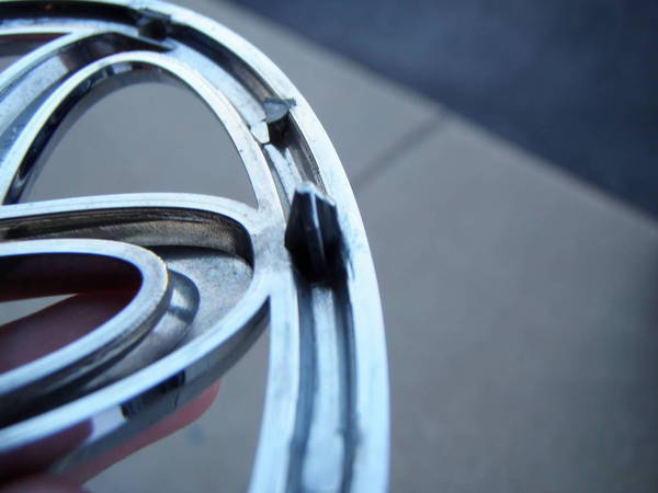

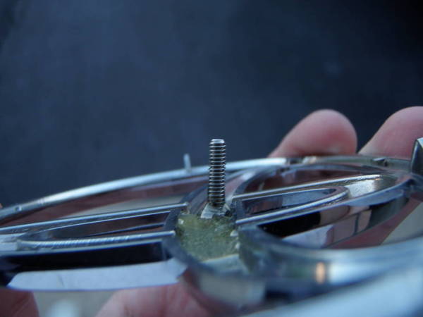

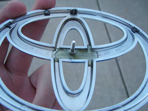

    Things you will need:
    #4-40-3/4 Bolt
    #4-40 Nut
    Small washer
    Epoxy
    Dremel or equivalent

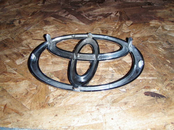

    1. Take your emblem and cut off the tabs in the upper left and right.
    2. Then trim the upper part of the upper tab.
    3. Place the emblem on the grill to mark where to epoxy the bolt.
    4. Epoxy bolt on mark.
    5. Wait intill cured, then install emblem!!!!

    even without the bolt it fits in there pretty snug.
