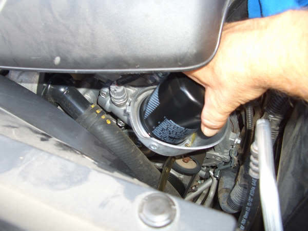

    Oil filter on the second gens is on the top of the engine on the driver side:

    Wow what an odd place to put one. Guess it would be a good idea to make sure whatever filter you buy has an anti-drainback valve (flap) in it.
