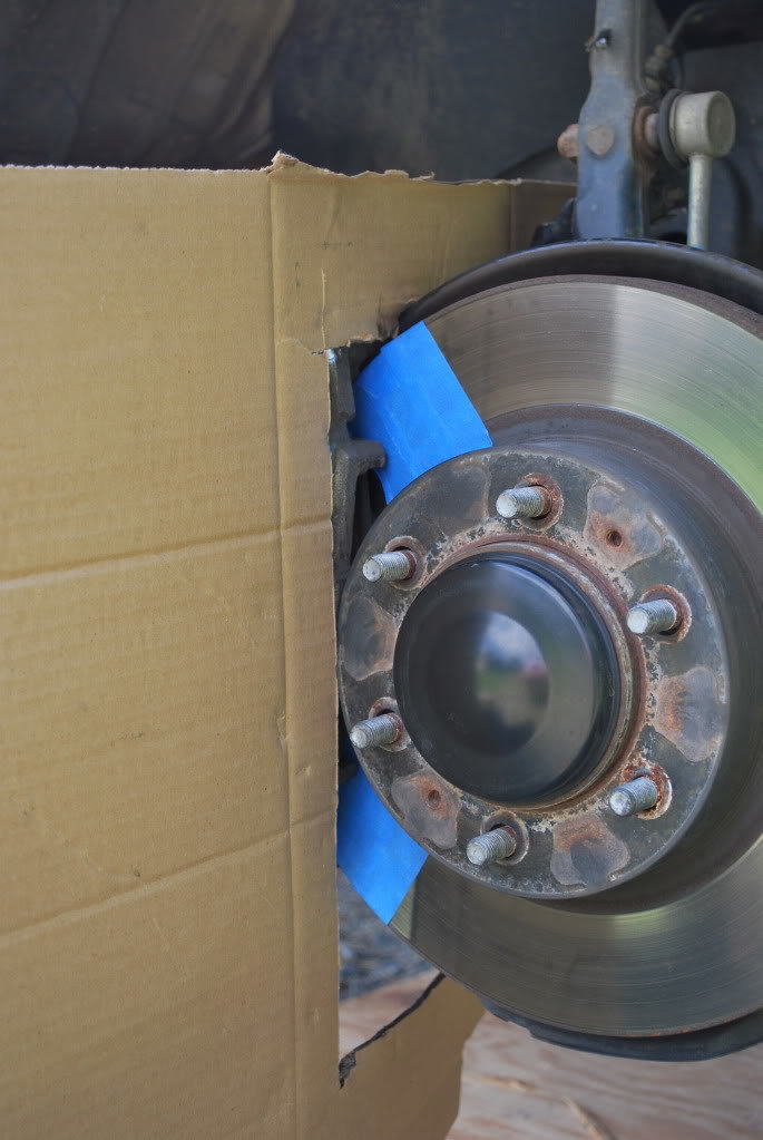

    Use the spray cleaner that comes in the kit and a plastic brush or toothbrush to scrap all the dirt away. Mine definitely wasn't perfect. You just want to get all the stuff off that would make the paint flake off. I spent probably 20 minutes scrubbing each side.
    Forth:

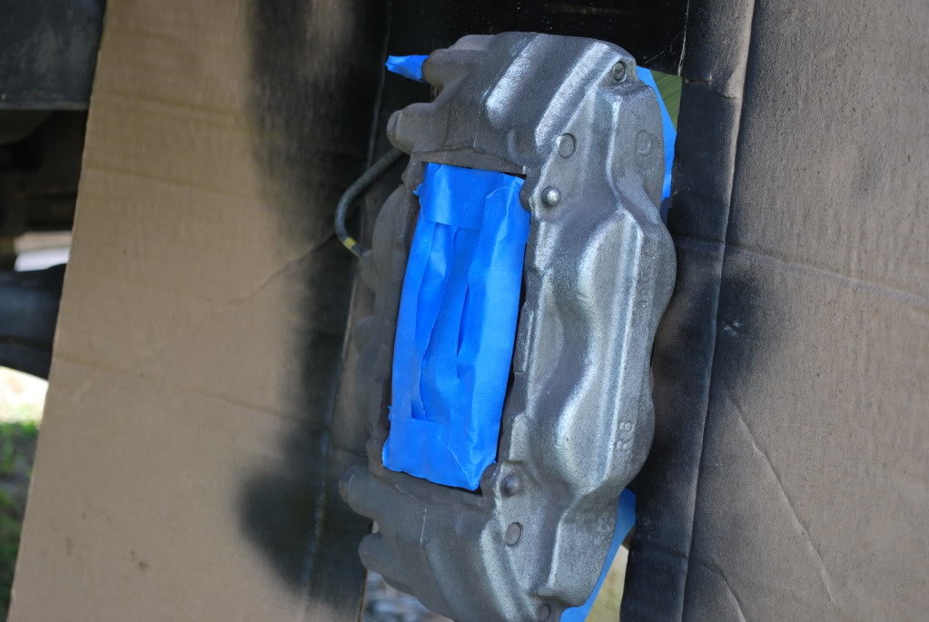

    Tape off the part the caliper covers and the part that could get paint on the rotors. Also cut out some cardboard to place around the outside.
    Fifth:

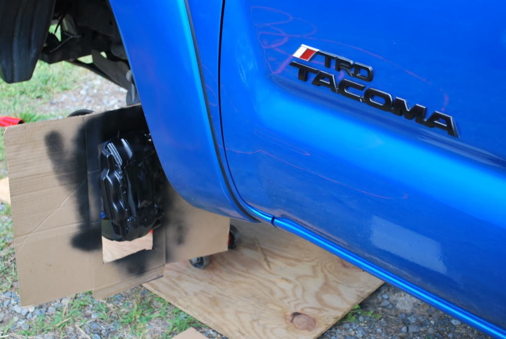

    Paint it up. Following the directions. The spray can was basically wait 10 minutes between each coat.

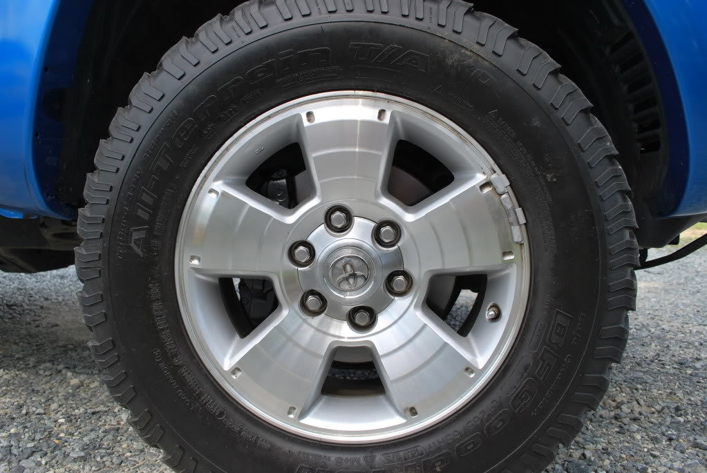

    Put the wheel back on and hope you didn't screw it up.
