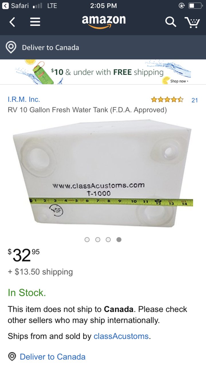

    Another option would just be some sort of resevoir. And a cordless or 12volt pressure pump hooked up to the outlet and a sprayer. Could potentially make it as big or small as you want.

    I made something very similar to yours, two something's to be specific, and so far after over a year using at least one of them regularly I can say they work awesome. For anyone going through the trouble of building a custom tank like these go as big as possible. Mine are 8-9 gallons each and I wish I had more.

    It isn't metal and I don't see those exact dimensions, but this place could build something if anyone can.

    Get whatever size you want!! The price on these is great. I would check to see if the tanks are food grade..
    https://www.amazon.com/s/ref=nb_sb_...prefix=northstar+s,aps,217&crid=2BFXU20UEA33T
    Probably ok but still good to check if you want to drink the H2O.
    I got the waterport. I don't need that much capacity. Just enough to water the dog after running in the heat and the waterport sure beats hauling around jugs - just for convenience.

    Just took a quick look at their website. I can't find the height of tank that I'm looking for, so I'd probably have to get a quote on a custom one....wonder how much that would cost to set up the tooling and build a new one. They have a form to fill out, but I might call them first to see what the ballpark price is.
