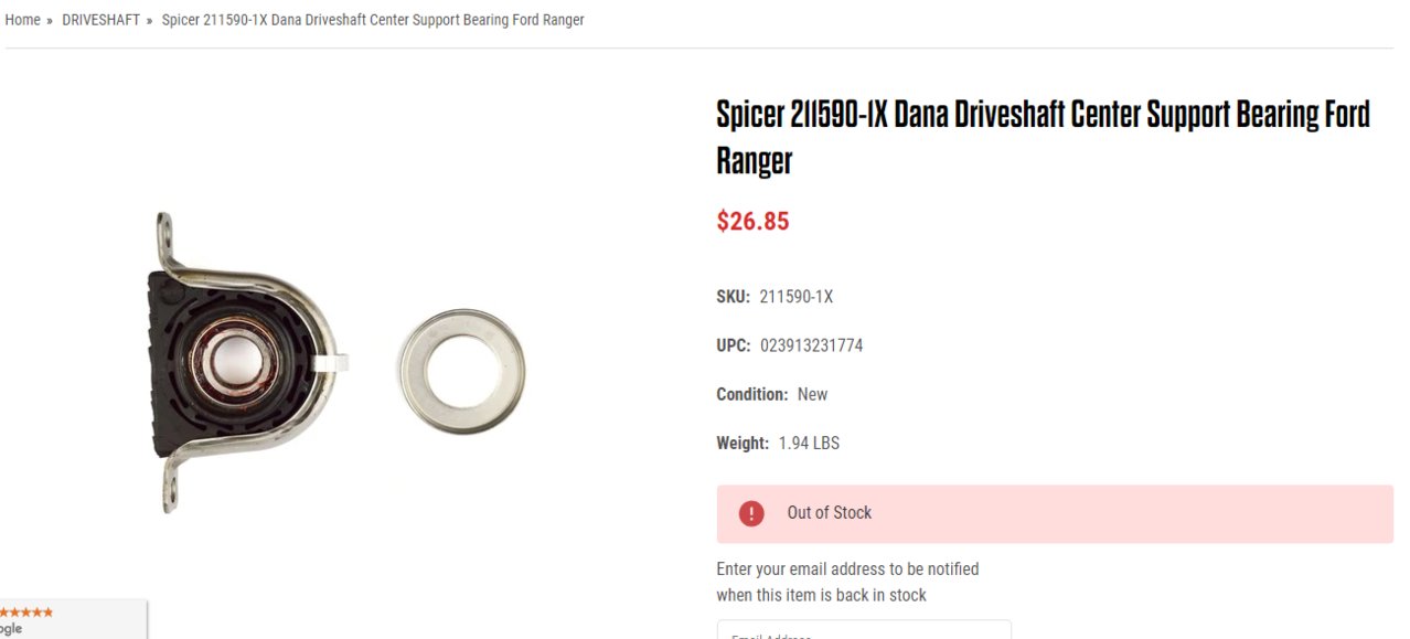

    UPDATE: We went out of town for a 4 day weekend so I took the chance to pump my CB with the 3M Window Weld.
    Results are poor. The window weld actually worked great, pretty stiff but with appropriate amount of give, IMO. The problem I encountered is my CB donut is now deformed again. Even with unbolting the CB and centering it the best I could while the window weld cured, it ended up solidifying in a cock-eyed position and it's not straight.
    I would definitely recommend pumping the CB full BEFORE ever installing it.
    New route I'm going is the Spicer 211590-1x CB and modifying it to fit. I'm so very annoyed.

    That’s the carrier bearing I run.
    Works perfect

    so, from what I understand... this bearing is NOT a sealed unit, and requires the use of a dust cover. However, Ive heard that you can't run it with the dust cover as it will rub and cause issues. So, do you really think that an open bearing is going to last that long? I'm kind of curious. I would imagine after a harsh, salty winter especially, that this thing would be toast pretty fast.

    It is fully sealed and you do not use the cover

    I couldve swore that when this was discussed in other posts, it was stated it was not sealed. Even the photo from the spicer site shows the bearing (open) with a dust cover required to keep it clean.

    Yeah I wondered the same, but it is fully sealed. It just has a red grease over the caps.

    shoot, for the price, i may just have to try it out and see how it does. I have been in discussion with the IDELS guys about making a direct bolt up replacement for ours. Unfortunately, the price would be around 190. They are not sure if there would be enough interest in the tacoma cult to cough up that much cash for a replacement bearing.

    After the failed 3M Window Weld attempt, I went about installing this new Spicer unit this weekend, still need to pull it and paint it but results are good, I have a slight, slight stutter at 10-15 MPH but it's so much better than the stock units were. My setup, with a 2"-2.5" lift is just under a 2" drop spacers to make this setup work. I used 1"x1" square tube, some 1/4" flat bar stock and two 90mm long, M10 x 1.25 pitch class 10.9 metric bolts.
