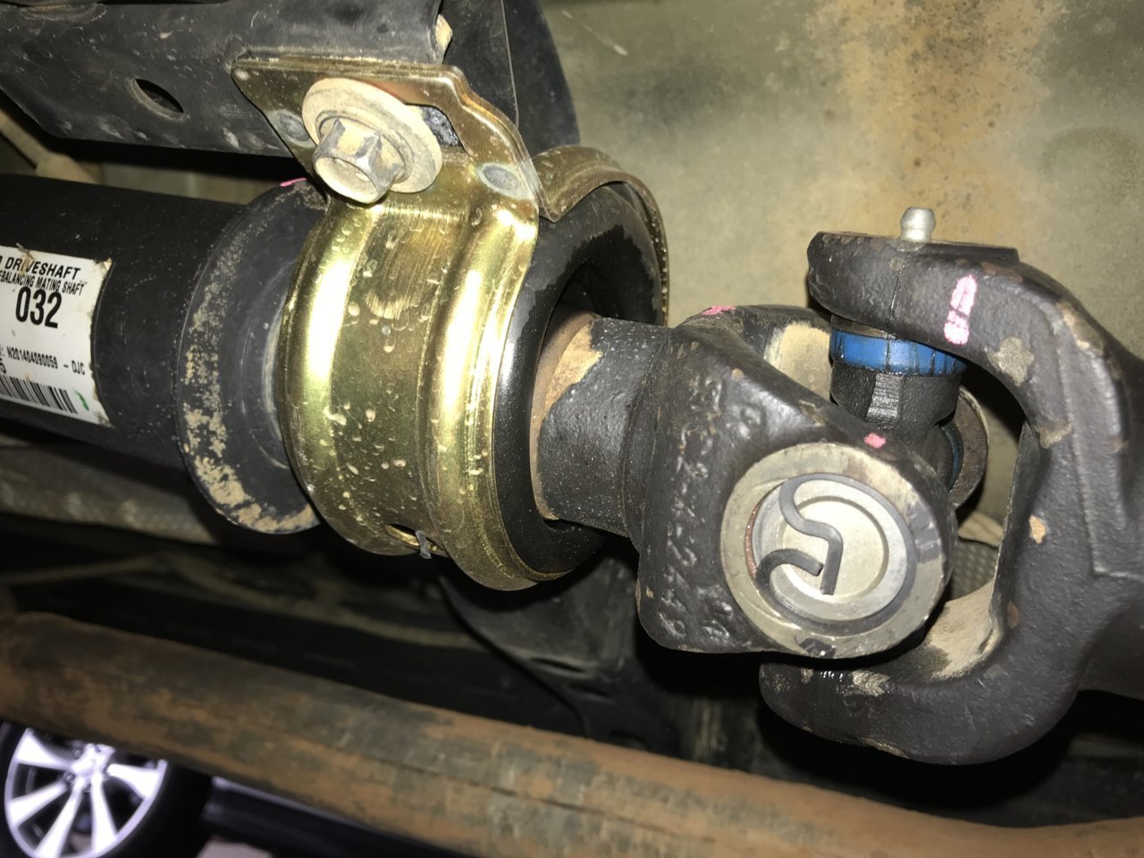

    Is there supposed be play in the shaft after you installed the new center bearing

  14. Jun 12, 2019 at 2:39 PM
    #54
    BassAckwards
    BassAckwards Well-Known Member
    May 3, 2016
    #186002
    27,953
    2009 Tacoma AWD Turbo 2TR-FE
    Full-time AWD & BorgWarner EFR 6258
    A quarter inch of play is normal. If there is a bunch of slop in it, then that is a problem

  15. Jun 12, 2019 at 2:44 PM
    #55
    Cmcevoy17
    Cmcevoy17 Alabama Tacoma
    Apr 16, 2013
    #102223
    5
    Huntsville, Alabama
    '14 Black TX Baja
    Thanks but I thinking the new bearing is snagging again 9C4271FD-05B5-4FDA-B2B5-1A3EB1B7ABB0.jpg
  16. Jun 12, 2019 at 2:53 PM
    #56
    anthony250f
    anthony250f Well-Known Member
    Feb 18, 2012
    #73066
    16,783
    Anthony
    San Diego, CA
    2008 dcsb trd offroad 4wd
    Doesn’t look good.
    I suggest the spicer xc cattier bearing for the Ford ranger

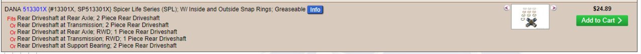

    What year of the ranger? What is the difference between the Tacoma bearing and Ranger Bearing?
  18. Jun 12, 2019 at 3:39 PM
    #58
    anthony250f
    Feb 18, 2012
    #73066
    16,783
    Anthony
    San Diego, CA
    07tacomatoy and BassAckwards like this.

    Yeah thats definitely not good. I recommend going with OEM for all rubber products/seals. OEM(Toyota) will outlast most anything aftermarket
