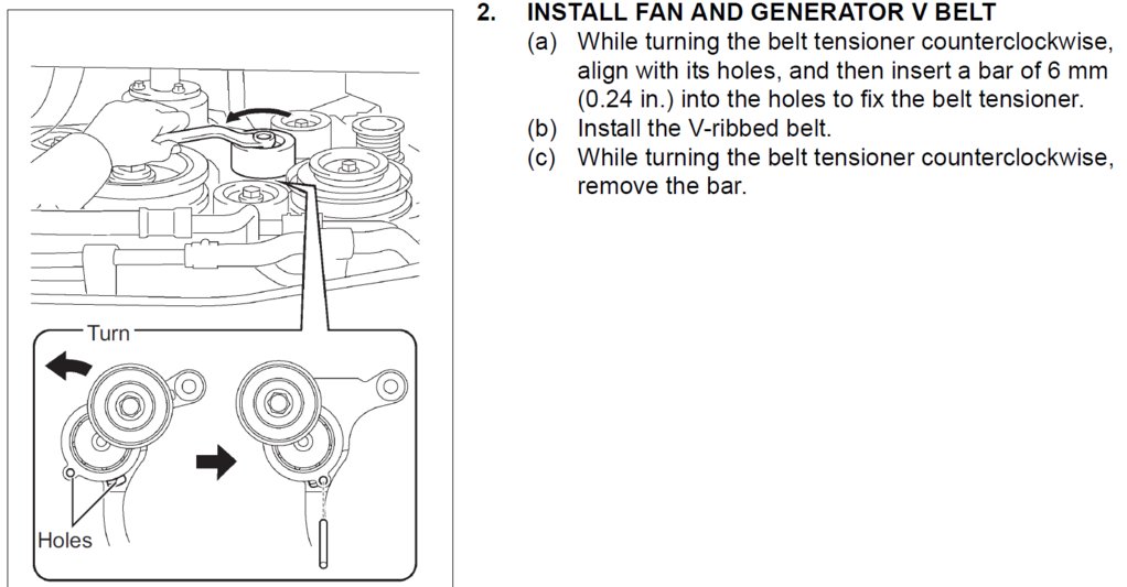

    Could someone point me at what they think is the best video on R/R of the serpentine belt on late 2nd gen 4.0 v6. Things look OK at the moment but like to be prepared for what will need to be done in the future. I already have a new belt in my parts inventory so i am prepared. How to you lock back the tensioner when you do this.

    That was exactly what i was looking for. Thanks.
    Will probably just use a 1/4 inch drill bit for the task.

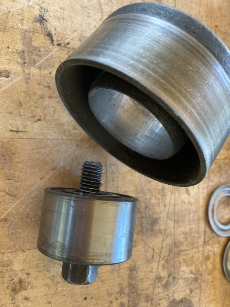

    @thornett I doubt the 36174 sold in the US has different specs from the Canadian one. We have covered this bearing before, that you lose thread engagement with this bearing because the ID is wider than oem, which in my 07 measured 17.5mm wide, not 24. If you had a 24mm wide bearing, maybe it had been replaced.

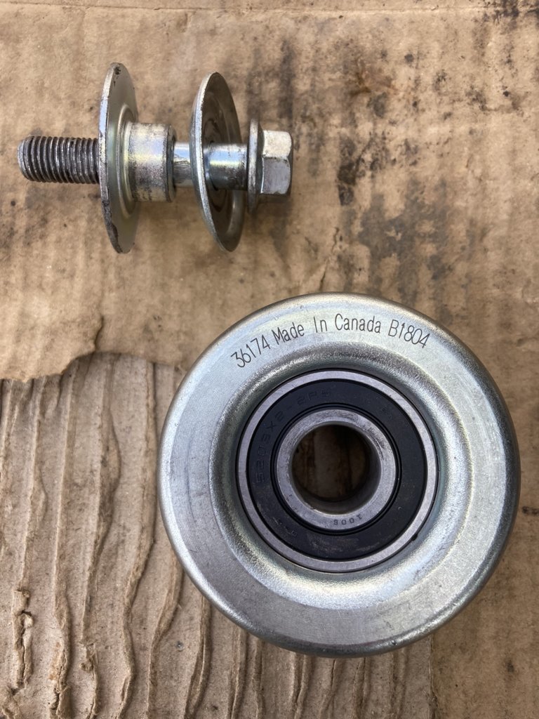

    The bearing that came off my 2007 tacoma is indeed a 24mm deep bearing. Can't say if original to truck since haven't owned since new. I purchased the replacement pulley/bearing mentioned early in post as Febest 0187-GRJ200 and also two 17x40x12mm bearings to hedge my bets if might have to press into the old pulley. The pulley and bearing show up tomorrow. But in going through and replacing all the pulleys whilst doing the air compressor pump the Gates 36174 matches exactly what came off my trucks tensioner assembly and was/is also used in position No1 idler in this image.

    @thornett based on the belt wear on that pulley, it is definitely not oem. The belt wear should be centered. It is working for you but, if my truck, I would change it. The bearing should last a long time. My concern has always been the loss of bolt thread engagement with the wider ID of the bearing.

    Thanks for the help I'll let you know when the Febest 0187-GRJ200 shows tomorrow and all is well again! I also ordered earlier a 17.5mm wide bearing in reading that people were just pressing it into their old pulley. But when tried that approach with the pulley that came off my truck it was clear was never going to work so started wondering what was the issue. Never crossed my mind that it had been swapped out with the somewhat right but wrong pulley.

    The Febest 0187-GRJ200 showed up and the inside diameter of the bearing was correct but the depth of the bearing didn't allow the bolt to fully tighten in the tensioner. So think the tensioner assembly was replaced at some point and it's not oem. Ended up reusing the pulley that was on the tensioner and pressed in two 12mm thick bearings to make up the 24mm bearing required.
