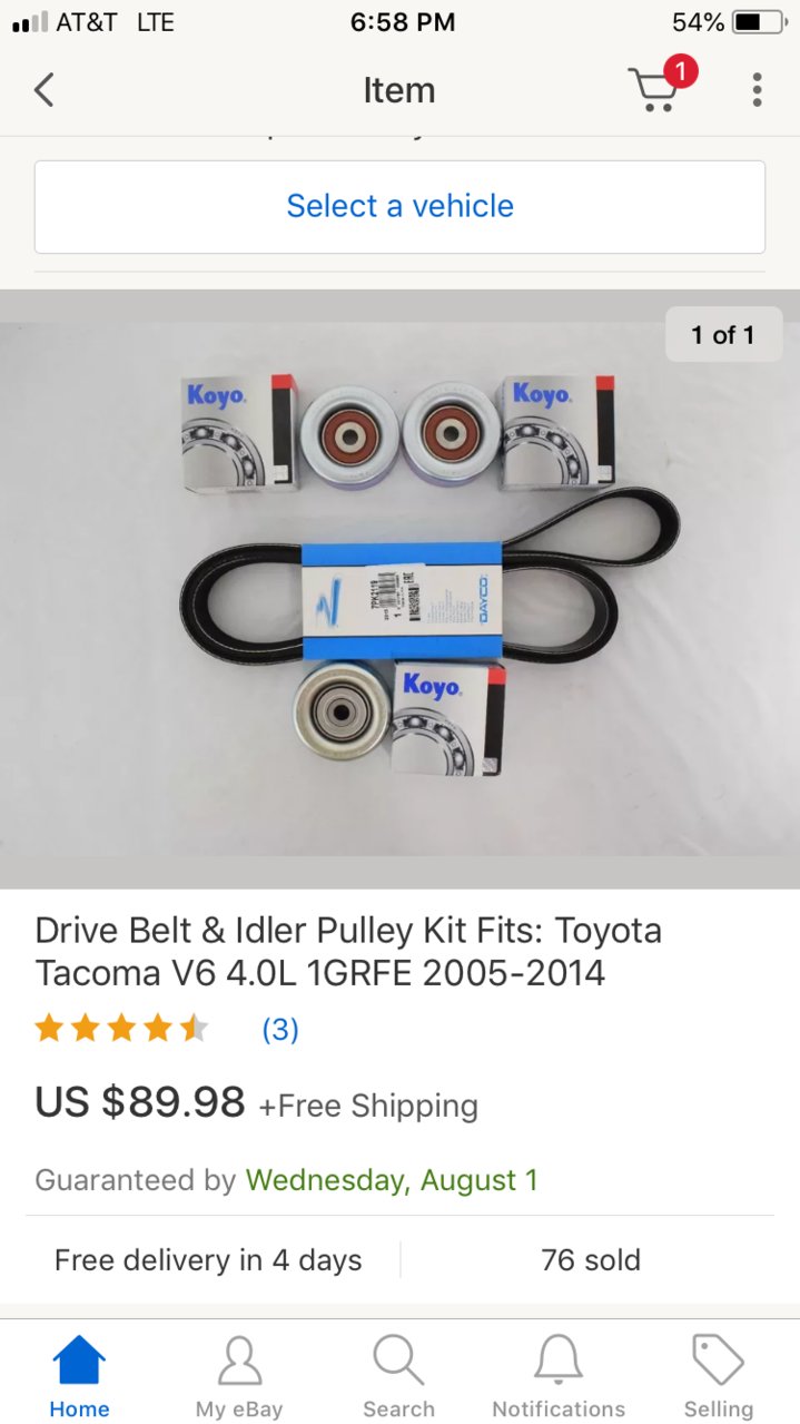

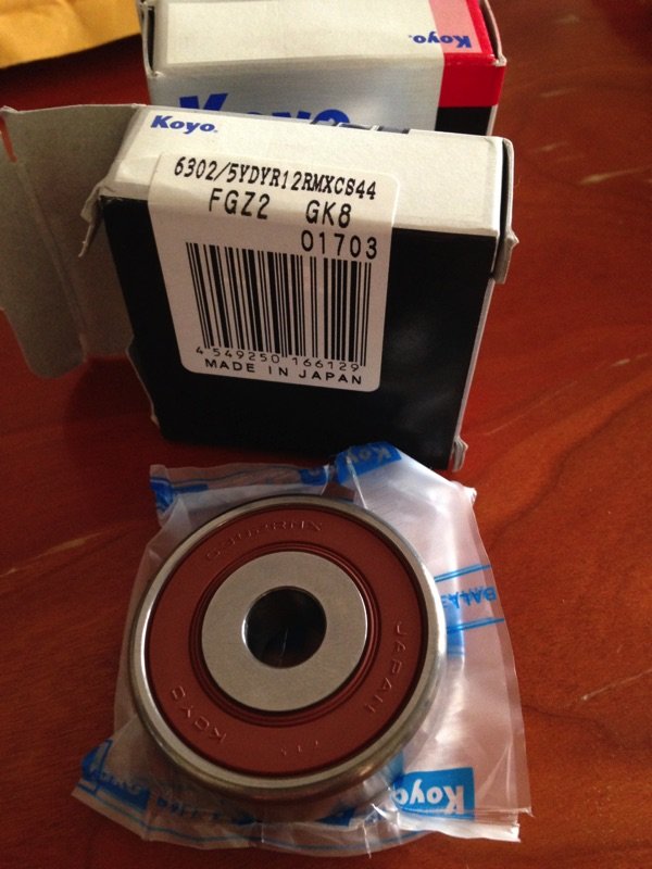

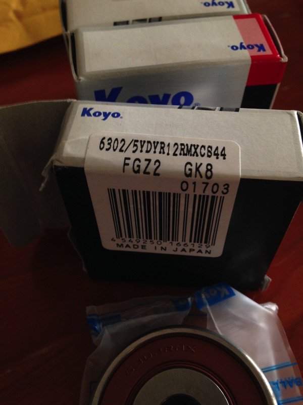

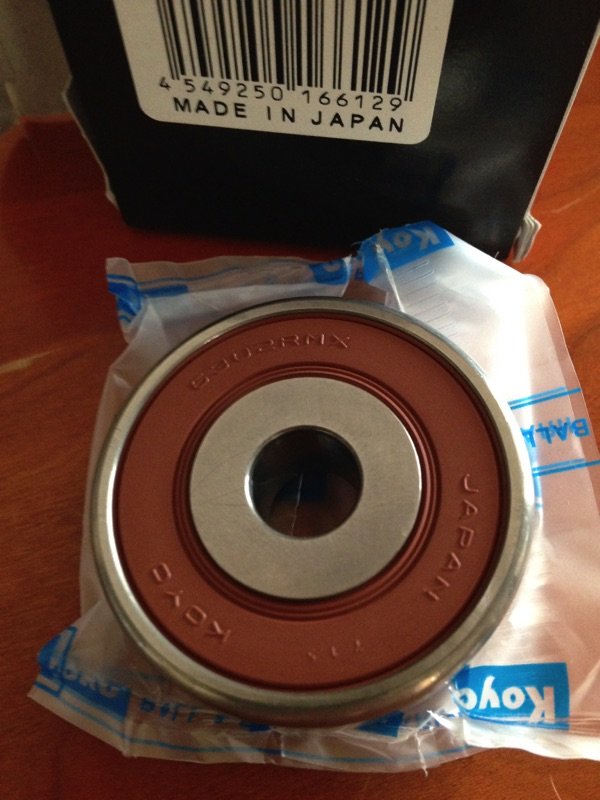

    FWIW, in the process of research came across this excellent thread (Thank you gents!) and eventually found these on eBay. Feel like quality and the packaging is very detailed. If they are trying deceive they expended an awful lot of effort to do so.
    https://www.ebay.com/itm/NEW-Koyo-Red-Seal-Idler-Pulley-Bearing-6302RMX-for-Toyota-Lexus/162780668623?ssPageName=STRK:MEBIDX:IT&_trksid=p2057872.m2749.l2649

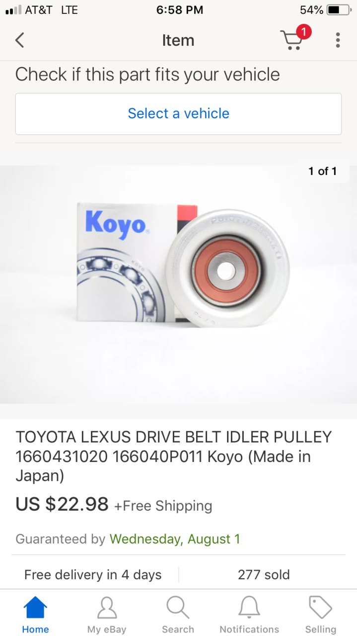

    BTW, these sold in the listing below are probably your knock-offs. Got that same blue scheme packaging from that Chinese site.
    https://www.ebay.com/itm/NEW-Koyo-Red-Seal-Idler-Pulley-Bearing-6302RMX-for-Toyota-Lexus/352168765105?rt=nc&_trkparms=aid=222007&algo=SIM.MBE&ao=2&asc=52885&meid=97b6d0abef1c445d864931194845ae8d&pid=100005&rk=3&rkt=12&sd=162780668623&itm=352168765105&_trksid=p2047675.c100005.m1851

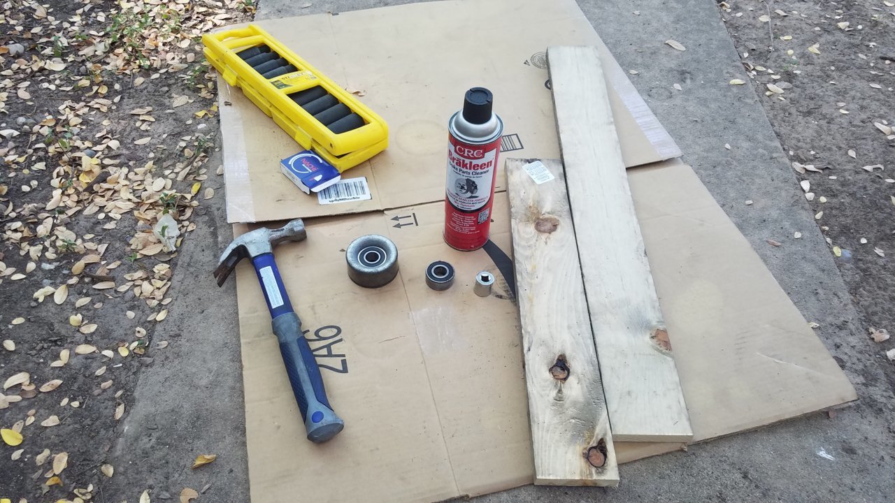

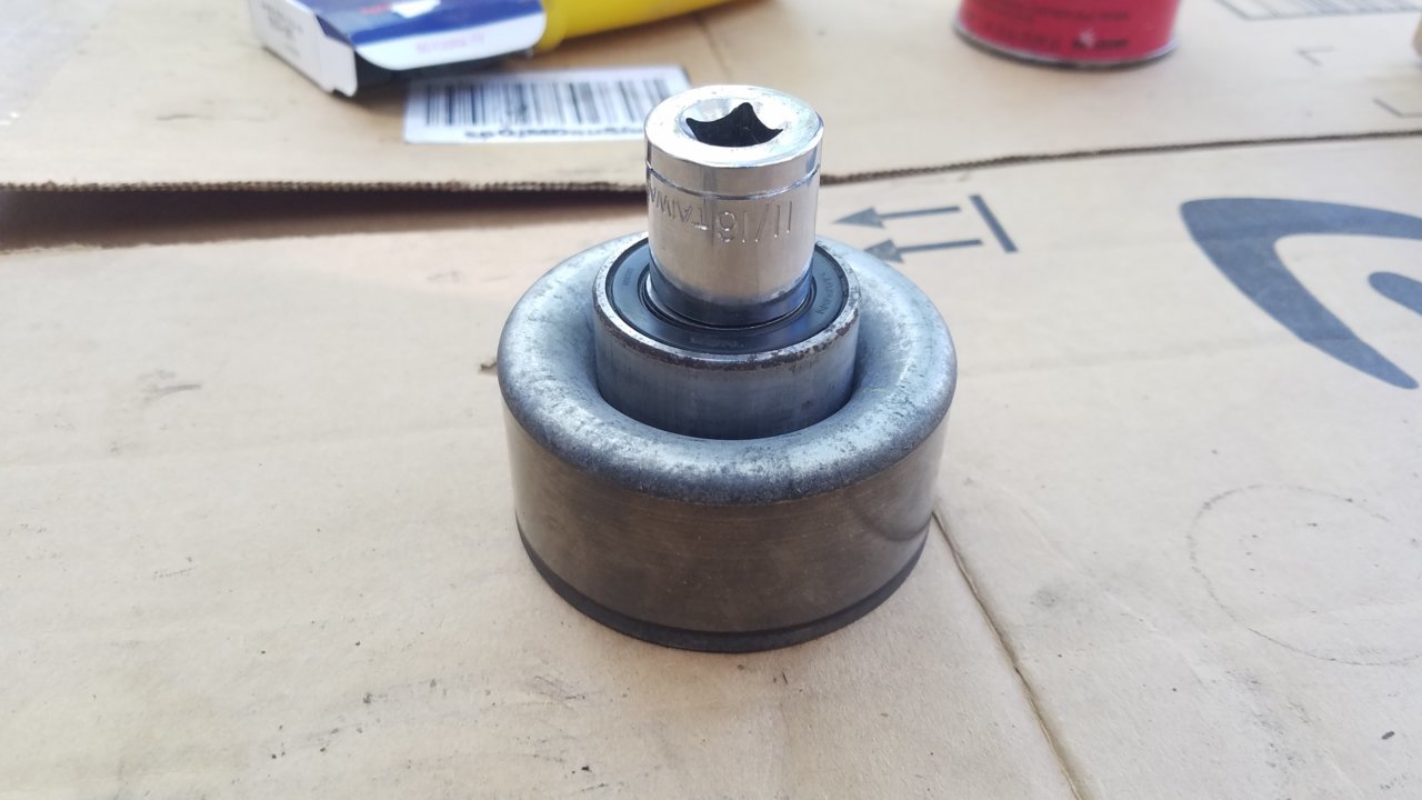

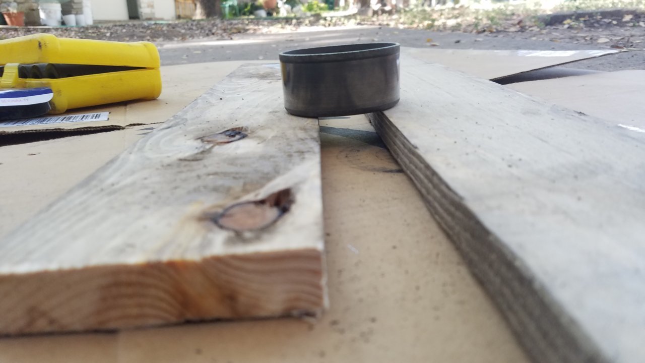

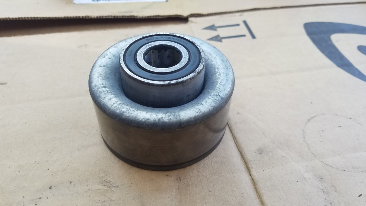

    I wanted to leave my input for swapping out the tensioner bearing. I did this a couple weeks ago. I used a hammer, 11/16ths socket, a piece of cardboard, brake cleaner and 2 pieces of scrap wood (disregard impact sockets, didn't end up needing them).
    The 11/16ths just about perfectly matches the inner race of the bearing. I used an SAE socket because our trucks take metric, so I didn't care if it got messed up.
    Place pulley face down on cardboard - the cardboard helps protect the face of the pulley from getting gouged by the concrete. Metal on concrete = no good. Align the socket to the inner race (the inner race will be the only one showing from the rear). Then whack the aligned socket with hammer. Make sure the socket is aligned after each whack. You will be able to whack the bearing until it becomes flush with the face of the pulley.
    After you've gotten the old bearing flush with the face, place it on top of the 2 pieces of wood, spaced appropriately so that they clear the bearing. Continue whacking with your hammer and aligned socket. Once you get the old bearing free, use brake cleaner and a towel to clean the gunk and build-up out of the pulley shell - since we'll be reusing it.
    Place new bearing in the hole, with old bearing on top. Place socket on inner race of old bearing (see first picture). Then whack new bearing into position. The old bearing's outer race and inner race exactly line up with the new bearing's, ensuring you get uniformly applied pressure. Also, this ensures the new bearing isn't directly hit with the hammer, preventing damage.

    Shouldn't you drive on the outer race not the inner race? That way the force isn't applied to the bearings and then to the outer race?
    dtaco10, ral-fake-scoup and BillsSR5 like this.
  15. Sep 4, 2018 at 10:26 AM
    #35
    BlackBeerd
    BlackBeerd Well-Known Member
    Apr 3, 2016
    #183222
    75
    Michael
    Austin, TX
    2010 Barcelona Red AC 4WD
    When removing the old bearing it's only possible to put force on the inner race. There's a lip from the pulley shell blocking the outer race.
    When installing the new bearing, I didn't have a large enough socket to line up with the outer race, so I used the old bearing as my socket.

    The old bearing yea no problem, if you're doing this then it's probably bad anyways. I'd just hate to see someone ruin their new bearing driving it in from the center. If you're only hitting it on the outside race of the old bearing that should be fine enough, but your pictures would steer people to drive it in the same way you drove it out. Words are harder for some than others.

    @Sandman614 may be referring to this photo, which is confusing since it appears you are driving the bearing into the pulley using the inner race. I think you just had it flipped when you snapped the photo is all. You have it oriented right in the photo with the wood blocks.
    It's acceptable to remove a bearing using the inner race or really any part of the bearing you need to get it to come out if you're not reusing it. As you point out you should only use the outer race to drive in a new bearing. In this case there's no way to remove the bearing safely so it must be replaced any time it's removed due to the stop lip, as you mention.
    I will also mention that you can use a big C-clamp, a long bolt or piece of threaded rod with washers & nuts with your sockets to fashion a hasty press if you don't want to use a hammer to drive them in and out.
