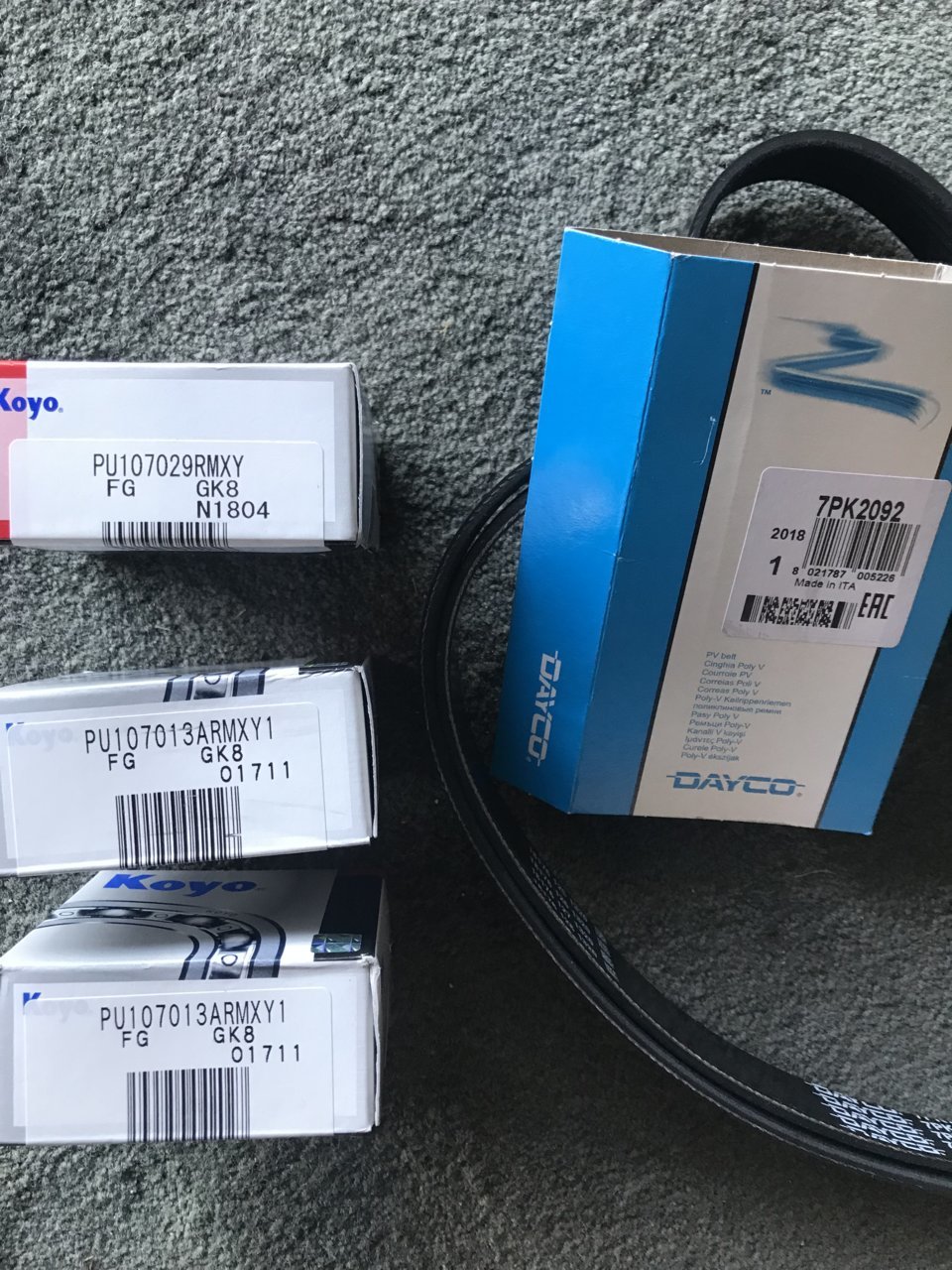

    Thanks for the reply Chuy. The seller show 116 kits were sold. 99.5% positive feedback. Guess I'll be the guinea pig. I will post the results.

    Most beneficial bearing study from a cost saving and quality perspective, thanks. I too am concerned about the knockoff koyo's, interestingly, it is the same seller selling the the "new" toprol as the koyo's on Amazon. I wonder if they changed closure and name in response to questions arising from this thread? haha.
    Trying to jump back and fourth to track stuff you are recommending down right now, need nice consolidated list next time...because I am dumb. What is the ideal OD size of washers you are putting on the back of these things? The SKF 6302-2RS X2 for #1 idler I found on amazon are reportedly made in India, if that matters to anyone, going to give them a shot. I also have concerns about the NSL on #2 pullys because in the nachi catalog they describe nsl as: Exellent at low speed · The grease may leak from the bearing at high speeds and high temperature. · The grease may leak in case of outer ring rotation.
    But i dont know anything about bearings and didn't see a heat or rpm spec, assume they will be ok, figure 150 degrees and 10k rpm. However, wild 10k rpm estimate would be at OD of pully, bearing may be higher, a more ambitious person could figure it out. Attached gene.pdf...Page 4 table 2. But maybe still BETTER than the other options, maybe you can shed some light on this. Anywho, thanks again, alot of fun learning about bearings!

    @lachozaloverboulder
    Good observation on the same vendor.
    The washers I used are 10mm ID; 22mm OD; and 1mm thick. Stainless steel.
    The SKF bearing I received form 123bearing was made in Italy. SKF has manufacturing plants around the world. Presumably, QC should be the same at all the plants.
    The "low speed rating" in the Nachi catalog is in reference to the grease sealing qualities of the rubber seal for NSL and NSE bearings. The bearing I used is 2NSE. There is no graph in the catalog for 2NSE but in the previous page you will notice the 2NSE bearing has an extra seal compared to the NSE bearings. From personal experience, I haven't heard any noises on any of the bearings I installed, but I only have about 15K on them. I emailed Nachi if they can define, by RPM's, what is low and high speed and if the 2NSE bearing would be high speed rated. They do list a temp rating of -25 to 100 C, or -13 to 212 F.
    Edit note, the 2NSE bearing appears rated up to 13K RPM on the Nachi North America website.
