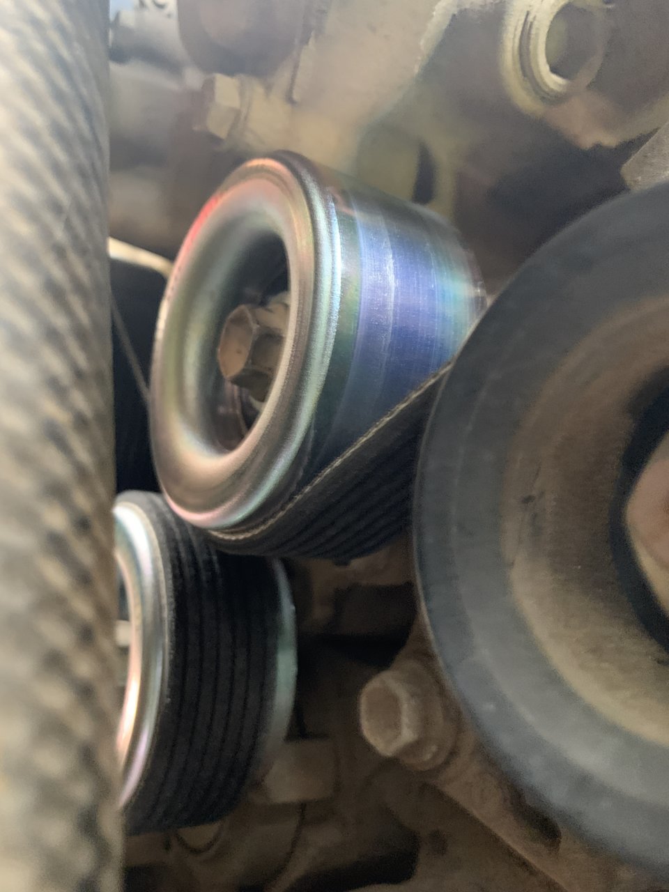

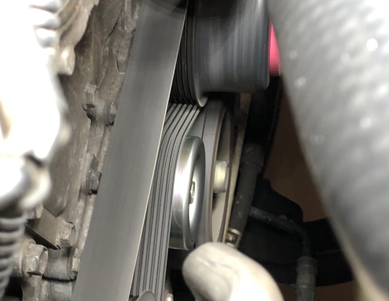

    OK, so I just replaced the two No. 2 Idler pulleys with the Gates 36173. The original pulleys had a washer on the front and the back. I looked it up and I guess these washers are actually referred to as Idler Pulley Cover Plates. I installed them back in the original positions over the new Gates pulleys. Was that correct?
    There does seem to be quite a bit of real estate left on the front of the new pulleys. I noticed they were deeper than the originals.

    @Jamers99 That does look like the pulley is pushed out too much. Are you able to see the inside of the pulley? As long as the belt makes full contact with the pulley, you'll be ok; otherwise, remove the inside washer - that'll bring the pulley an extra mm in. Or, leave the washer in the back and move the adapter to the frontside - I believe the aftermarket pulleys come with a 17mm to 15mm adapter to center the pulley, but the mounting spot on the timing cover is not very wide; so, you need the OEM washer or adapter back there to spread the clamping force when you torque the pulley bolt.

    Well I did compare the old pulley to the new Gates pulley and the inside edge lined up exactly when using the inside washer. Without the inside washer the Gates pulley would then move the depth of the washer closer to the engine. The new Gates pulley just has more depth to it. When the belt is on, there is still ~1 mm of space between the inside edge of the pulley and the belt. This should have been the same amount as before.

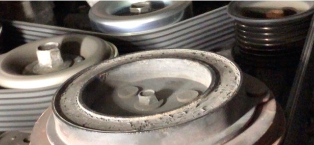

    My problem was my top tension pulley. It was also the hardest to get the bearing out of. It was completely corroded with dry dust and grim. It took me about 45 minutes just to bang it out of the pulley with the socket and hammer trick.

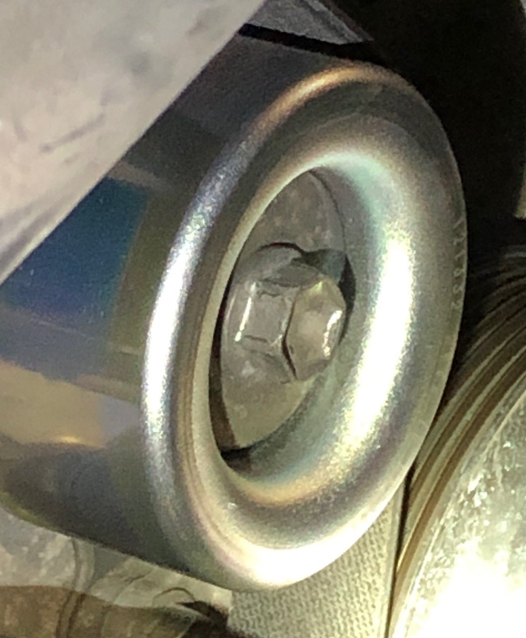

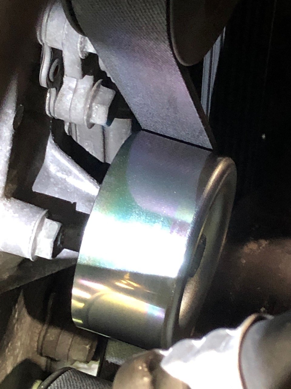

    AC Delco part # 36173 is a direct replacement pulley and bearing for the tensioner. Just don’t use the provided reducer sleeve.

    I have that same pulley and compared the offset to the Febest pulley, a known direct replacement, and the offset is a 5mm difference. Since 36173 is not listed as a replacement, it is best to get the Febest or, better yet imo, press out the old bearing and press in the Nachi bearing.

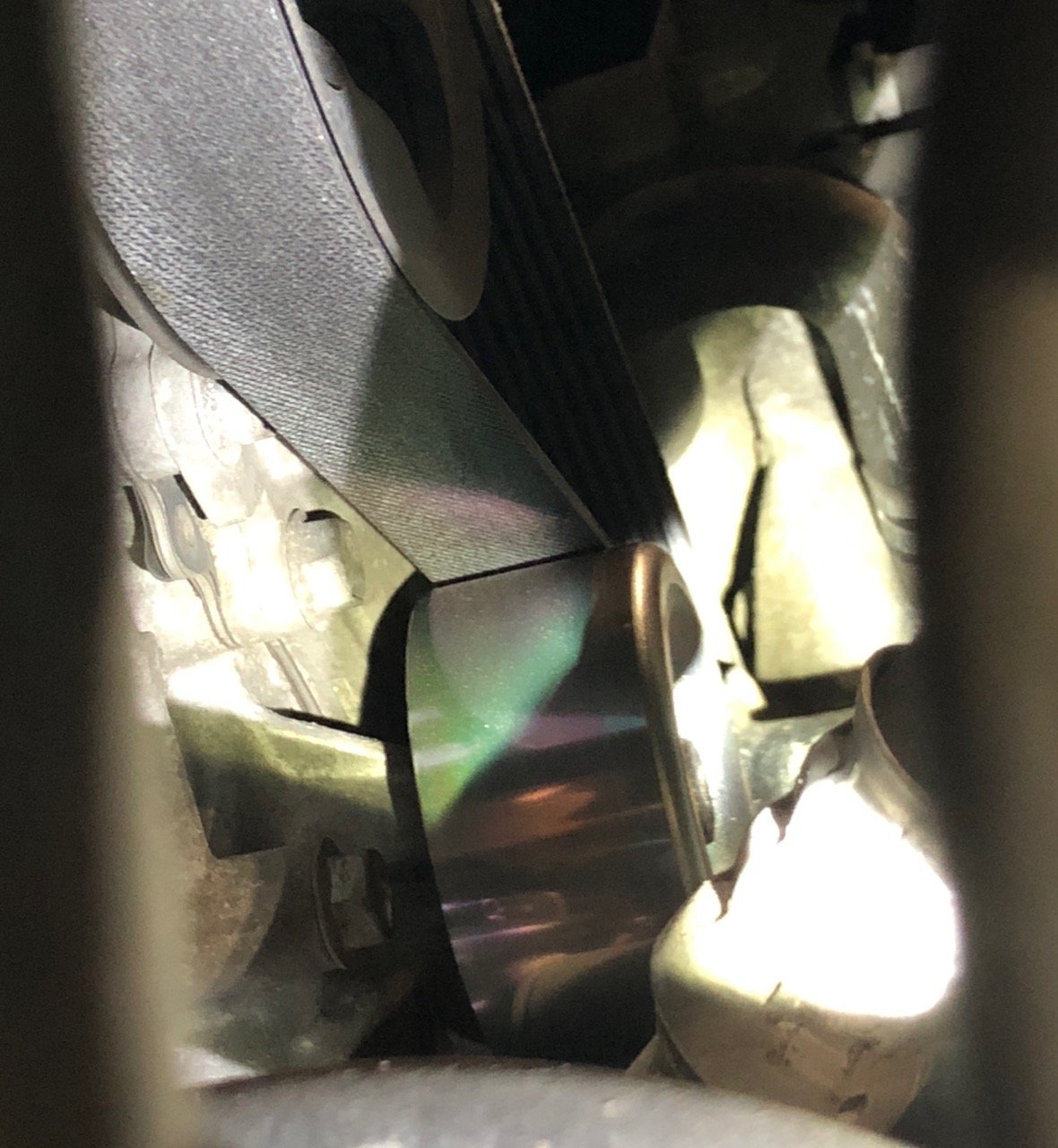

    I can understand that. The pulley does seem to be slightly set back (lower left) but it’s working fine. I imagine I’ll replace the whole assembly when I have to do the alternator.

    Looks like its riding on the outside edge which would put a bit extra load on the bearing. Similar to how wheel adapters change the load on a wheel bearing. But the forces here are not as high.
    Edit: upon closer inspection, the bearing in the 36173 bearing is 11mm wide; the bearing in the tensuoner pulley is 17mm wide. Dont expect the bearing to last as long. But, it is a viable option as a backup.

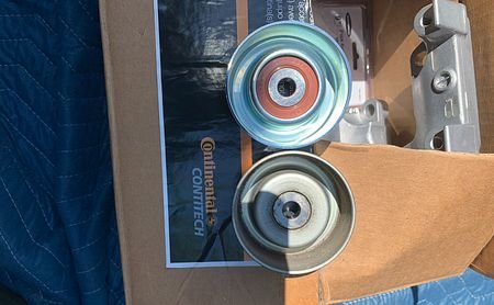

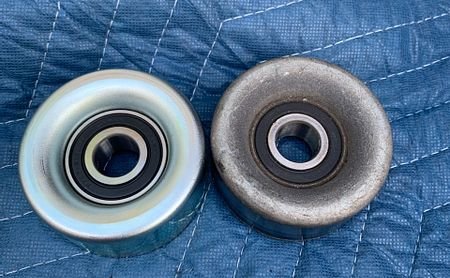

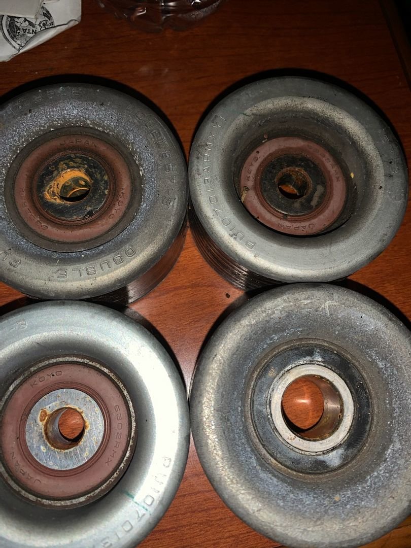

    I bought a Continental kit. The tensioner is OEM with the casting number milled off. The idler bearings are Koyo with the tensioner bearing a NSK. The number 1 idler with the wide bearing has a shield so I can't be certain of the bearing manufacture.
    The old number one pulley the first pic in the upper left has two Koyo6302RMX bearings.
