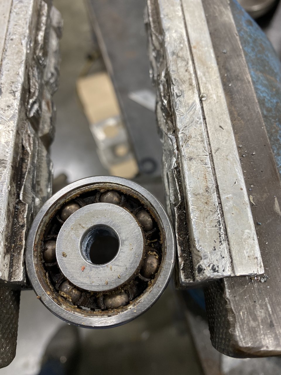

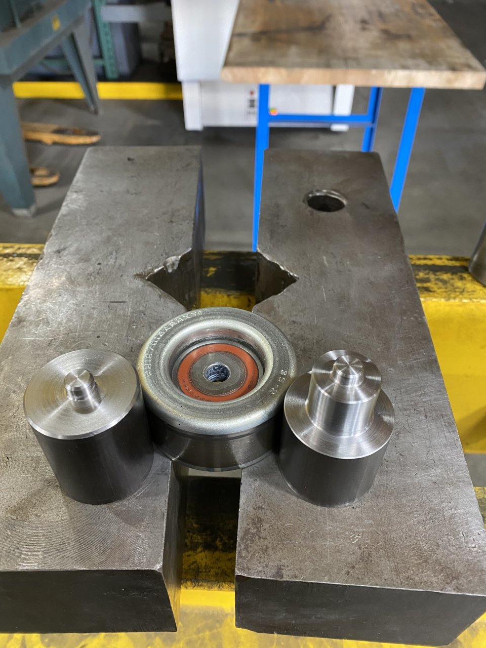

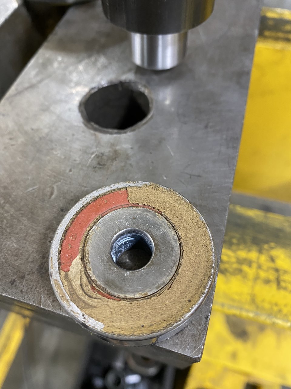

    After ordering my 3rd set of pulleys from eBay for 70 bucks shipped from asianauto I decided to build a set as spares. Made a removal and install set of press tools. Opened up the bearing from the top drivers side pulley that was making noise. It didn’t look good at all. Almost no grease and it’s that gold color from overheating. There’s another pic of the bearing after removal. A lot of dirt got inbetween the back of the bearing and the pulley. This has only been on my truck for about 8 months. Though I did go thru a silt bed in Death Valley that was horrible.

    Even without all the dust I would have expected more grease in there.
