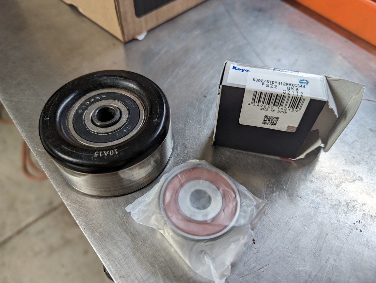

    @SpicyRedTaco11211983 You have a Gen3 and this thread is for Gen2. However, it appears your tensioner components are same as the 3.5 V6 in our 07 Lexus ES350. The measurements I got were 12X40X17 (width x OD x ID). By chance I found out that a Gates/ACDelco pulley # 36174 is a direct replacement. If I recall correctly, the Gates pulley is about 3mm narrower but it is holding up well. It has close to 100K.
    These are the OEM parts I replaced with the 36174 pulley. I may still have them if you want me to take other measurements. Note: the ‘inner spindle’, I refer to as a reducer, it reduces 17mm ID to 12mm, or 10mm, I forget. It’s more important function is to center the pulley/bearing so it don't wobble in place.
