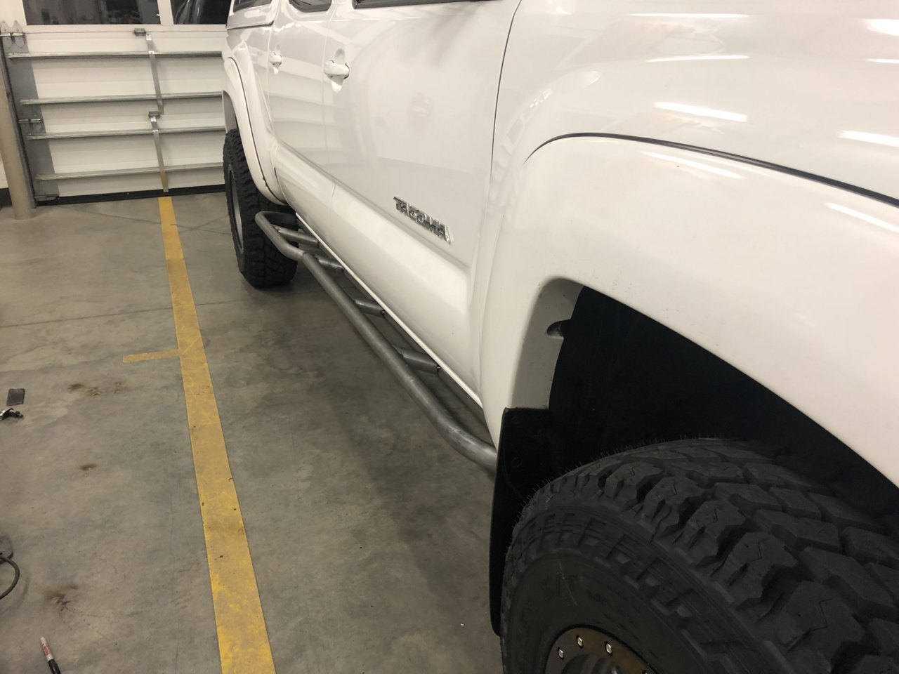

    Almost finished with mine. I just searched and looked at designs then came up with my own.

    hey man just curious how much material did that end up using?

    I ended up buying some from CBI. But there is just under 40 feet of inch and a half tubing. The plates where it mounts to the frame are approximately 40 inches long, Bent at a 90° 6 inches wide on one side 4 inches on the other.

    Close to 50 feet!

    I built mine, check the build thread. Cost me $150.

    What area are you in and what was your material cost?? Those look nice. Havnt sourced materials in my area of CA yet, just curious
