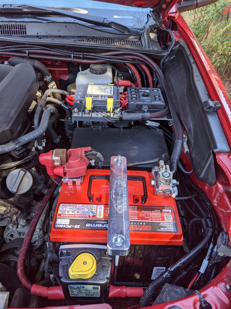

    S-pods are just glorified fuse blocks with some integrated switches.
    Get a Blue Sea systems fuse block, a master circuit breaker and some wire and switches.
    https://www.tacomaworld.com/threads/simpler-blue-sea-systems-auxiliary-fuse-block.502556/
    https://www.tacomaworld.com/threads/blue-sea-fuse-block.639453/
    Your choice is to either spend some elbow grease and maybe $150 on the fuse block and some switches and relays (Blue Sea 12 circuit is like $45 on Amazon, circuit break is like $40), or spend like $550+ for a 6 circuit S-pod.

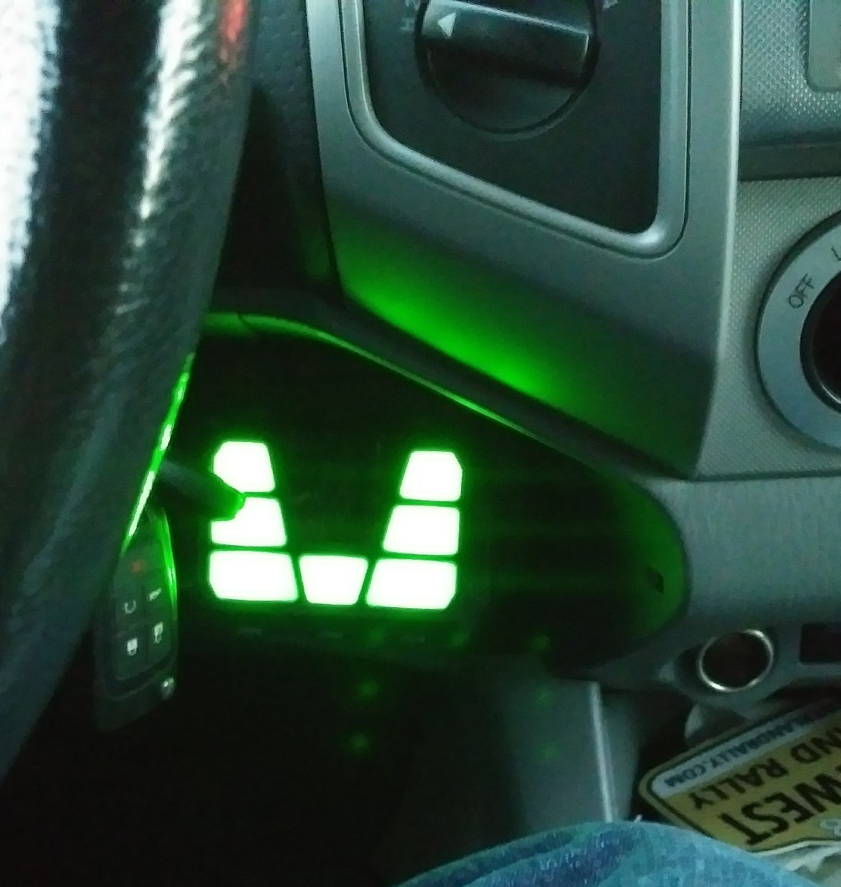

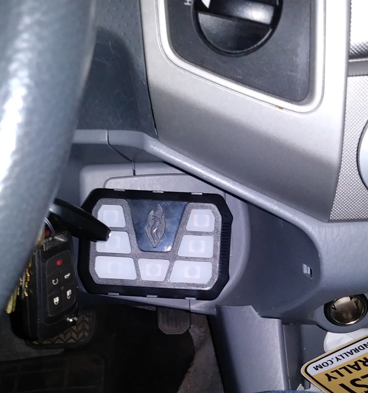

    https://www.amazon.com/Feniex-Industries-4200-Mini-Controller/dp/B018UJHVEA
    I love my Feniex controller. It's a nice small package with 6 controls. I've got it in my 2nd gen, but hopefully the pic below gives you an idea of its size. It is simply six switches though, you'd have to run the wires to relays which is what I'm doing. It does have some cool functionality though. The top two buttons across from each other can control strobe functions (built in patterns, and the buttons flash to match the pattern. I'm in Search and Rescue). The buttons can also be set to momentary as well, for if you want a horn button or something.
    The buttons aren't usually this bright, since they come with a sheet of labels that fit into the indents of the buttons, which cuts out a lot of the light. They are all on when you press the "on/off" in the lower middle, but brighter when the specific button is set to "on"

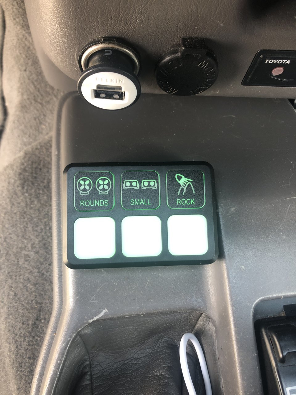

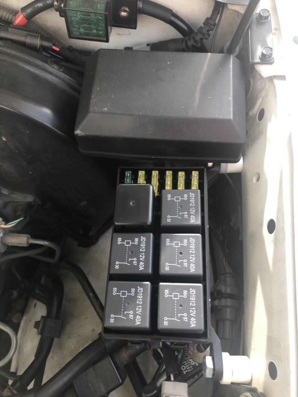

    I have this 6-gang switch panel and love it:
    https://www.ebay.com/itm/223711722732
    it was super easy to wire up, comes with relays and fuses in a box, and was only $88.
