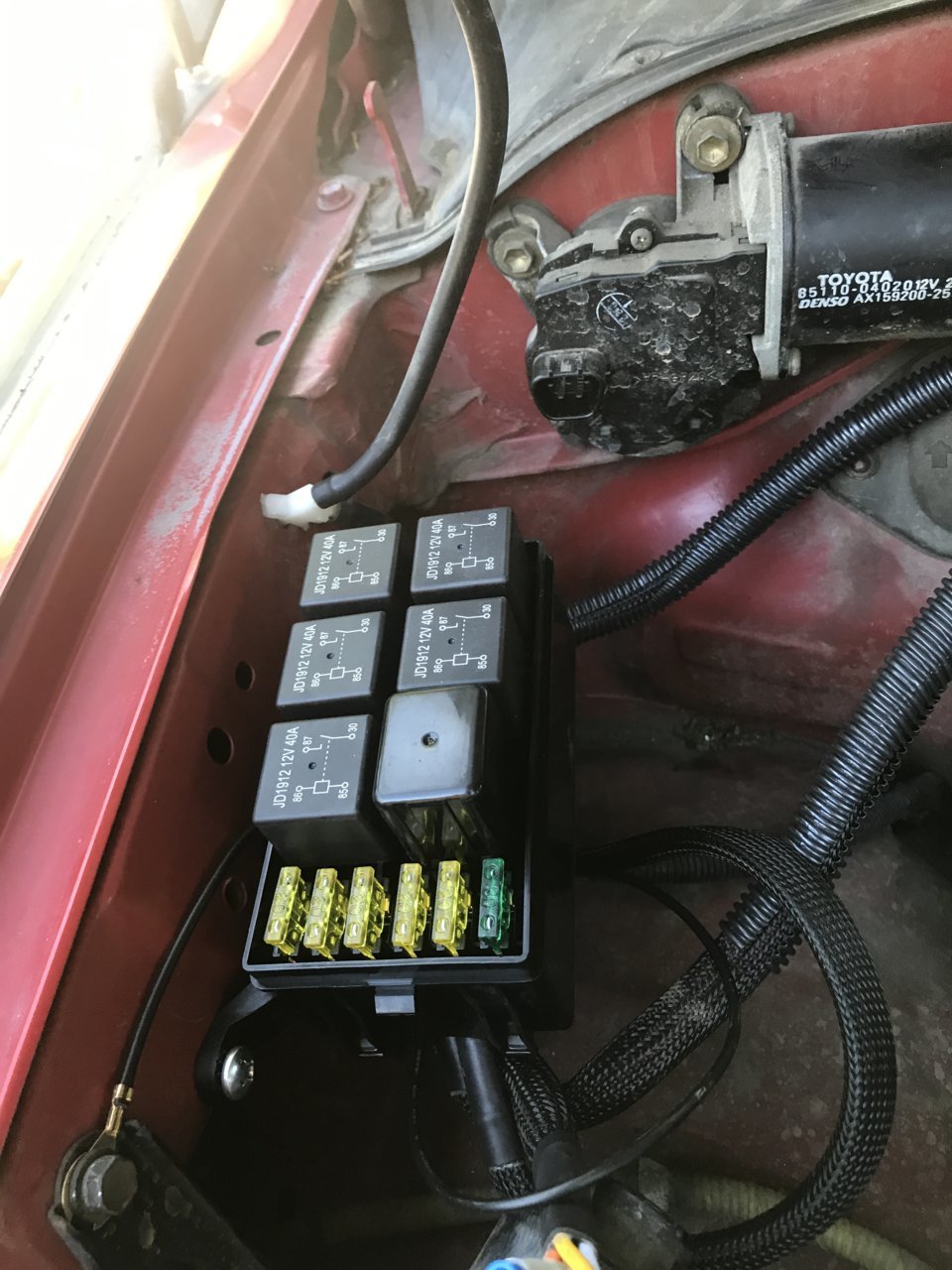

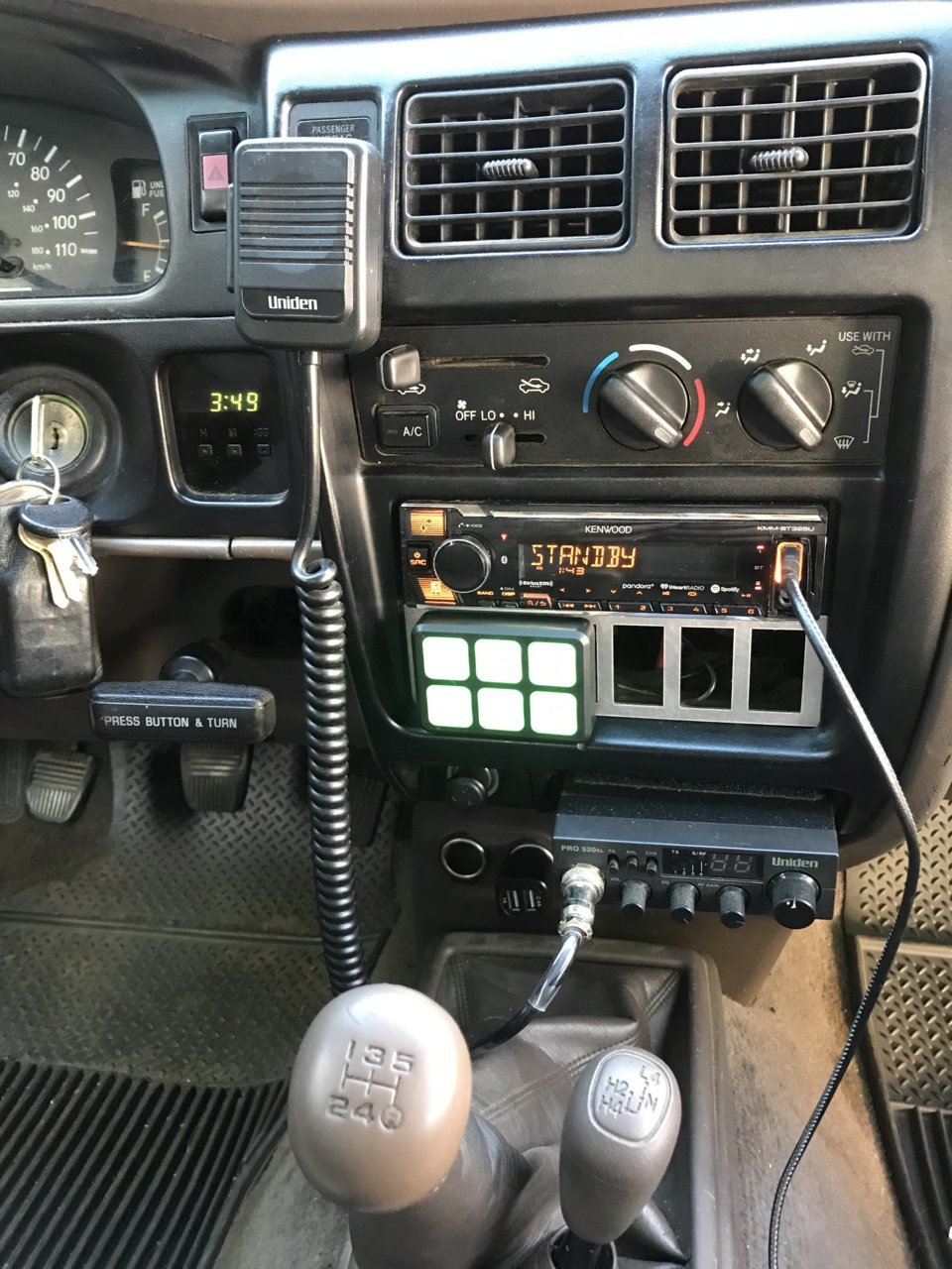

    Interested so I picked one up and installed it. As you can see, I was planning on setting up some rocker switches, if all goes well might just convert it to rockers. Tested out some lights and works, also added a circuit breaker.

    SwitchPro never does any discounts fyi.
    Ive got 8 switches, can dim/strobe/momentary any light that I want and I never have to figure out more than positive/negative plugs. With relays, they have 5 plugs, switches have 4, and the accessory has 2. Where do the rest come from. I am not an electrical wizard. Cant make things appear..
