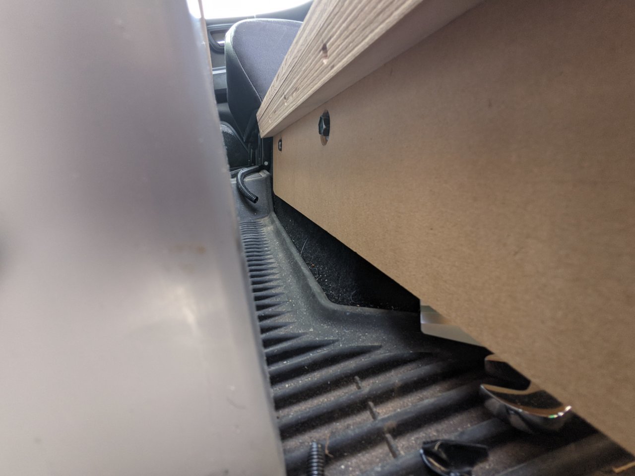

    Hey yall so I searched around quite a bit for something like this before starting this project and found pretty much nothing so I figured I'd upload my build.
    Finished shots first.

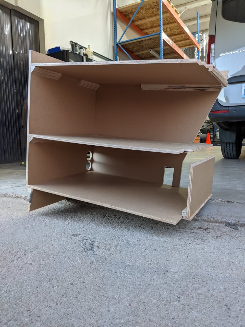

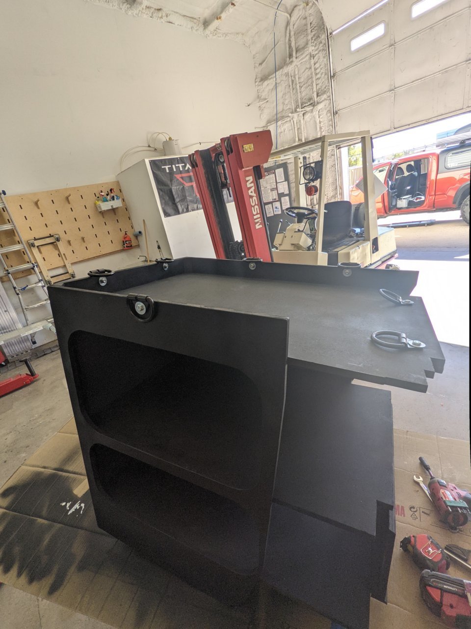

    Whole thing is made of 1/2 MDO plywood with wood glue and screws. Coated with matte black spray paint and Rustoleum spray on bed liner. Mixed feelings about the bed liner, I used it because I wanted the abrasion resistance but didn't want it as "sharp" feeling as the roll on bed liner I've tried. This came out almost sand paper like.

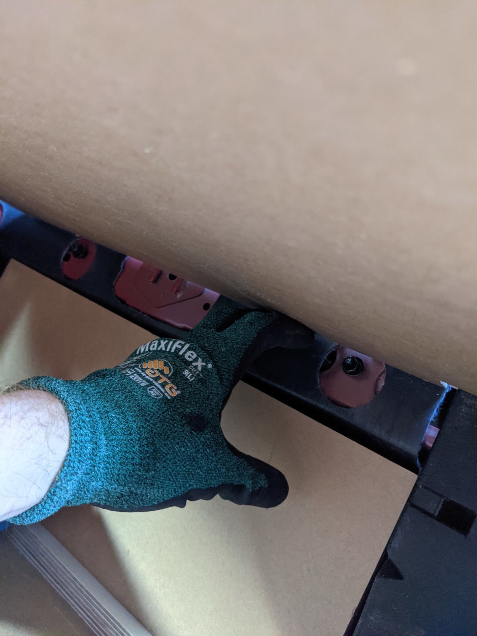

    The cab is mainly secured by the bolts that held the bottom half of the seat, the rear half is sitting on the rug covering the sheet metal.
    There are L brackets installed where I am pointing in this photo which use the smaller bolts for the plastic trim.

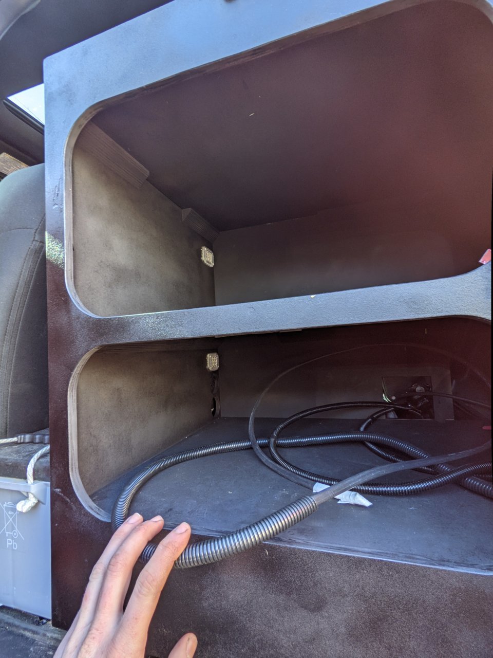

    Not pictured is the top shelf resting on a ledge in the sheet metal directly below the window. I added weather stripping here to prevent any noise.
    The shelves are supported by these angles created from 1" baltic birch plywood. The square hole in this photo was eventually made larger, but it is to accommodate the seat hinge which I could not figure out how to remove. Also pictured are some LED's I scavenged from a ford transit.

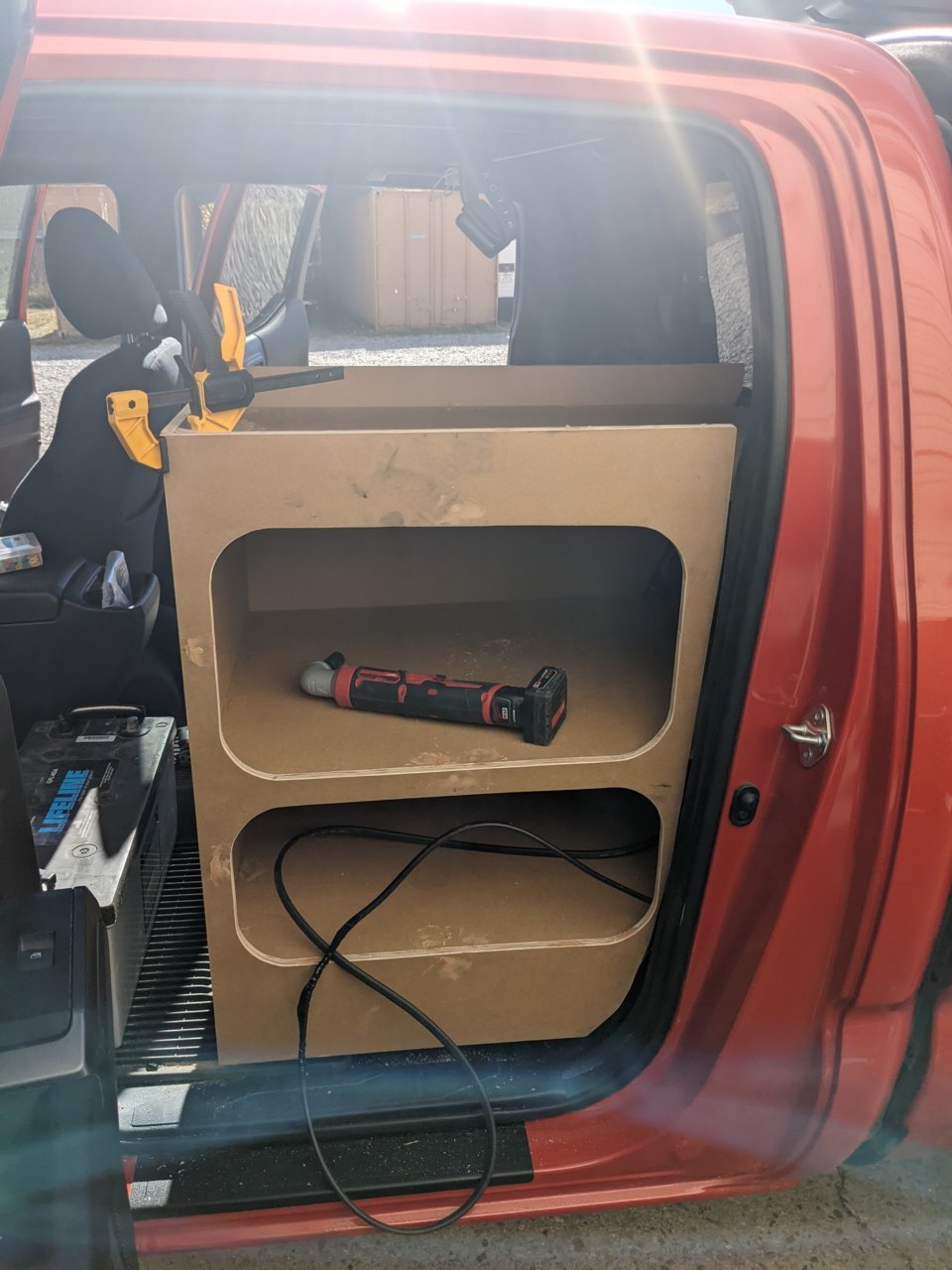

    I made the face plate by scribing my cut outs instead by measurements in order to achieve a perfect seam on the bottom of the cubby hole, as I was slightly off from 90* on the shelves due to shenanigans with the L brackets.
    All the screws were covered in bondo woodfill before painting. I used old bondo which caused some screws to be slightly visible.
    D-Rings scavenged from a Mercedes Sprinter were bolted to the top plate with 1/4-20 bolts so I can strap stuff down and not be hit in the head.

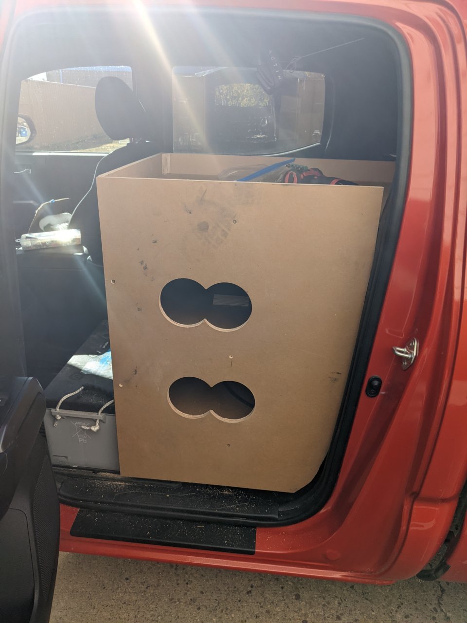

    The passenger side seats need to be removed to install this cabinet and then reinstalled after to make it fit. This photo sort of shows one of the cutouts I made to install the seat bolts on the drivers side (at the bottom corner of the square cut out. They were eventually made larger because it was a PITA to get the bolts started.

    I added in some of the electrical, just enough to get the lights + outlets in the cab and bed on. Next up is hooking up the Orion to charge the Aux battery off the alternator
