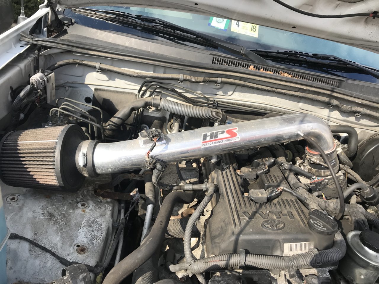

    I'm so confused though. I read the first 2 pages and skipped back here. It took me 1/2 of the OP to realize that the secondary air filter blah blah (usually a separate charcoal cylindrical canister in the engine bay) was in the actual air filter housing. Like...wut...??
    Does it filter the air twice, or does it filter different air going to a separate place...?
    I'm also really confused how this would affect emissions at all.
    It's just so weird to have a permanent air filter that can never be changed.
    Did I mention I'm confused?
    EDIT: Likely why I'm so confused is my truck came with a goofy "HPS 'high performance' intake on it. I bought a used OEM air housing assembly, waiting for that in the mail. I haven't looked too closely at the intake currently on the truck, but I didn't see many secondary hoses running anywhere - something that alarmed me a little bit as I've noticed all/most modern vehicles have at least a couple vacuum lines on the intake.
