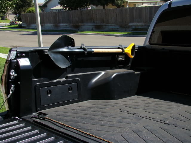

    I mounted my shovel to the rails using Quick Fists...It came in handy during my last snow trip. If you can't get the the Quick Fists I would recommend either stainless steel hose clamps or u bolts to secure them to your rack.

    I bought from End of the Road. Product arrived in about two days. Confirmation emails pair you with a representative and their direct phone line. Shipping was $1.50
    I mounted similar to the above, but found that adding a 5/16" fender washer helps eliminate the fist from flexing.

    Ok so your setup looks really clean but do you know of any quick fist's or similar products that allow locking your shovel up with a key or something to prevent thief's from stealing your shiiiovel ?

    That's a pretty sweet setup
