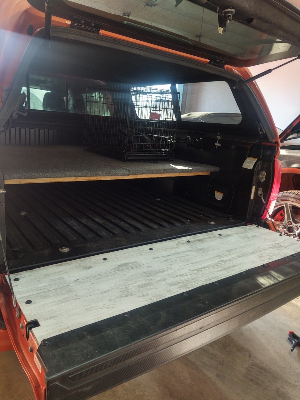

    Playing around with some left over flooring I picked up from a neighbor.

    Yup, just cut it to size. I ended up changing it to a wood laminate this weekend tho.

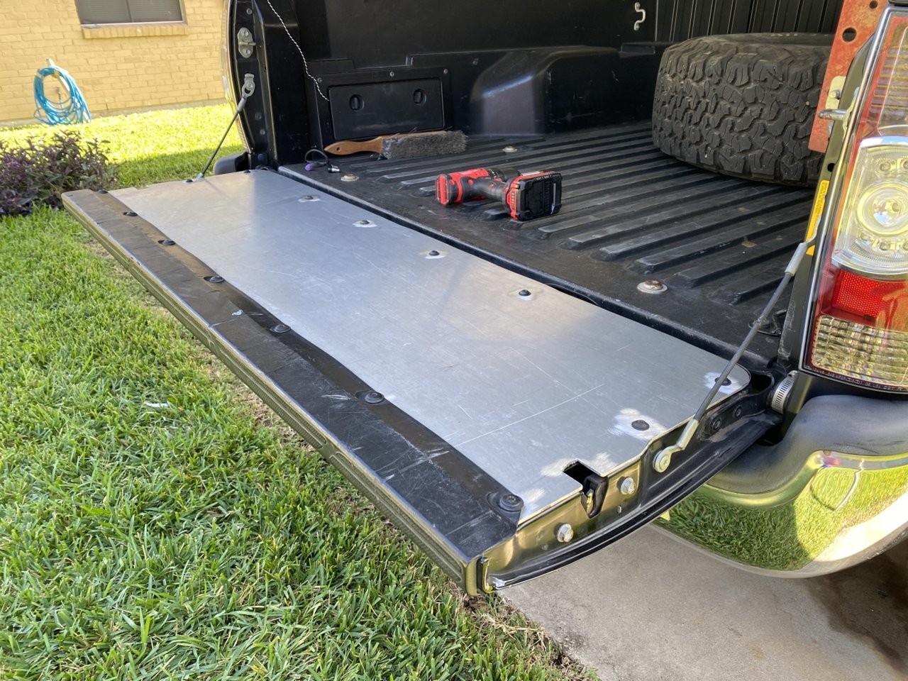

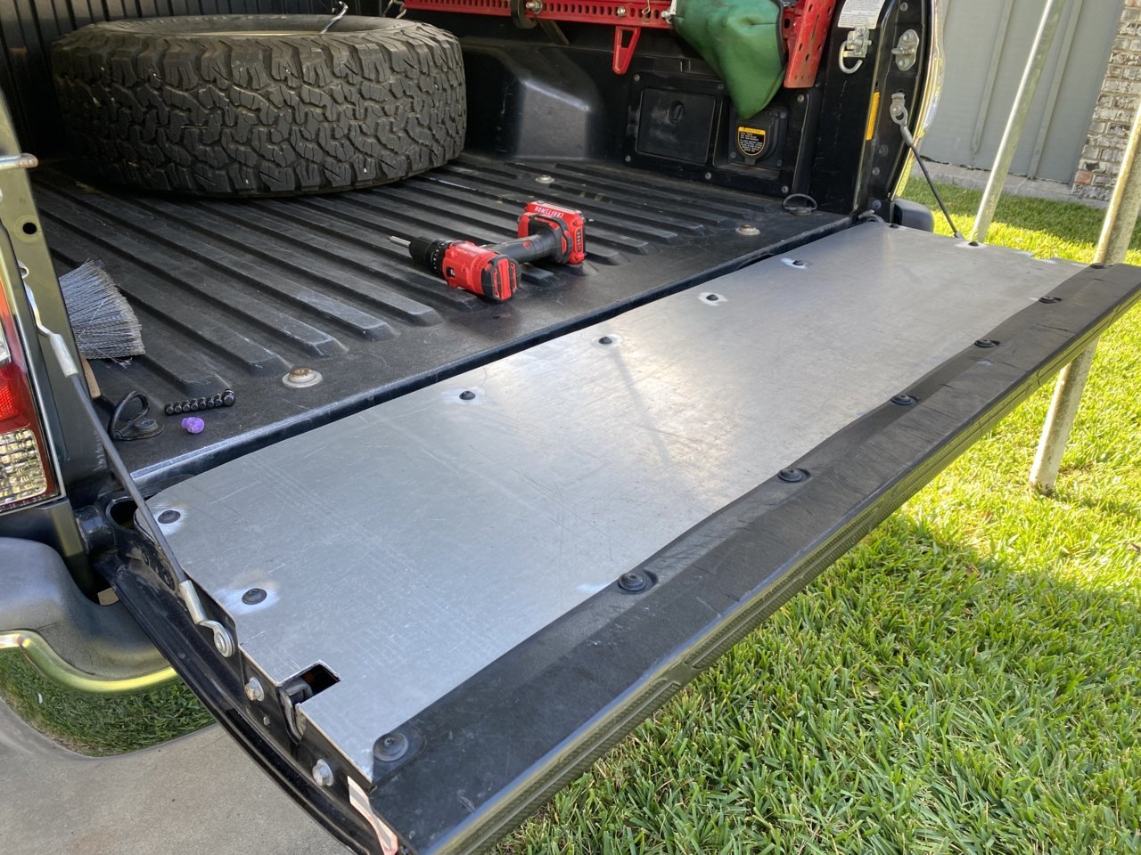

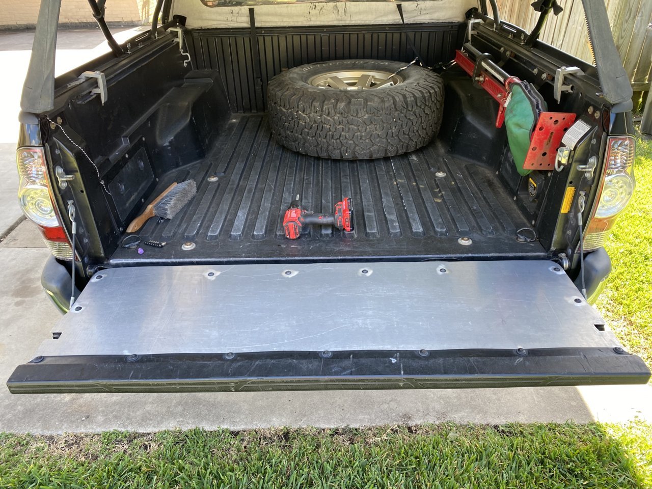

    Just DIY’d the shit out of the panel this morning. Only about 2 hrs start to install. And a lot of that was second guessing myself on minor details.
    Found a shop that had some 1/8th aluminum plate laying around for $85. Had them rough cut, then made the final cuts and drilled holes myself. A lot easier than i thought it would be. I’ll prep then paint on my next set of days off with good weather. Overall, EXTREMELY happy how it turned out. The 1/8th thickness allows the gate to close completely without binding on the lip of the bed. 10/10 would do this again.

    Very nice! I have a sheet of ABS that I'm going to use. Was it any more complicated than tracing the perimeter and holes? What were those minor details you had to work out?

    Well, if you simply trace around the outside of the material to be cut, when installed, it will be slightly proud around the inside of the gate which would interfere more with the binding, bed issue. What i ended up doing was cutting the whole thing smaller to fit inside the existing panel. Then, cut short on the top end to sit flush against the bottom end. Drill holes LAST. Better fit, IMO.

    Use old fashion CAD 1.0, cardboard aided design, or just pull the factory piece off and use it as a template. Just make sure it will fit with the tailgate closed.

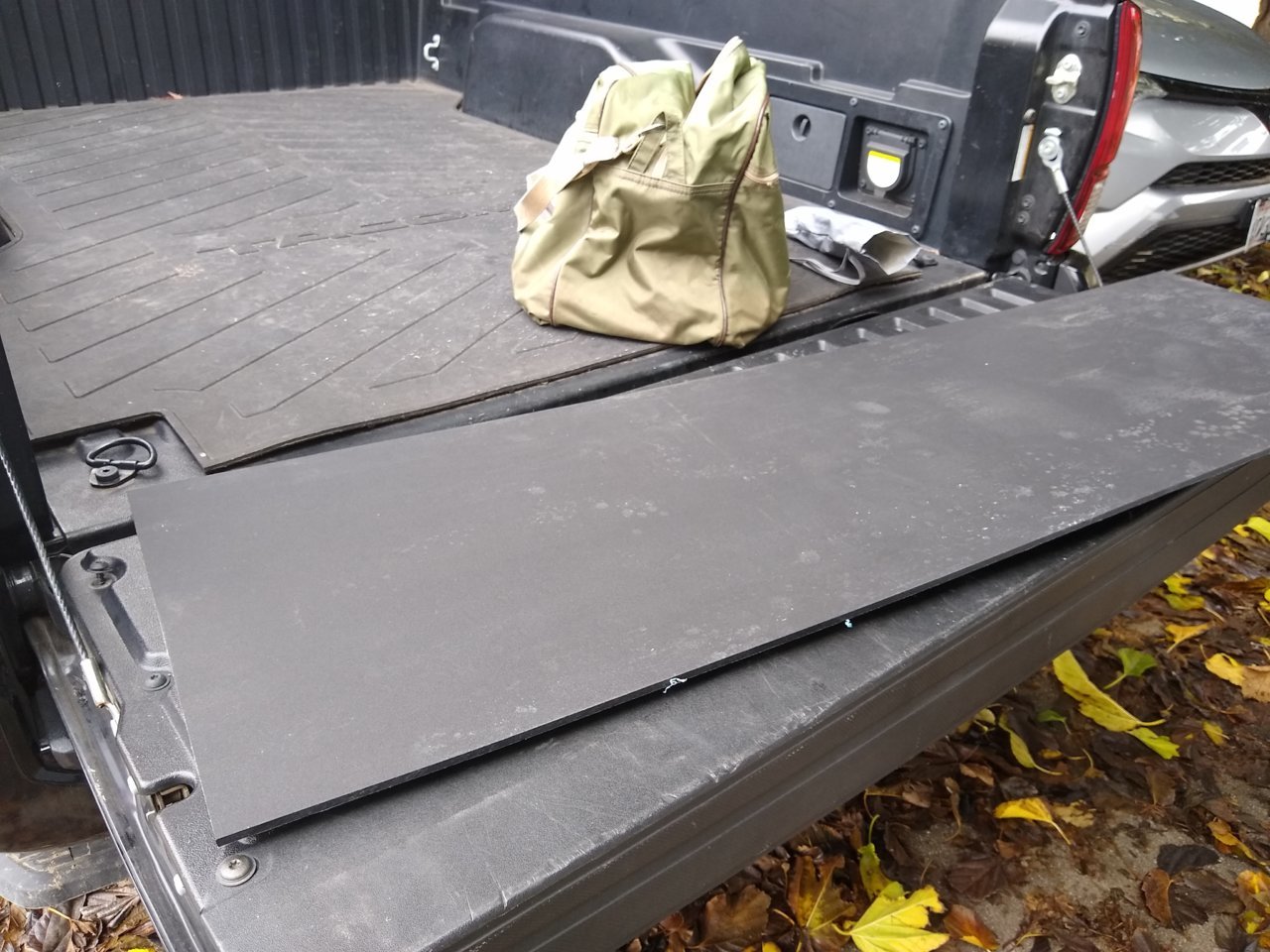

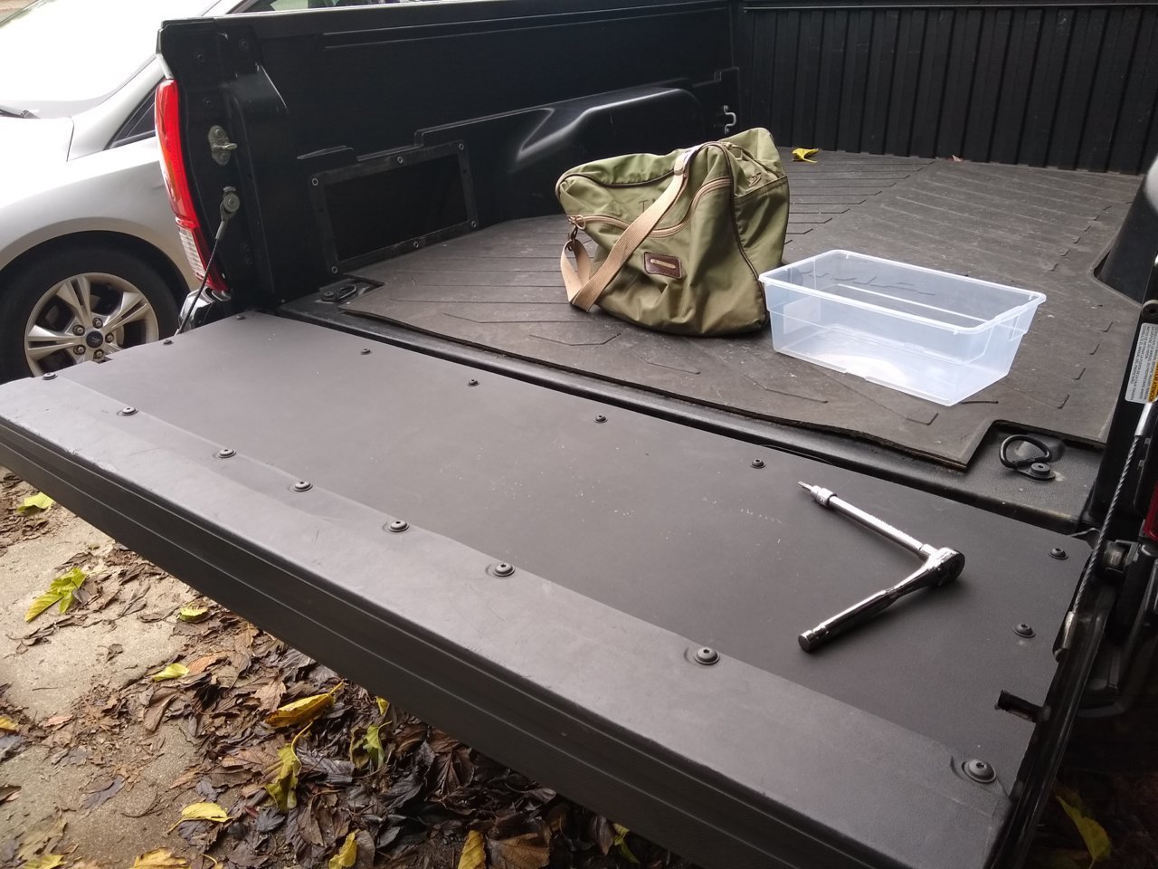

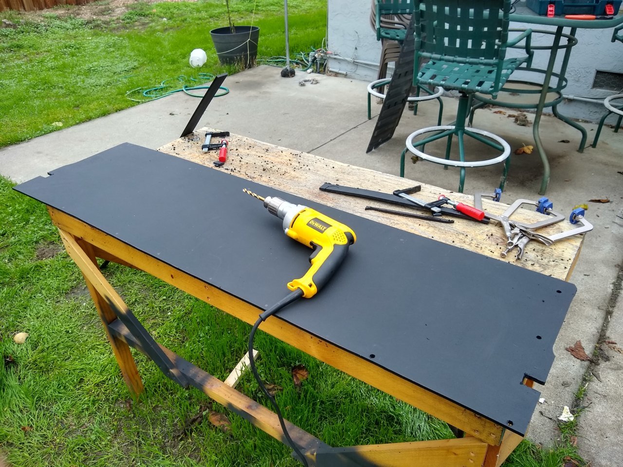

    Here's my DIY panel that took about an hour, for what it's worth. $65, just had to borrow someone's jigsaw as one not in my tool collection yet.
    IMG_20211114_125006760.jpg IMG_20211114_142753458_HDR.jpg IMG_20211114_145345840.jpg
