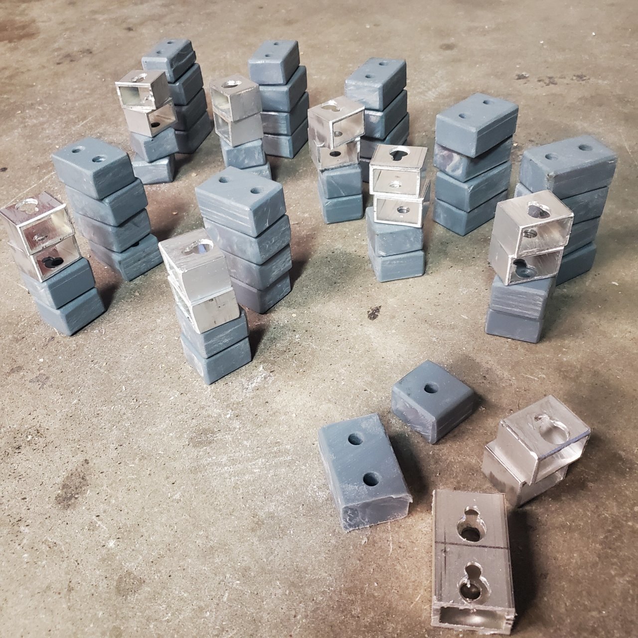

    These grey blocks are HDPE. It was a nightmare to deal with because of plastic hairs.
    Next time I make some of these blocks a water jet company is going to cut them out for me.

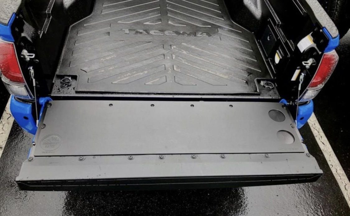

    I want a smooth surface, but I don’t want the added weight of a metal panel like Mobtown or Relentless sells.
    Something like this is perfect

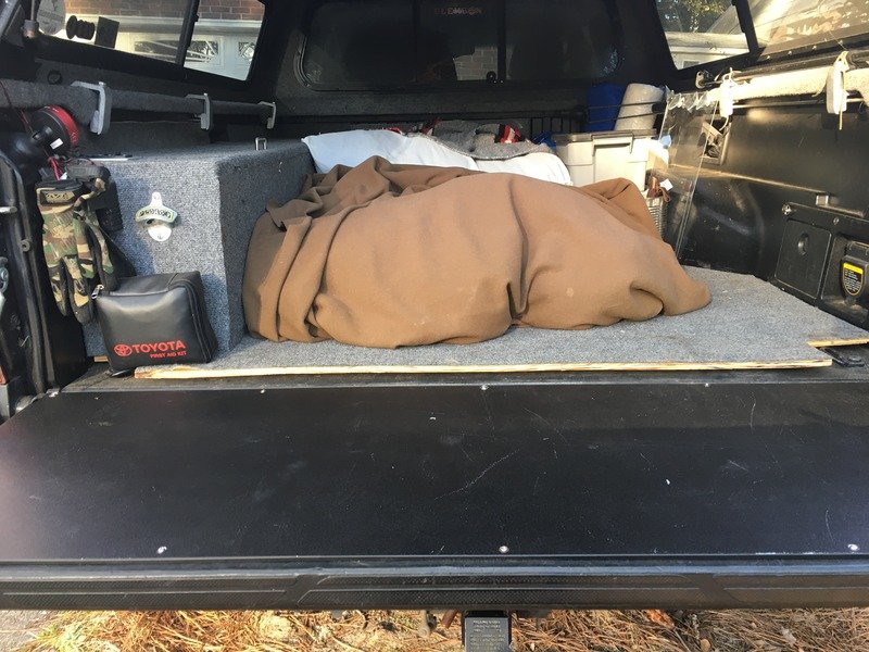

    Yes, I've posted in a similar thread a while back. I wanted a flat surface for cooking, using as a workbench and because the factory piece is hell on my knees when I'm camping out of the back.
    I went the inexpensive and simple route of buying a cut off piece of HDPE from a local plastics place and screwing it to my tailgate. I wanted black but it was more expensive and I'd have had to buy a larger piece so I ended up with a white piece and just sprayed it with some of that black plastics paint that I had left over from another project, same with the screws. The paint has held up better than I expected but it's very easy to touch up if needed. I think the total cost was about $20 maybe and they were even nice enough to cut it to size for me.
    I'll try to find the picture I posted before. Found it; ignore the camping crap in the bed, it's an older picture and some thing have changed.

    Maybe 3/16" or 1/4"? I can't really remember but it doesn't really flex even withe me standing or kneeling on it. That picture is a couple of years old and it still looks about the same although I hit it with some paint again last year. It doesn't look like it from the camera angle but those screws are evenly spaced and lined up.

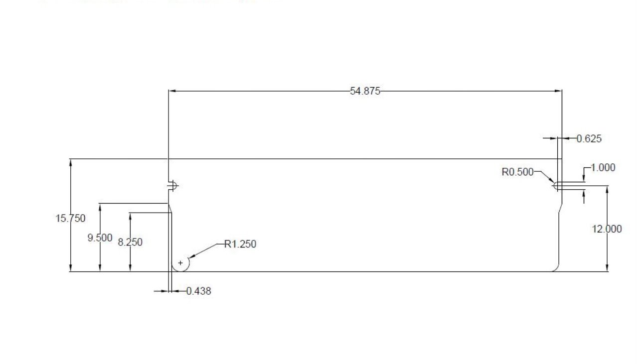

    @steveo27 here are the measurements for a 2nd gen tailgate skin. Courtesy of another member. When you have your material of choice cut to the outer dimensions you can use your factory skin as a template. I used 1/8 aluminum plate. Any thicker around the bottom and the sides you might have problems with the tailgate closing.
    Also, you might consider installing nutzerts and using new hardware. There have been issues with the outer tailgate skin separating from the bracing on the inside. So look into some good adhesive to bond them back while you have it opened up. You will also see the crappy plastic threaded inserts that strip easily. When you take the OEM ribbed skin off you’ll see what I’m talking about.

    Good info. Appreciate the drawing w/ dimensions.
    I’ve taken that back panel off a buncha times. Well aware of the less than stellar hardware the factory uses. Also aware of the panel bond failing. Mines been separated for the past 5 years, just haven’t fixed it yet.
    Earlier today, I popped the panel off, did my measuring and got everything figured out.
    I pulled the trigger on a piece of 1/4 HDPE. Should be here Friday.

    When I measured, I measured the inside area with the tailgate closed so that I didn't have to worry about the thickness. It's just a rectangular piece that is screwed into the factory tailgate cover and it covers between the outer raised part (ridges) of the factory cover (if that makes sense); look just under the side edges and that should help explain it. It doesn't extend out as far as the openings for the latches. If I had removed the factory piece then I would have had to make it larger obviously but all I wanted was a simple flat surface. The fancy expensive ones look nicer but it's a tailgate, I use it as a workbench. I also like that the plastic doesn't dent, I can use it as a cutting board, it's light weight and it's not as cold against the foot of my sleeping bag or when I sit on it. It's got a couple of scuff marks where you can see that it's actually white under the paint but again, it's held up well and a quick shot of paint will fix that if it starts bothering me. You can buy it in various colors, primarily black, but they're more expensive and this was more or less a scrap that the place had.
    The other reason I made it the way I did is so that I could remove it and the factory piece with the tailgate closed. Why you might ask? Because I've already had one of the cheap plastic clips that Toyota uses to hold the rods for the latches break. When it does then you have to pull the cover and then pull the rod by hand to unlatch the tailgate.
    Yep, the back is still full of junk.
