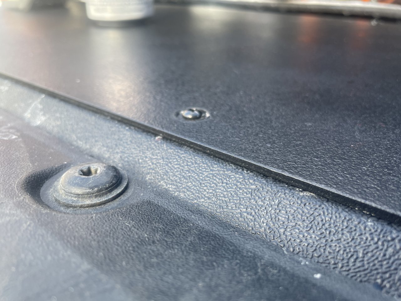

    I’ve been thinking about making a DIY panel for a while, this is what I ended up doing. I’m happy with v1, but may make a revised version with a few more mounting screws. Didn’t want to reinvent the wheel (or pay $200), just wanted a smooth tailgate for tailgating, camping and using as a mobile workbench. Aluminum Composite Panel, 1/2” corner radius, 51.5” x 13.25”. Painted with bed liner, stainless screws. Tailgate closes fine. Here are some photos.
