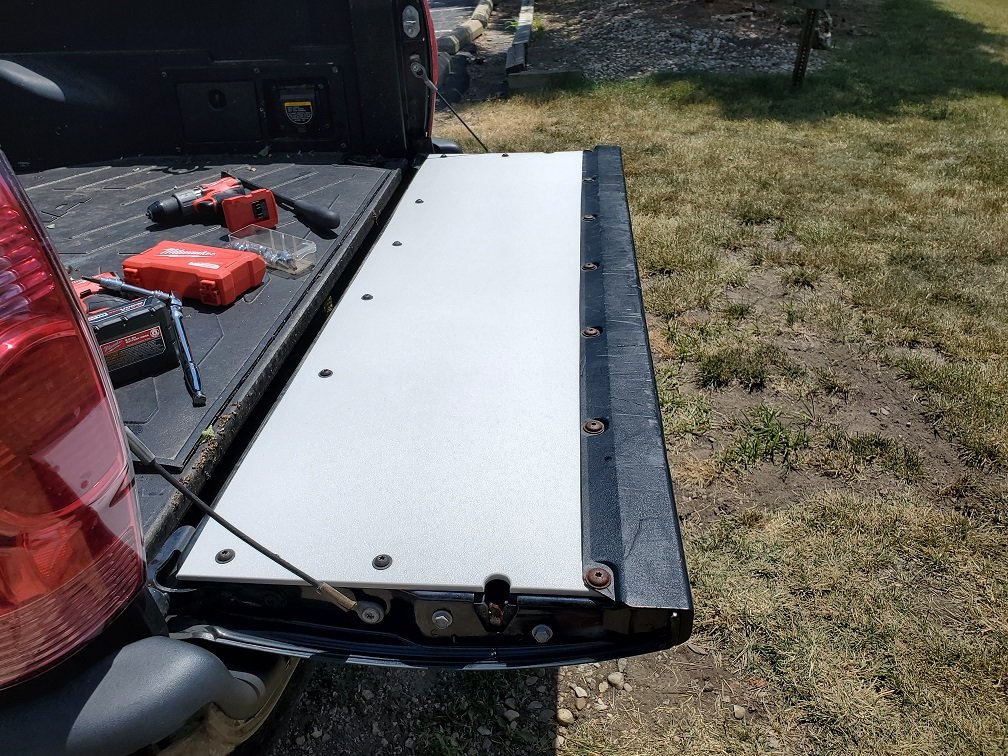

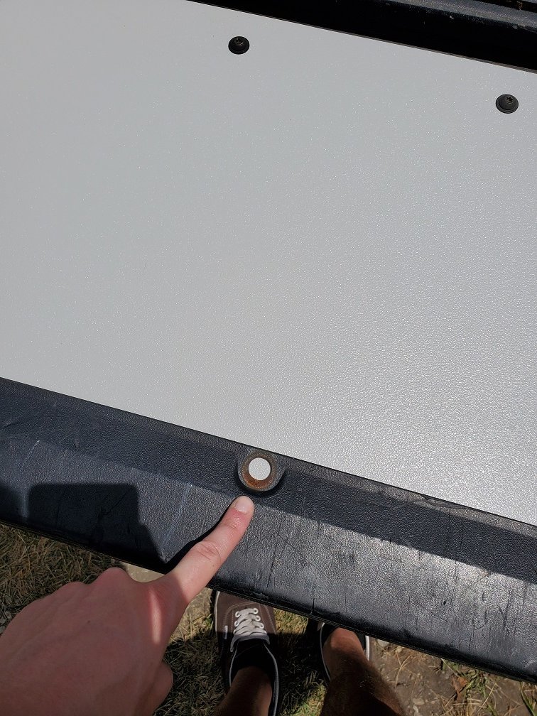

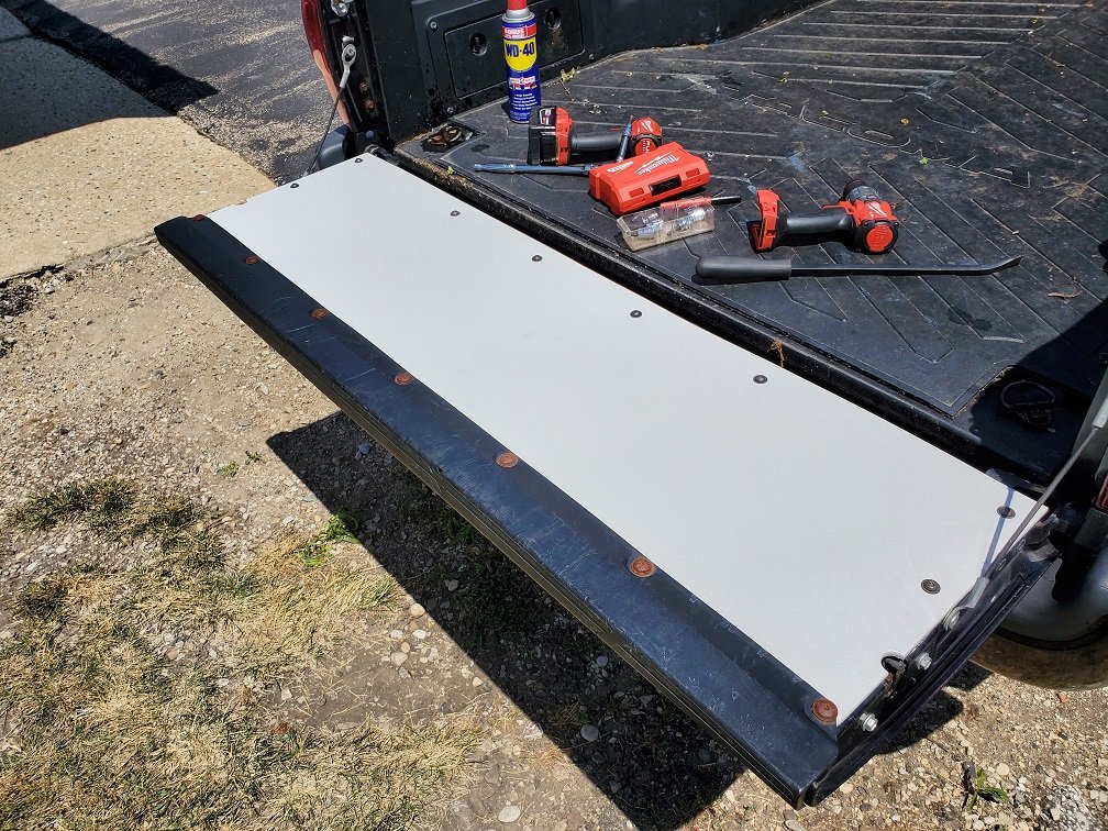

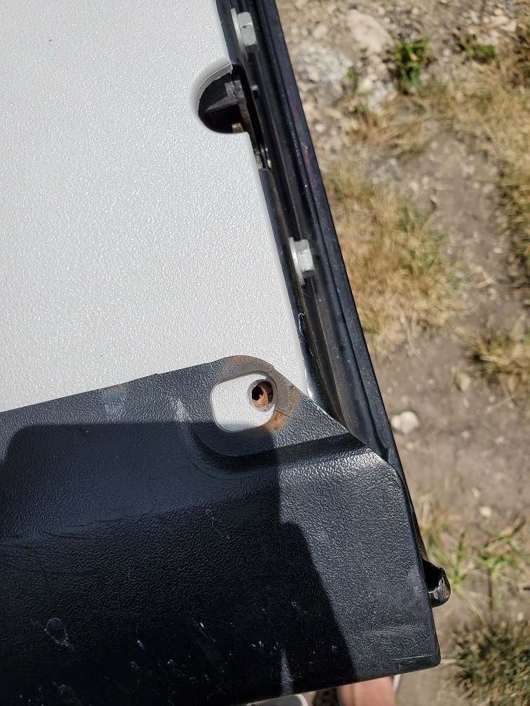

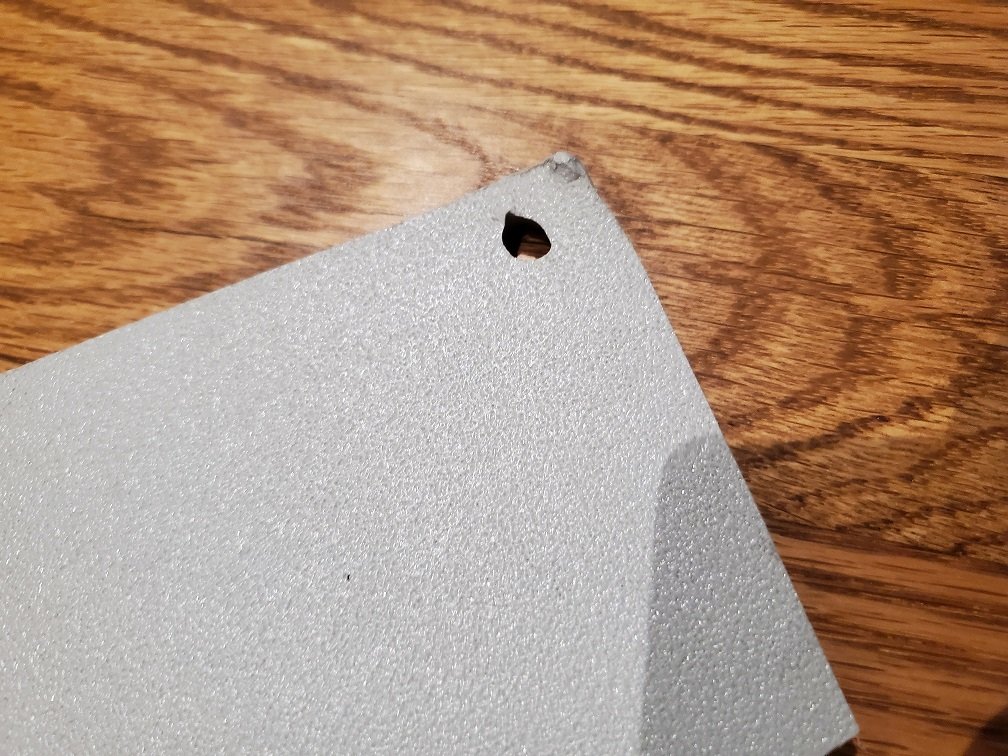

    Alright, update time! I finally received my panel. UPS took their sweet time and the thing arrived battered and bruised. One corner pretty badly damaged.

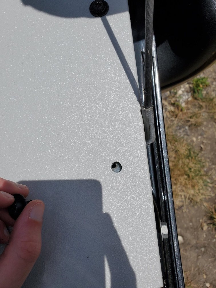

    At first, 2 of the holes didn't quite line up. Likely because it wasn't sitting flat AND the thing may have stretched due to heat.
    It was also missing 1 hole that my tailgate had. Not a huge issue, eye-balled the center and drilled a hole.
  5. Jul 4, 2022 at 10:45 PM
    #225
    kylesburrell
    kylesburrell Well-Known Member
    Jan 20, 2021
    #353454
    53
    Kyle
    06 DCLB 4.0L Tacoma

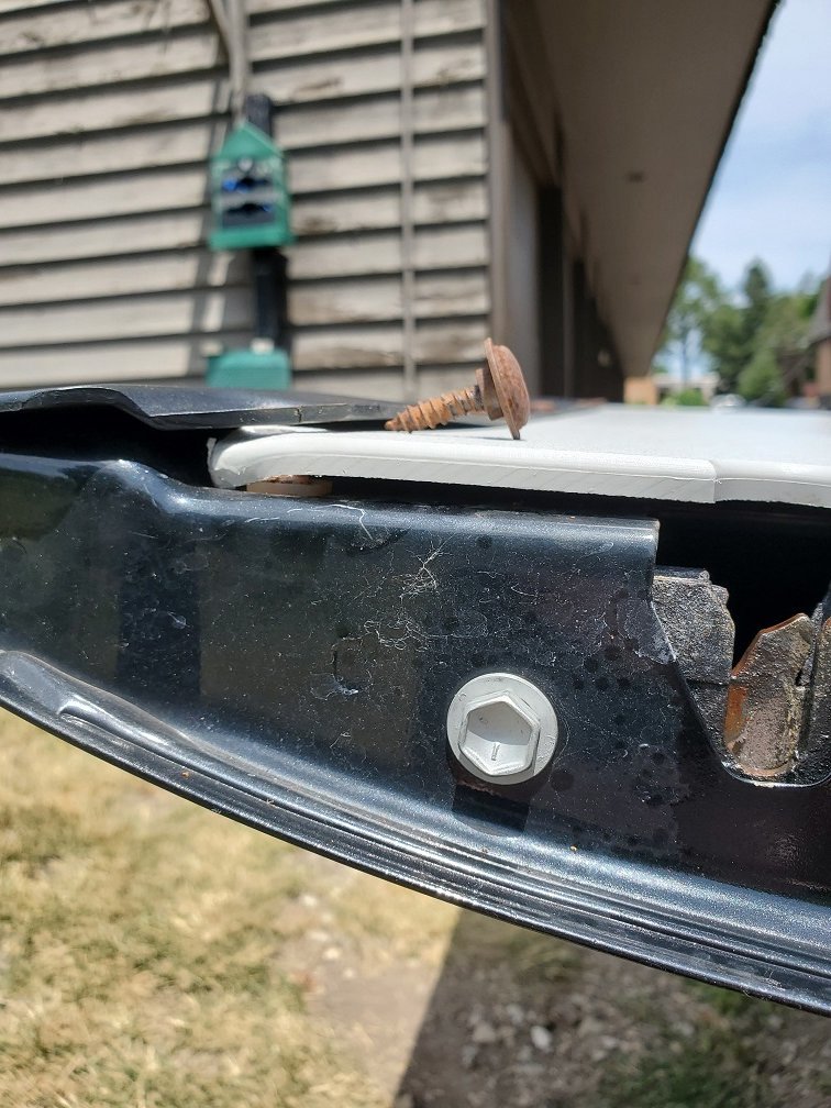

    In the end, I was able to finagle the piece into place and get all the bolts back in. Pretty pleased with how it turned out.

    From what I noticed when I went to install mine, the holes matched up to a third gen.
    I'm curious to see how well your white panel deflects the summer sun. My warps pretty bad, I had to put 5-6 rivet's to hold in down lol.

    I think you're right about the holes being for a 3rd gen. Because they're were 2 holes that I didn't use, but then I had to add that 1 hole.
    And I actually got a gray panel. But we'll see how it holds up in the Midwest heat

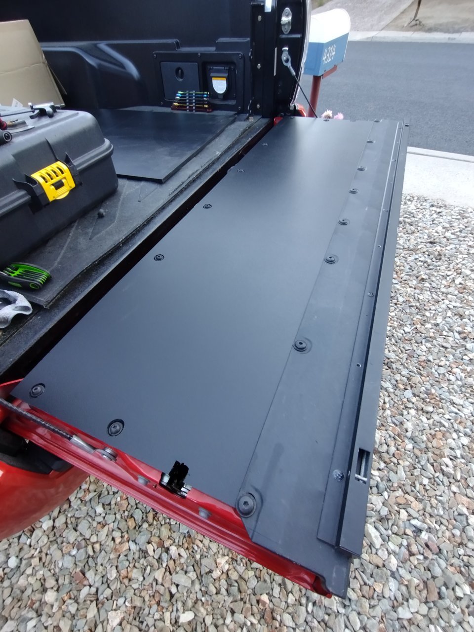

    Made my own today, not bad for an hours worth of work, used 3/8 HDPE

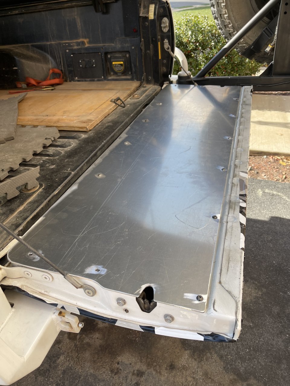

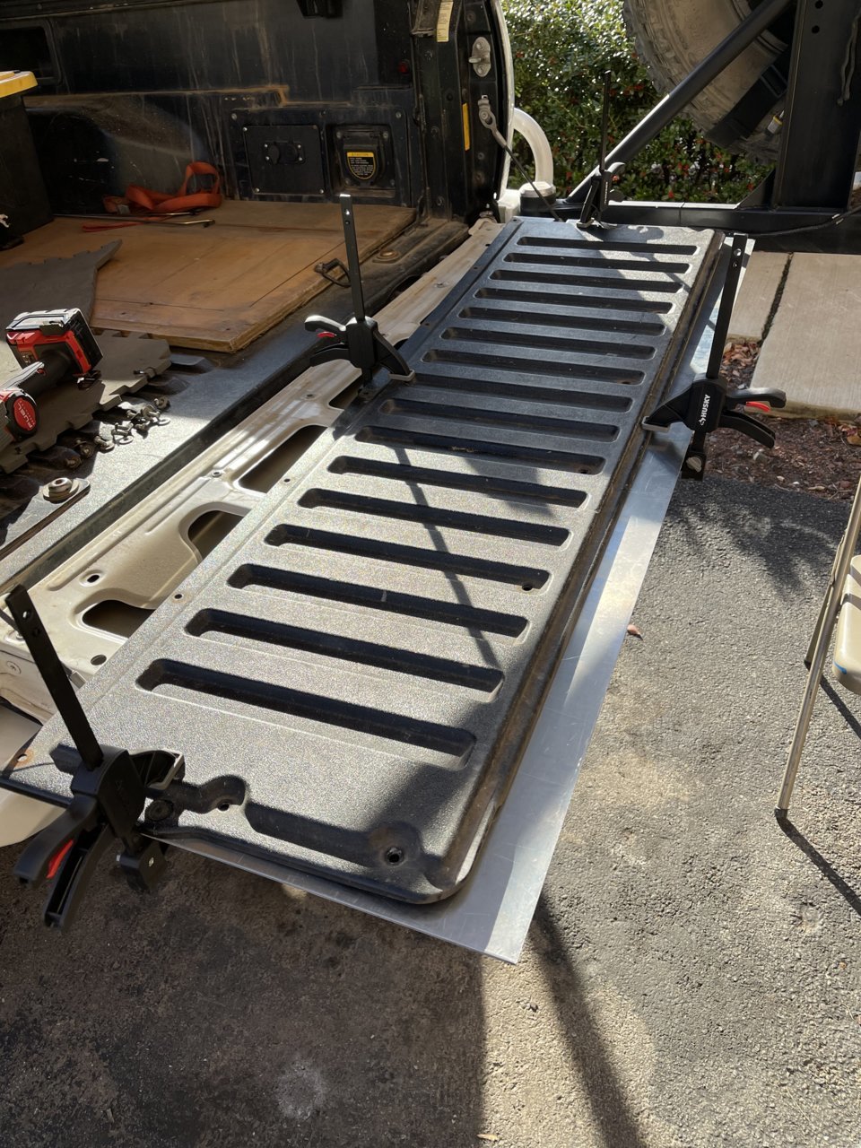

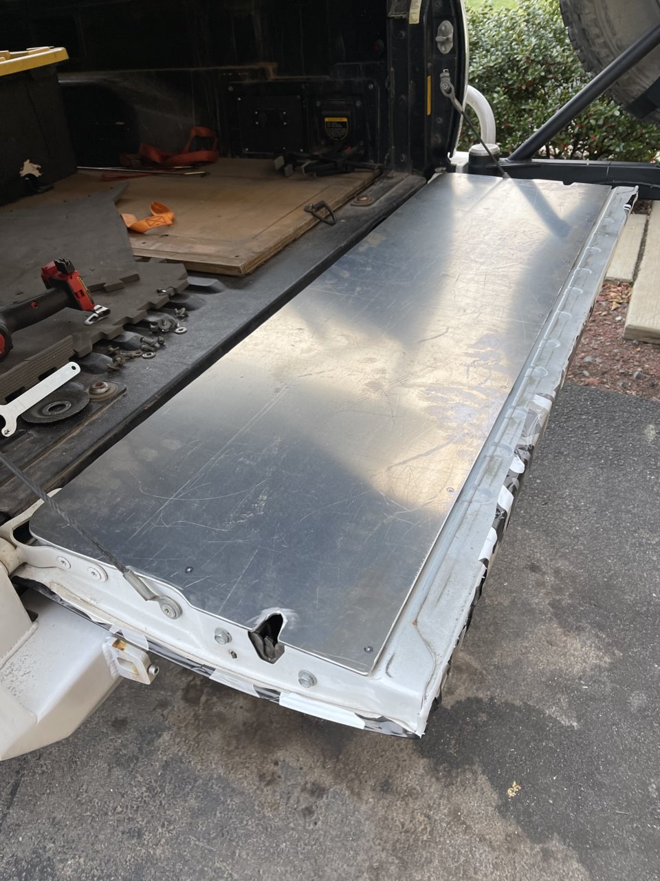

    i finally made my own from 1/8" aluminum.
    added washers too, but no picture
