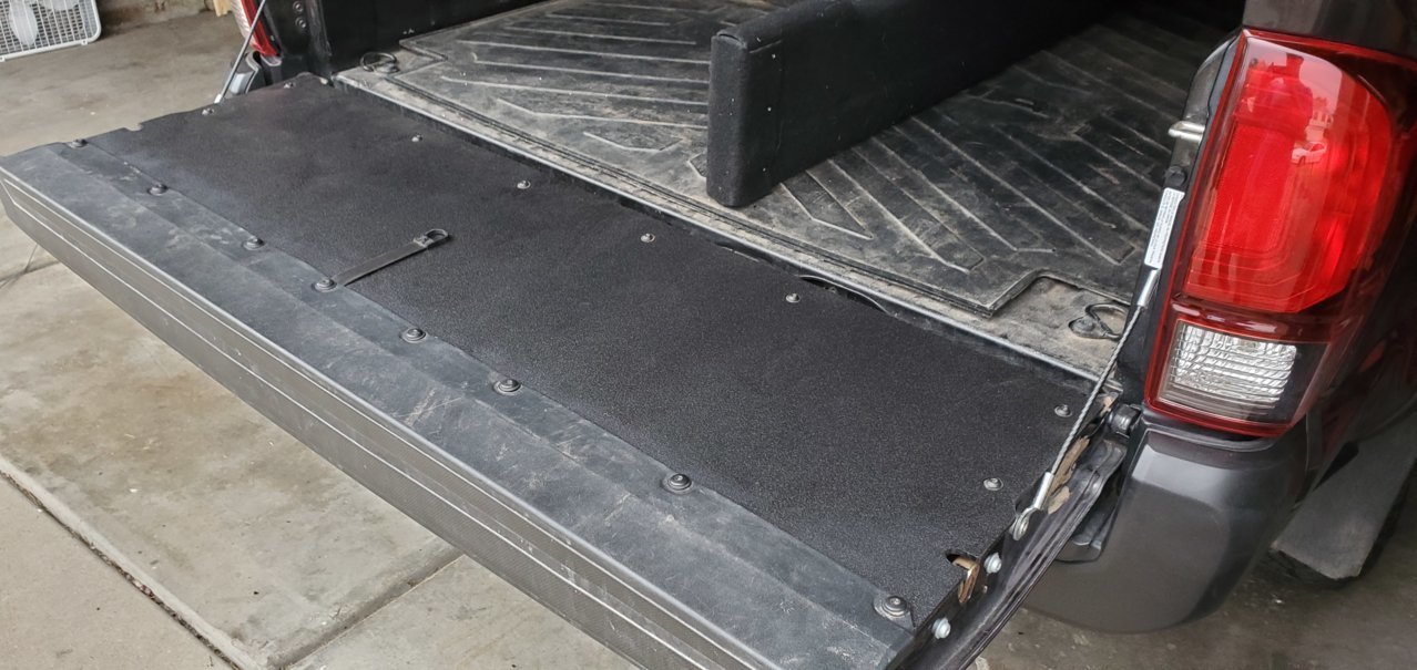

    Made mine out of 1/4” ABS (might be 1/8” cant remember right now) jigsaw and bingo. BDC75BA2-8C87-4344-8A8C-F1A36FBE09A0.jpg

    The original CAD drawing was reduced to make the 2D view in my TW photo album. We used a water jet to cut it out of 1/8 aluminum diamond plate and I beveled the edges slightly with a mill file. The thinner material avoided some problems on the lower edge.
    When installing, I took measurements of the internal stamping to locate and then added a center row of fasteners. Dunno that it added much to the assembly, but made me feel better. I haven't managed to bend it yet.
