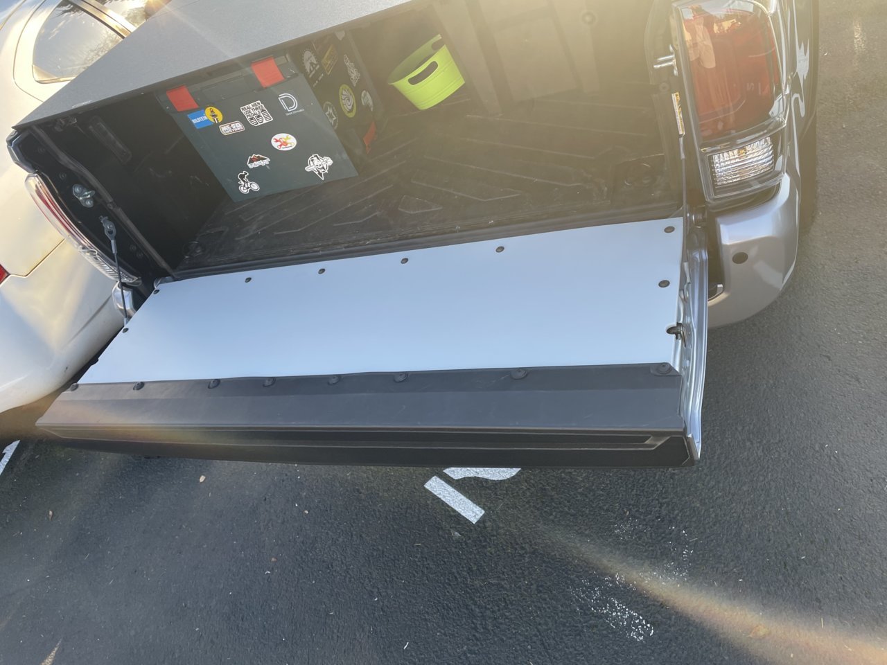

    Not the best photo but it fit like a glove and looks nice. Be aware if you have any kind of tailgate sealing or weatherstripping like I do, it fits super, super tight. I had to adjust the latch loops on the sides of the bed to get it to close and latch without having to slam it shut and it feeling over-tight when opening. Light Grey is very light but I like it as it makes anything set on the gate easier to see. It would be nice if it was routed thin at the bottom to accommodate for the bump at the bottom of my 2020 tailgate. Bad thing is that with this bump and it not being thinner is it takes away from having more "meat" for the lower smaller screws to be able to grab when tightening down. Other than that, the seller was super cool and quick to respond. The price was great and the shipping costs weren't bad at all. I'll continue to monitor and keep updating as to how it works out over time. Concerning the OEM tailgate lock, super easy and worthwhile mod. Feel free to ask if you have any questions....

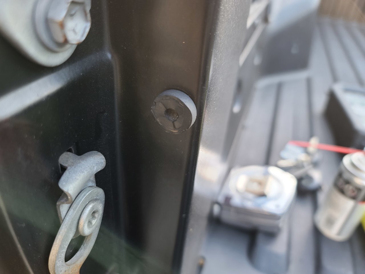

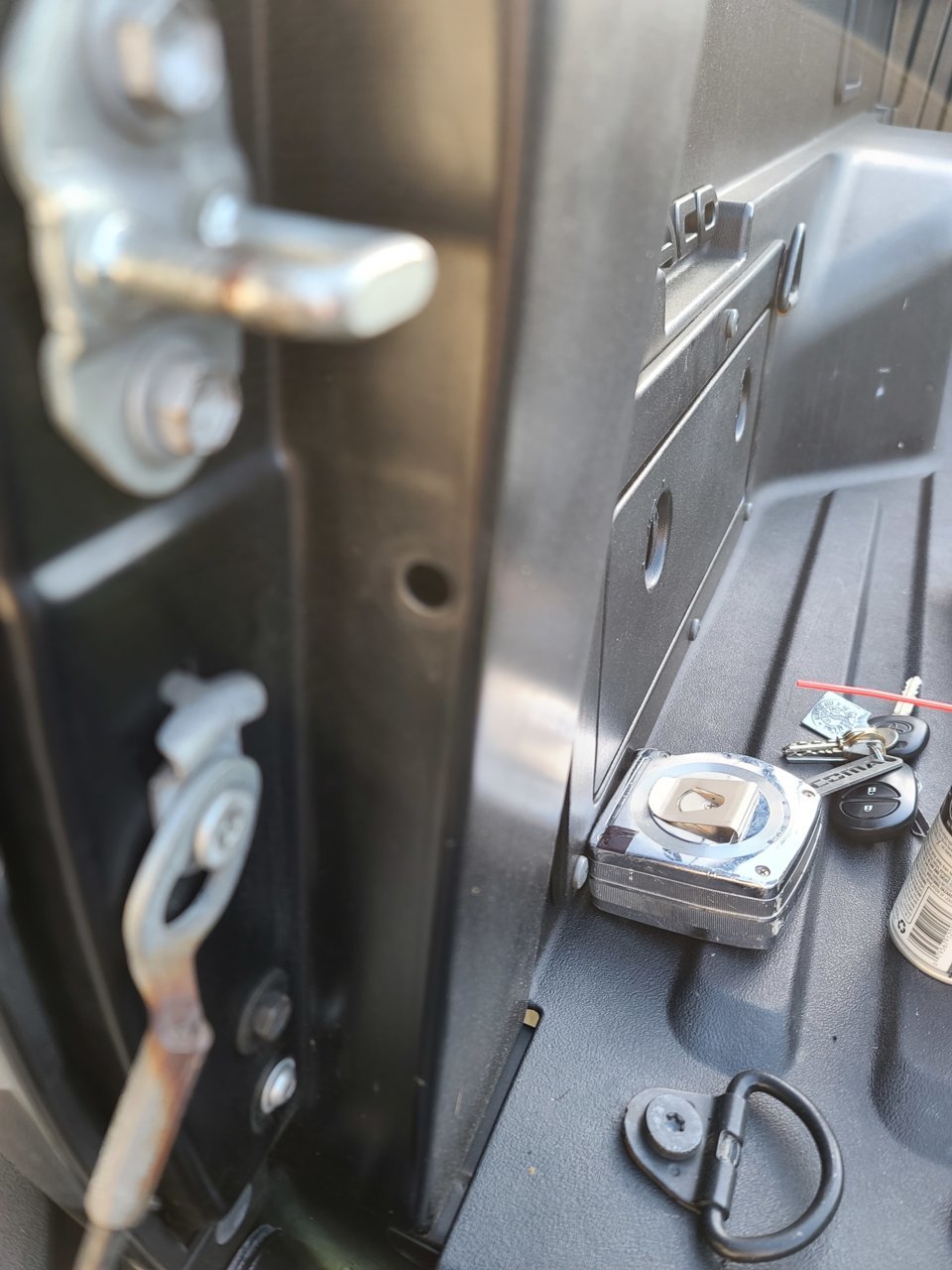

    PXL_20210311_210701540.jpg Hooke Road. Amazon. When I bought it a week ago it was 120 all in. Worked great. Just removed the bumpers and threw in some panel clipsPXL_20210311_210654811.jpg PXL_20210311_210706727.jpg

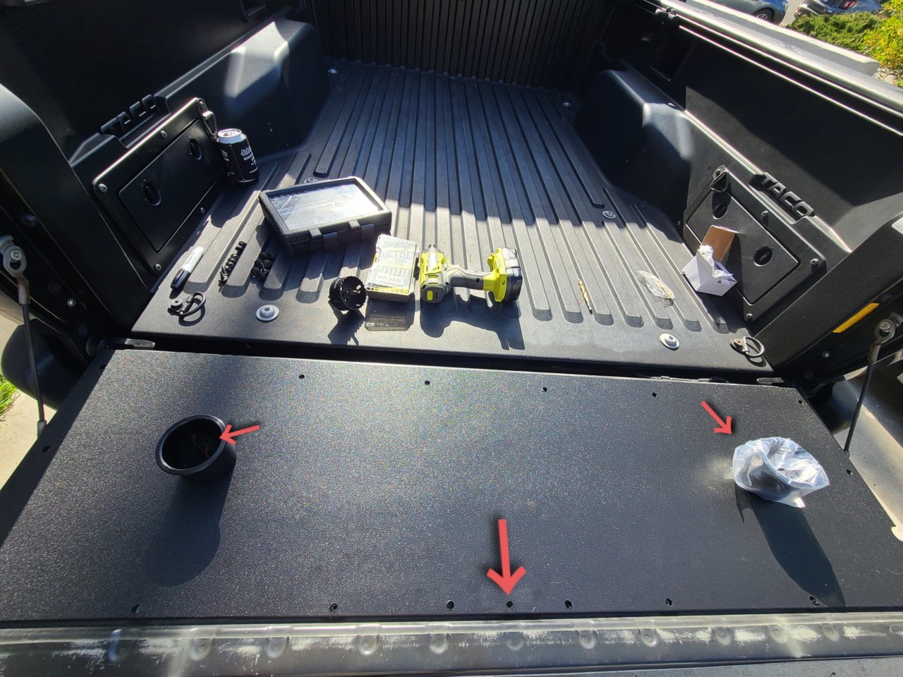

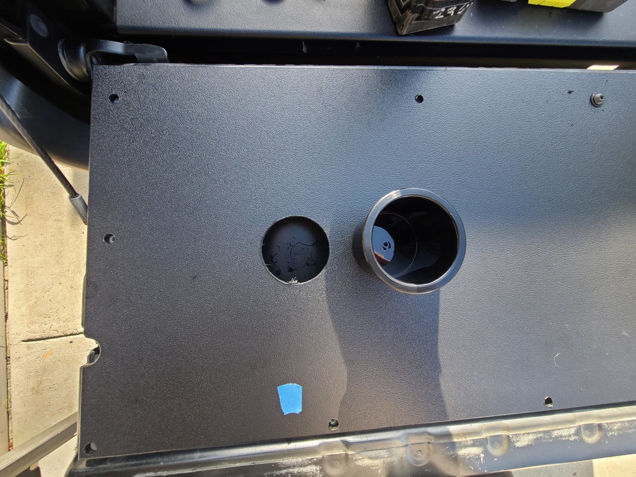

    Got it and getting ready to cut the cupholder holes, just waiting for my dead battery pack to charge.
    Good quality so far and super nice guy, I would definitely recommend him. I only have one discrepancy and it's really not a big deal. I had to redrill the screw holes because they were off or not done at all. No biggie.
    I'll post the finished product when it's all done.

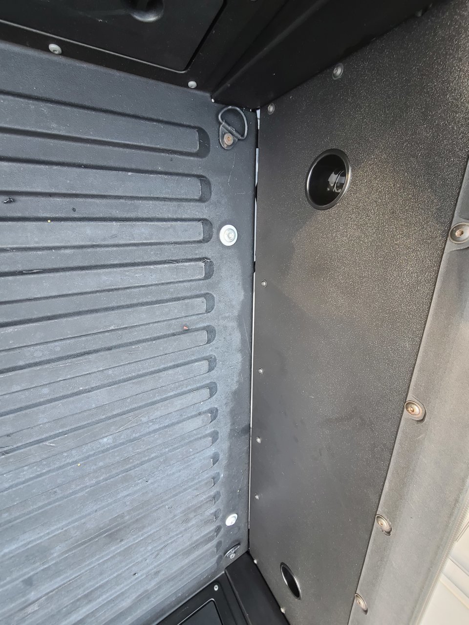

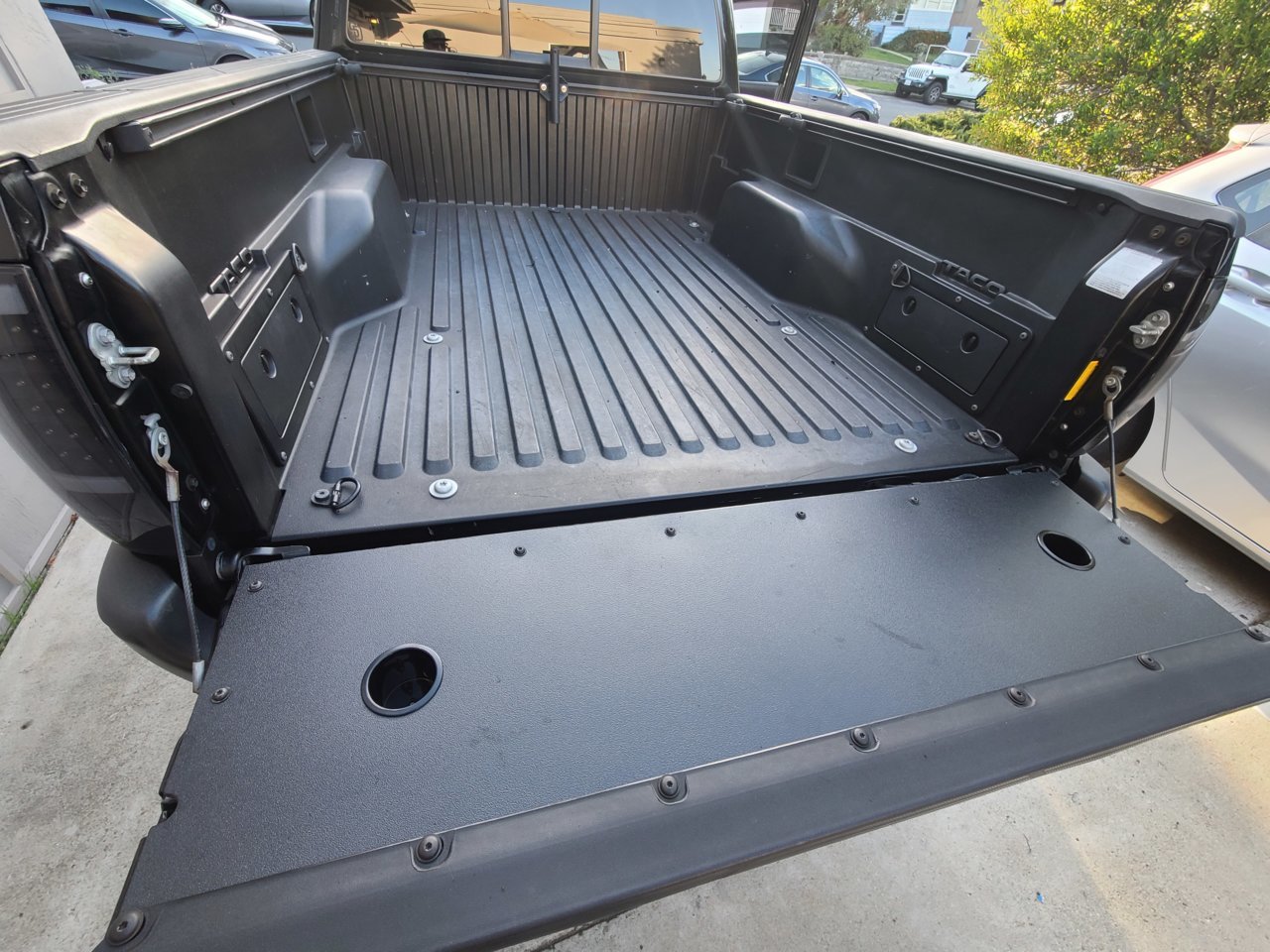

    Got it all in, cups and all. Everything fit pretty well.
    I had one fitment issue though. The little rubber stoppers were making a full lock struggle a bit. I just trimmed them down and actually closes better than before lol.
    I also see that the insert left a bigger gap at the bottom. Not a big deal for me, I figure the bed might drain better now. :burp:
    Overall, I'm super happy with it :thumbsup:
