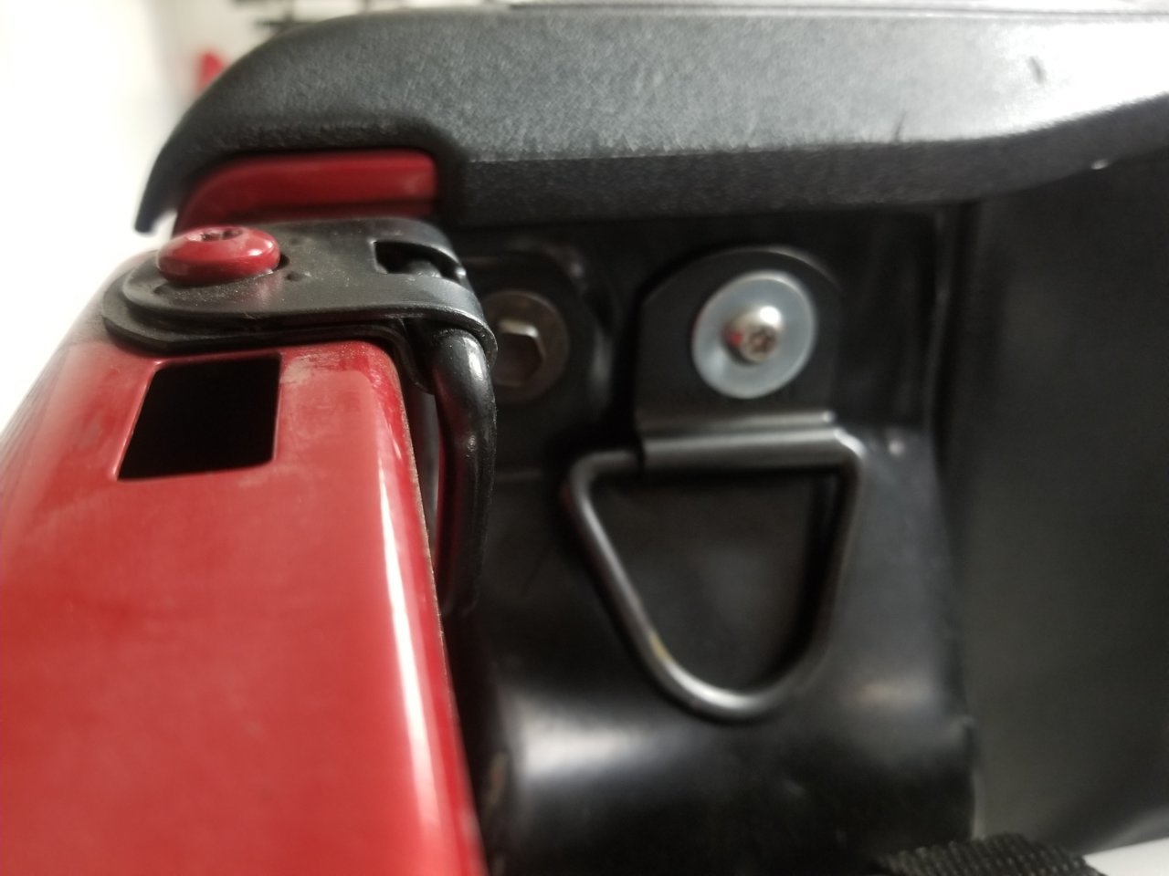

    I already have both the clamp and washer mod on the tailgate but didn't like that the tailgate could still be opened so I bought some d-rings from Amazon and just started messing with it.
    Items needed:
    Torx T30
    10mm socket
    Ruler
    Dremel
    D-rings ×4 (4 V-Ring Tie Down Anchors from Amazon $13.99)

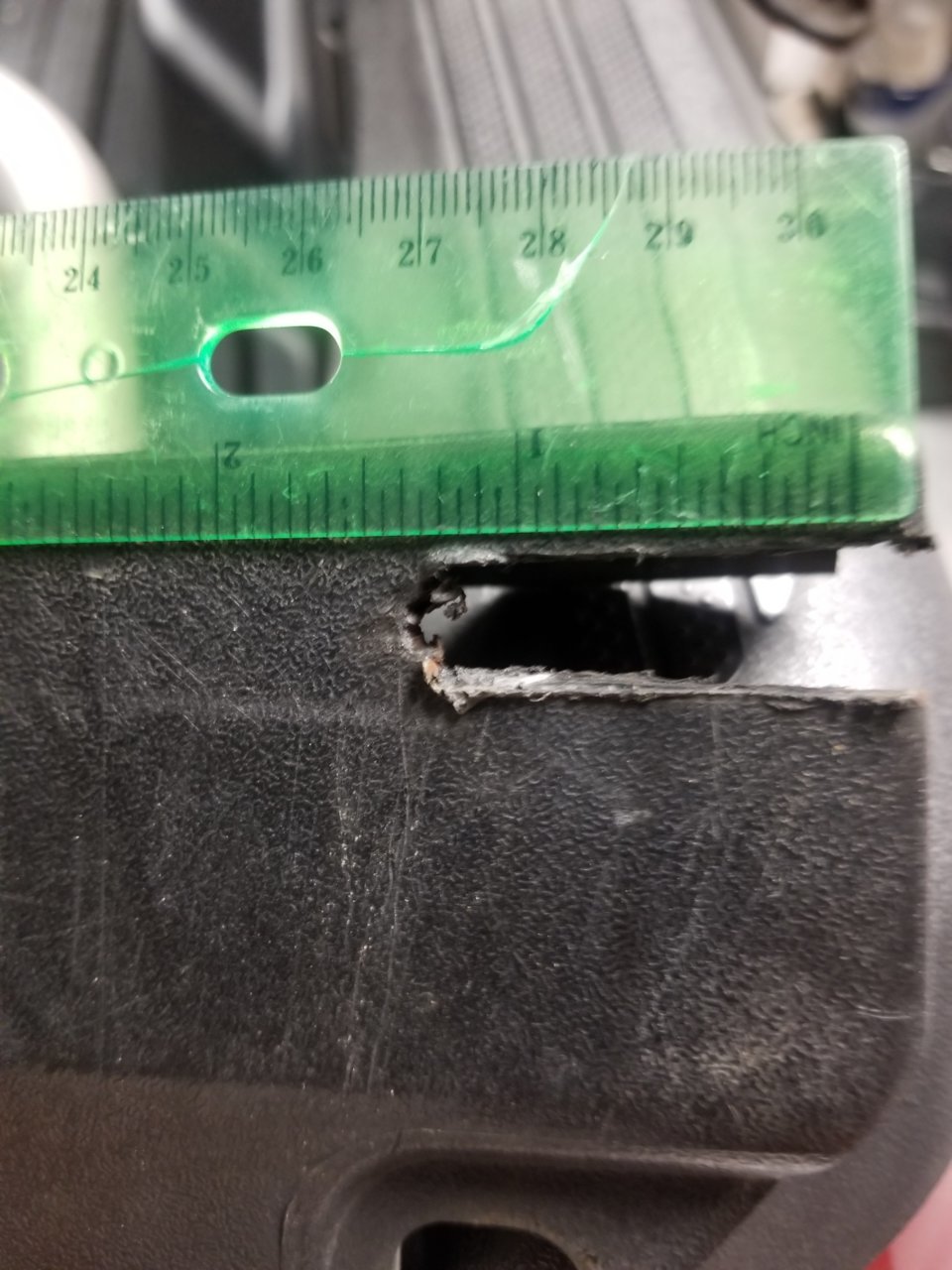

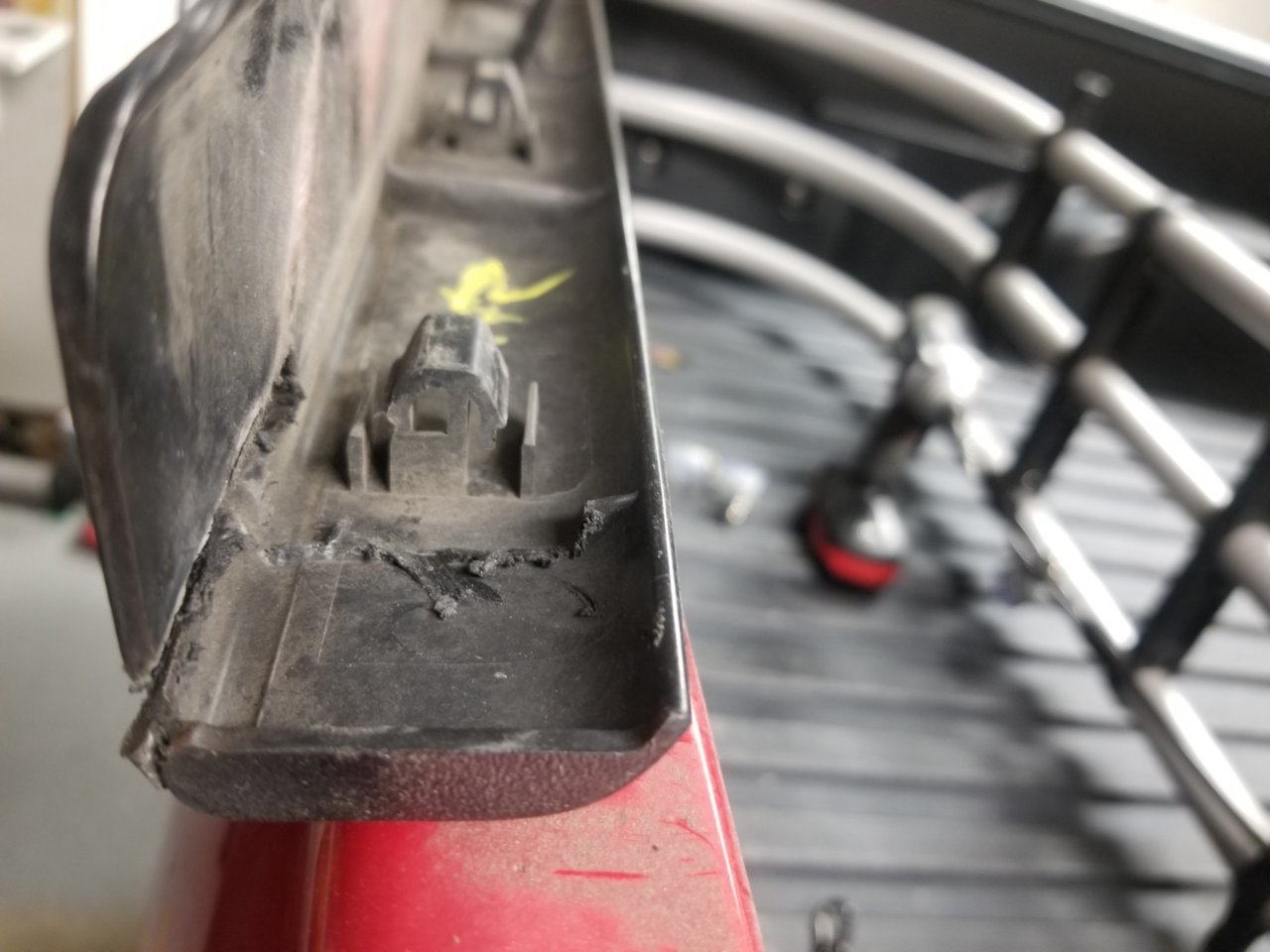

    First I unscrewed the 7 T30 screws holding the top tailgate cover. Once that's off unscrew the T30 screw on each side, insert a d-ring. Make sure they sit flush before retightening.

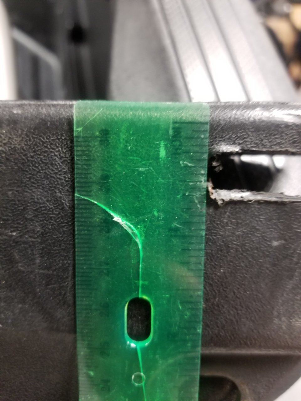

    Then I made the measurements and cut away.
    Make sure you trim the inner divider because the cover will not go back on properly if not trimmed.
    Once that's finished slide one side in and slightly bend the middle of the cover in order to slide the other side in. Be careful not to break any of the clips under the cover. Screw all 7 of the T30 screws after.

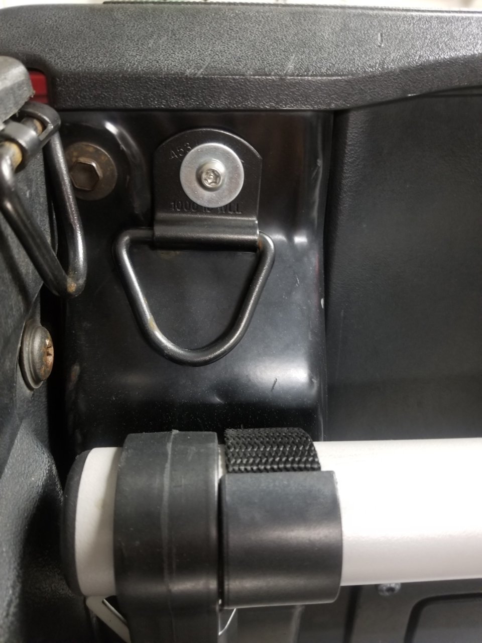

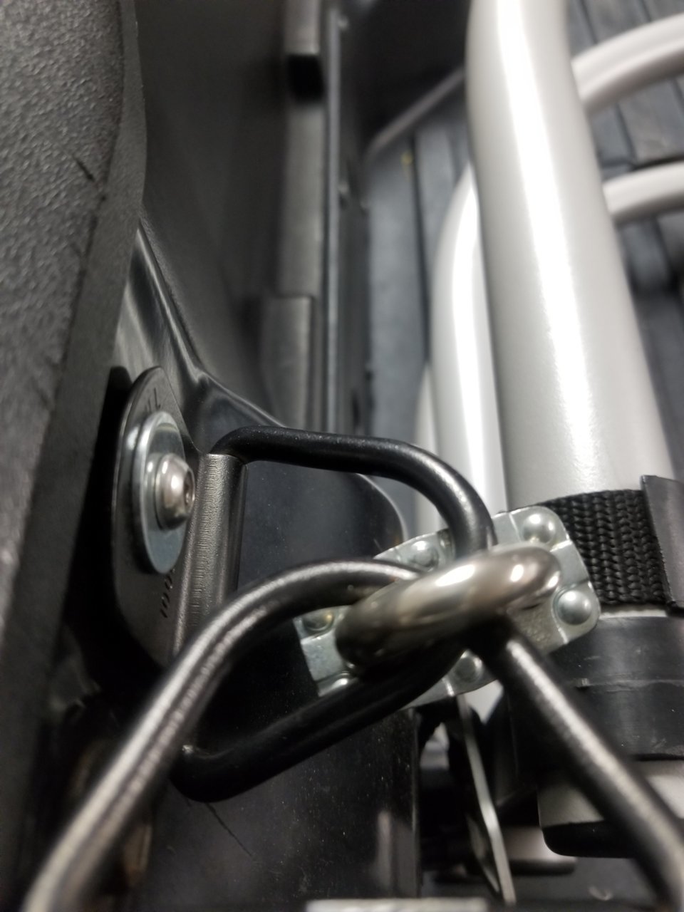

    Take your 10mm socket and unscrew the socket on the right. You can either reuse the 10mm screw with the d-ring like I did before til someone mentioned how easy it was to unscrew so I used some security screws (I think they're M6) that I used for my license plate before.
    I ended up doing this on both sides so now my tailgate is secured tight with little to no play.

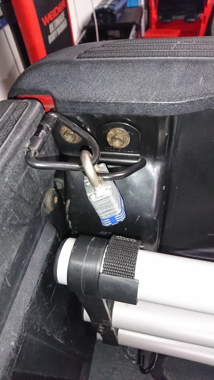

    2011 Sequoia 4x4 2022 SR 4x4
    My old setup with the 10mm screw
