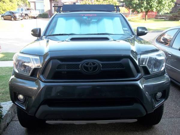

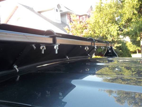

    So I found a Thule 400XT Foot pack with 58" load bars on Craigslist for $100. I bought the proper fit kit (2160). I wanted a wind fairing, especially after driving 3 days without one and being SUPER annoyed by the wind noise. I heard that if you wrap paracord (or something similar) around the load bars, with about 1" spacing between the loops, that it eliminates almost all the wind noise. I did that as a temporary fix and it DID WORK!!! But I still wanted a fairing. I'm old school and like the old style Thule 555 fairing over the new "snowboard" style 872XT fairing. I found a DIY article on the net, on an Audi forum of all places, and this is what I made. Let me know what you guys think.
    FYI...total cost, not including the stuff I already had in the garage (i.e. spray paint, aluminum strip metal, plastic door trim and EPDM foam weather striping) it cost me about $35 dollars to make. Also, I realize that due to my design that the fairing sits higher then the load bars and restricts any accessories being added on, but that's why I used wing nuts for the mounts. So, I can take it off easily when needed. I'm gonna work on fixing this design flaw over the weekend or 4th of July Holiday. Also, I have a Thule 8"x2" decal on its way in the mail to add to the fairing. I ordered a silver one though, not a white one.
    Here's the pics

    Looks good! The only thing I'd be worried about is dirt and whatnot getting under it and rubbing into the clear coat. But, all in all it looks really good.

    Good call, another aspect to take into account when I redesign the brackets this weekend. probably just gonna bend them up a little more so it sits about 3/4 of an inch above the roof and the EPDM foam and plastic door trim run along the bottom will be my backup protection from scratches. Of course, I'm also strongly considering having my roof wrapped in flat black vinyl. So that would eliminate the need for redesign, lol.

    Find a Thule dealer near you and buy the loadbar brackets and hardware. You invert the brackets to capture the struts under the loadbar. Your design is on par with the old Thule fairing. Take care in tightening the fairing to the struts (I can see some deflection in the photos). We used to include soft foam washers to ensure a good attachment while trying to prevent cracking the polycarb fairing.
    Looks pretty good!!

    Looks good! My only thought is that the bolt on the lower side of the fairing is rather close to the paint. Could you shorten it up and put a cap on it?

    Not as close at it looks, trust me. Eben with me pushing on the fairing it wont touch the roof. None the less, I'm getting shorter bolts this weekend

    The original logos were silk screened on: came off with a couple of applications of Windex which drove folks crazy. The thing to keep in mind with polycarbonate is that it scratches and cracks very easily...especially when cold. folks would crack an end off when dusting off snow in the winter.
    Bottomline: you did it on a budget and solved your noise problem. Enjoy the quiet!!

    And, I made it from lexan. So, it's pretty flexible and forgiving as well.
