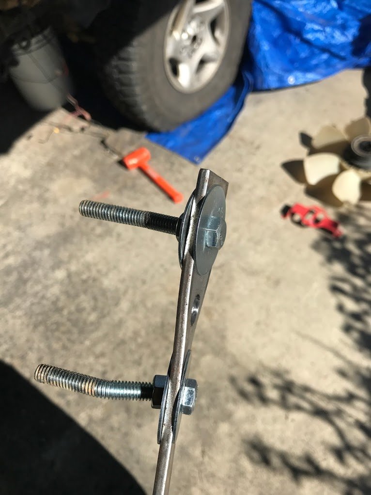

    It wasn't that bad. I was hesitant at first, too. I tried using my air impact driver, but it wouldn't budge. I just used my breaker bar and disconnected the ignition so it wouldn't actually start, then bumped the starter - came right off.
    Putting it back on at the end I used a tool I made out of some 3/16" flat bar and a piece of L bracket and some grade 8 hardware (a long piece and a short piece so it looks like a "y" with long grade 8 bolts in the ends to fit in the pulley holes but still clear for the socket). I ended up bending it, so I used steel L bracket instead for the whole thing. The long piece was long enough to touch the ground, then I could use both hands on the torque wrench to get that elevendy billion ft-lbs of torque.

    I did something similar for the pully bolt. I should have gone out and bought some grade 8 stuff. I bent the bolts when re-tightening. It's currently living as a grabber under my camper shell. It's soon to become new brackets for my skid plates.

    2 drill bits stuck in the holes in the face of the pulley and a piece of square tubing wedged between them helped me get my bolt out. The drill bits don't bend like bolts can.

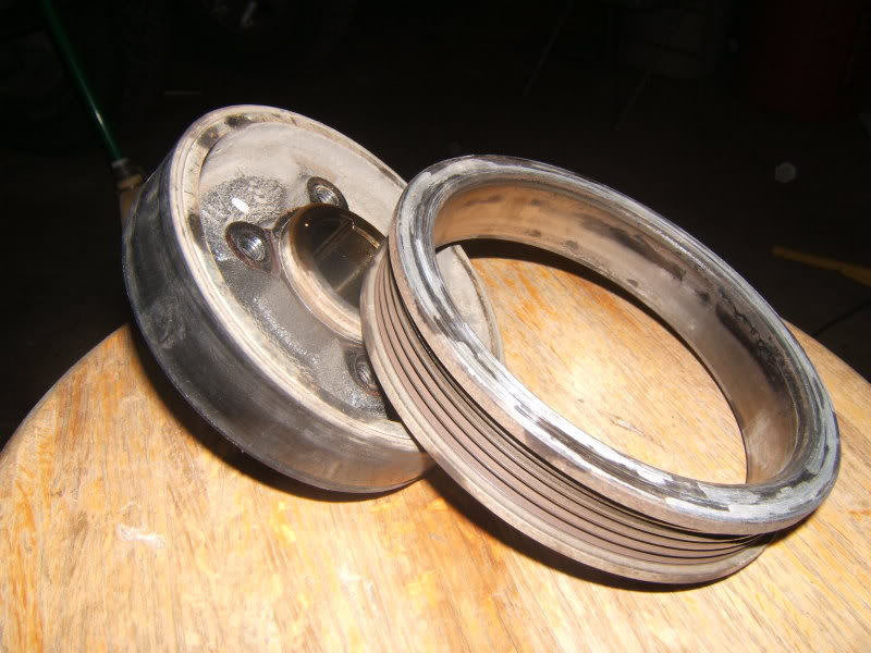

    Holding the pulley via the outside with a strap wrench, chain wrench or any other improvised method is a no no. The pulley itself is only secured to the hub with a rubber isolator. This rubber can be torn/stressed.
    No matter how many folks have success with the "bump the starter" or strap wrenches, the chance for damage is always there.
    Worst case scenario.
