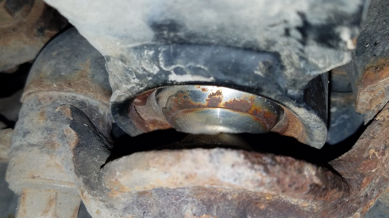

    Symptoms: Excess play in the cup/ spacer assembly. Groaning/ popping/ screeching/ grinding/ squeaking over bumps and turns while moving and at a stop. Often times the sound will cease if you remove the load from the uni ball. (Jack the truck up and turn the wheels). Additionally, check your uniballs for any pitting, rust, dirt or rocks. If there is any severity of damage to these components it is recommended to replace them.

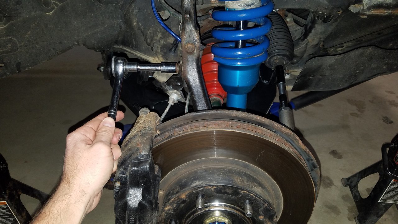

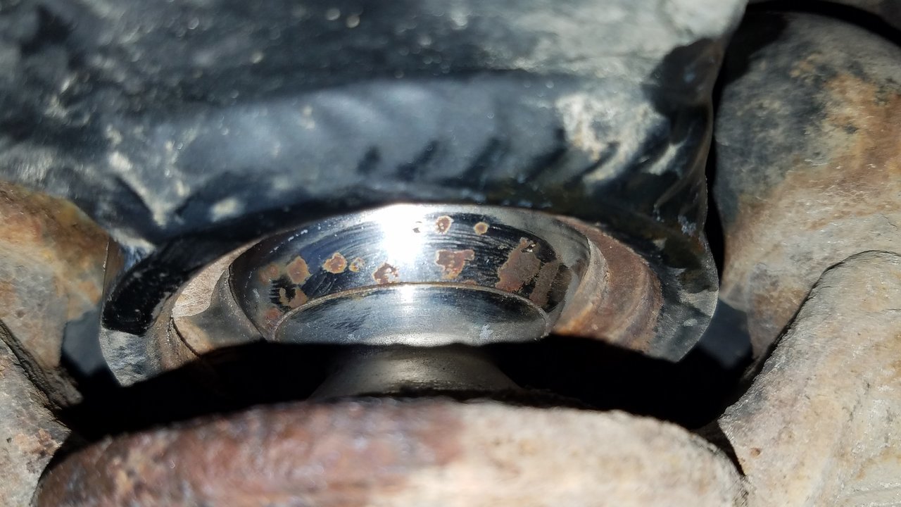

    Expected life span: Mine went after 15k miles; 6k of which was in the Eastern salt belt in upstate NY. Those 15k miles included harsh driving conditions, off roading and plenty of high way miles. From what I have noted across forums; the expected life span is anywhere from 10-25k miles, but there are plenty of cases that fall well above and a few bellow this figure.

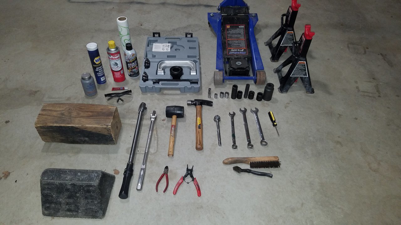

    Resources:
    1) Torque Guide Here: Thanks to @Benson X
    2) Other How To: Tools:
    - Jack
    - Jack Stands
    - Chock Blocks
    - Eye Pro
    - Gloves
    - Ball Joint Press
    - BJ Press Master Adapter Set OR some Sockets
    - 200lb Torque Wrench
    - Breaker Bar
    - Rubber Mallet
    - Ball Pein Hammer
    - Snap Ring Grips/ Needle Nose pliers
    - Cutting Pliers
    - Wire Brush
    - Anti- seize
    - PB Blaster
    - Lock Tite- Red
    - Brake Cleaner
    - Towels/ Rags
    - Bungee Chords
    - Cheater Bar (Recommended)
    - Wrenches: 17mm, 19mm (others if needed**)
    - Sockets: 10mm, 12mm, 17mm, 18mm, 19mm, 21mm, 22mm, 24mm and 35mm. (others if needed**)
    ** Some sizes may be specific to my set up. This is a general list of what is required.

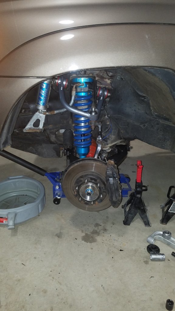

    3. Engage 4WD, leave key in ignition (truck off- prevents steering wheel lock) raise one side of truck- opposing tire resting on the ground. Confirm jack points are solid- Remove tire.

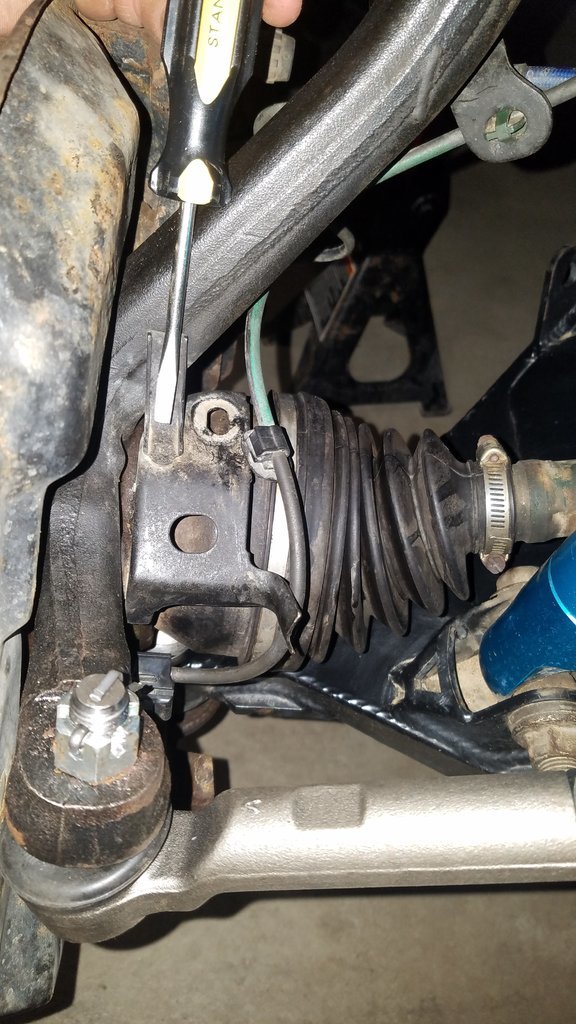

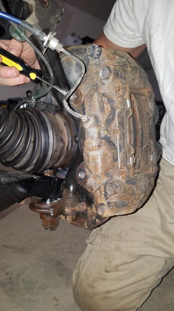

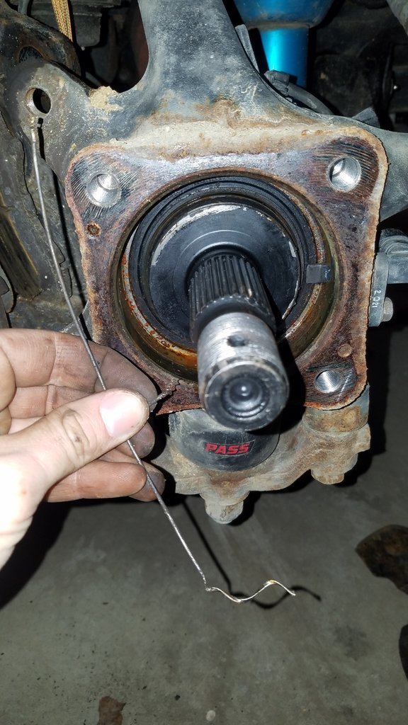

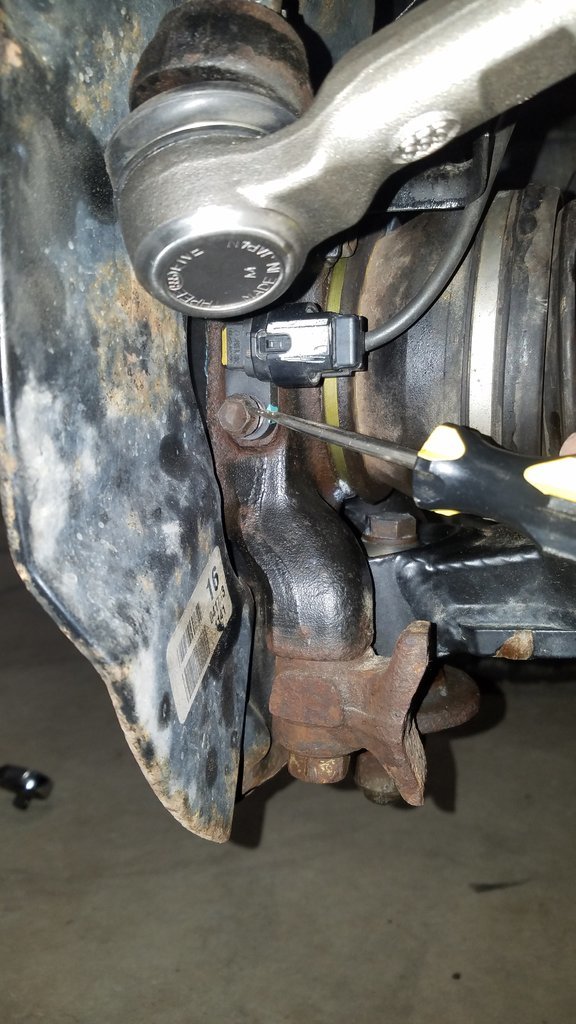

    2. Next you will want to separate the brake and abs lines from the spindle. Use your small sockets to remove the brake line bracket and a flat head screw driver to gentle manipulate the tree cap from the back of the spindle. One free I would recommend removing the speed sensor bolt at this time. (Be very gentle with this- speed sensors are delicate and expensive) Just remove the sensor bolt for now.

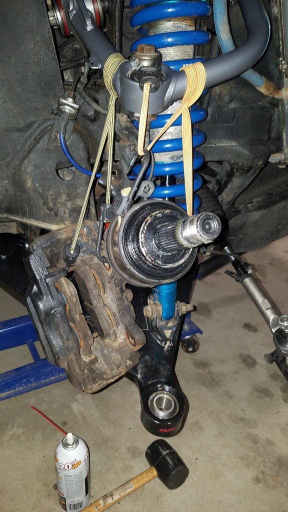

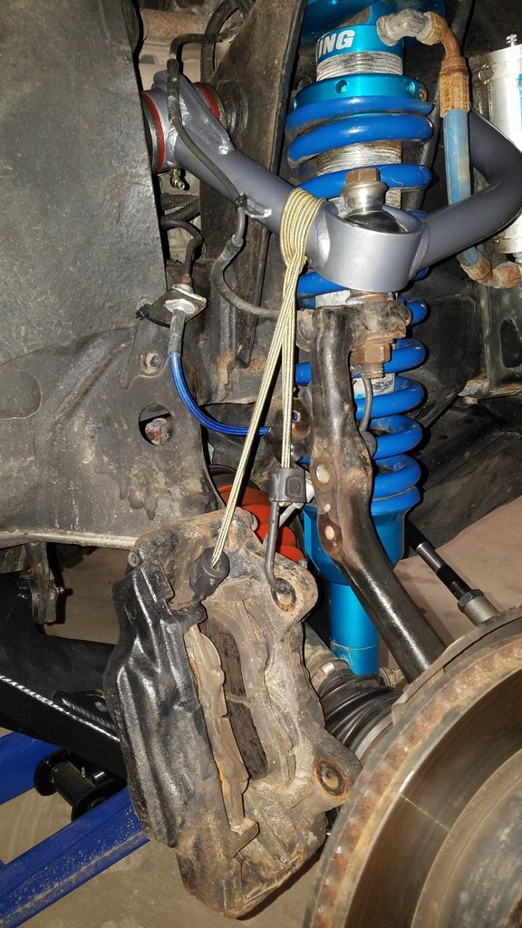

    3. Now you can remove your brake caliper from the rotor. This is done by removing two large bolts from the back of the caliper. I would have bungee chords available to hang the caliper and not bind/ stretch your brake and abs lines. I used a jack stand to rest the caliper away from the CV Axle along with the bungees. This will help you later. Notice the second/ lower caliper bolt has already been removed.

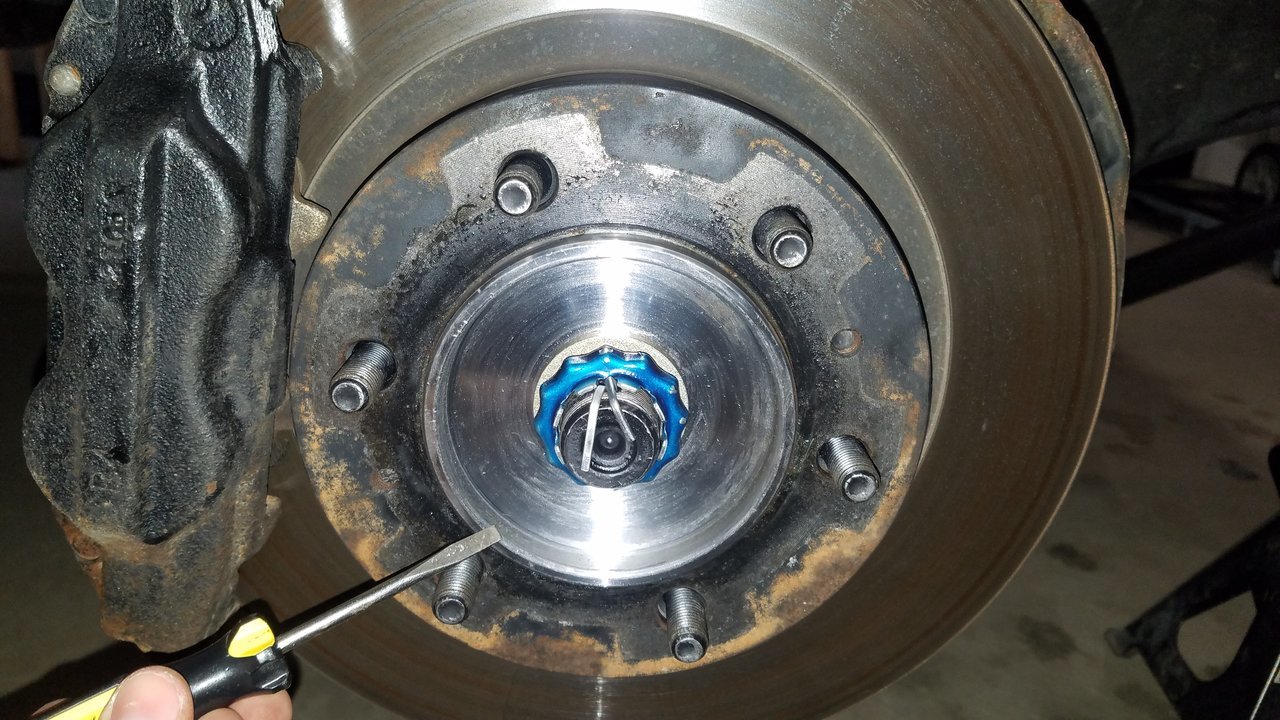

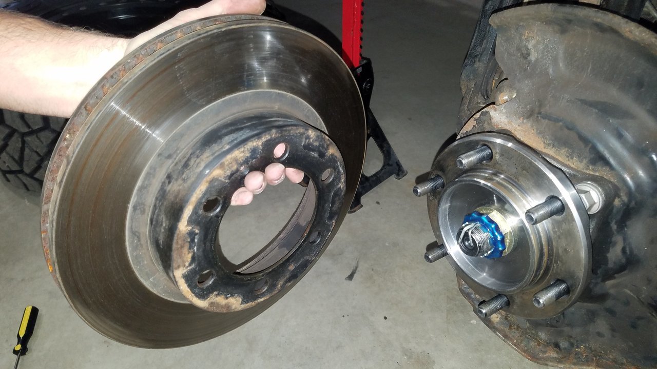

    4. With the brake caliper out of the way you can now remove your rotor. Sometimes these can be seized and require some love. Give it a good whack with your mallet to free it from the hub. Once removed you should see this.

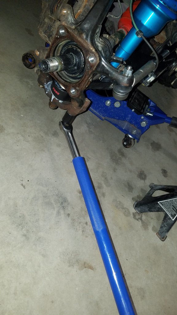

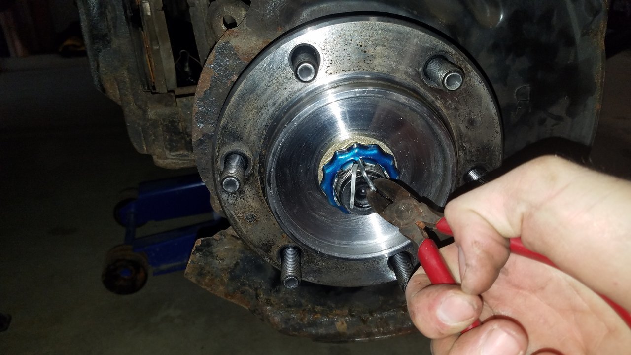

    5. At this point I would recommend breaking the axle nut free. Grab your 35mm socket and a breaker bar. Once the cotter pin is removed with the lock nut go to town. Partial rotation of the hub/ axle is expected (1-3cm) This is why 4WD and the tire are left on the ground. Once it is broke free, spin it to the end of the axle threads. Do not remove it.

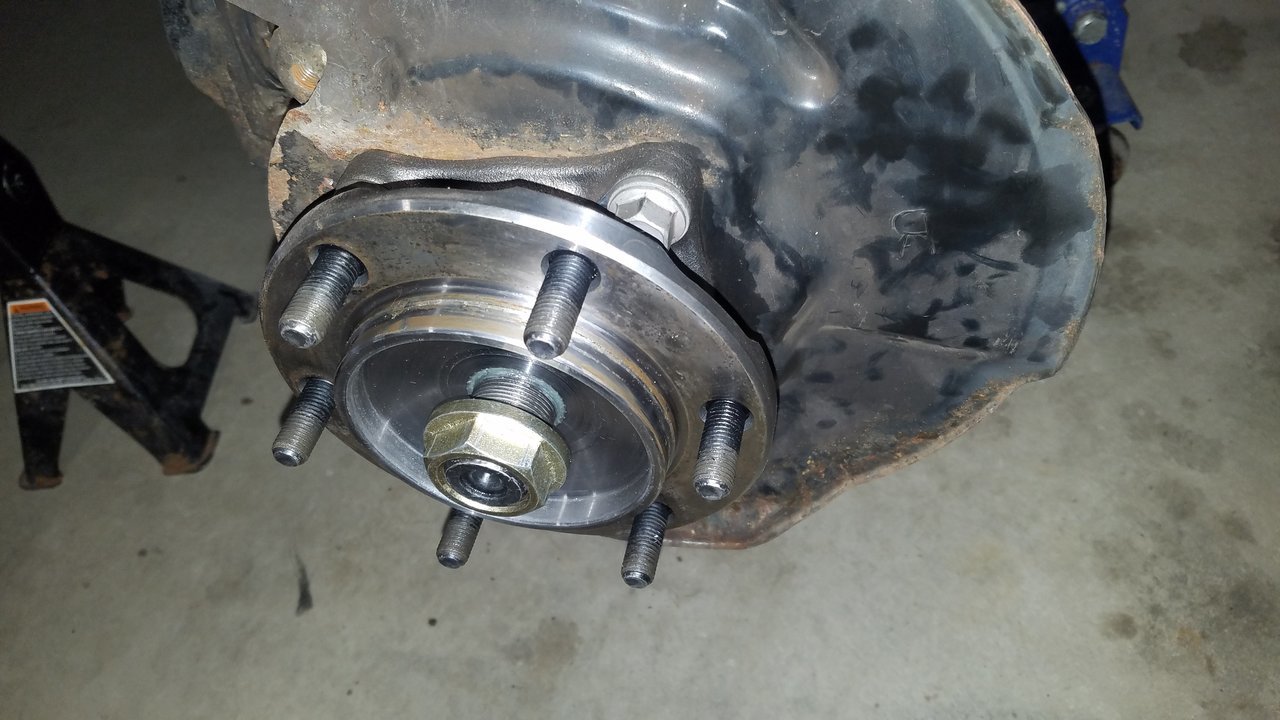

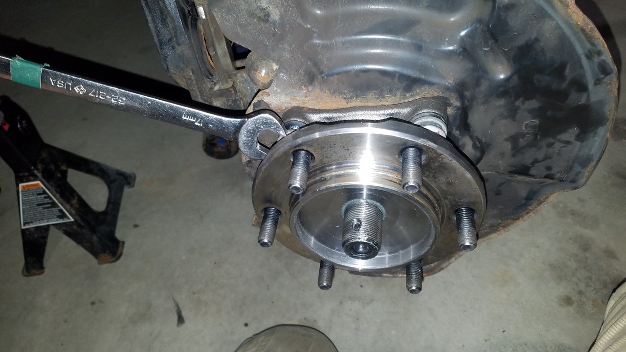

    6. Now you can begin to work on the Four bolts holding the bearing to the spindle. These can be hard to break free so use the wrench with a cheater bar. Be careful not to apply pressure on the oil seal that is pressed into the bearing assembly. This will cause it to flatten and possible destroy the integrity of the seal. The oil seal is a gold ring with a lip. You wont be able to remove the bolts from the assembly. Your only backing them out. Practice partially loosening, then using a flat head to pry under the bearing assembly where it meets the spindle. Work in a clockwise motion and gentle separate the pieces while returning to loosen more thread from the bolts. Its a process but works. Once the bolts are free from the spindle, remove the axle nut and pull the assembly and dust shield away from the spindle.

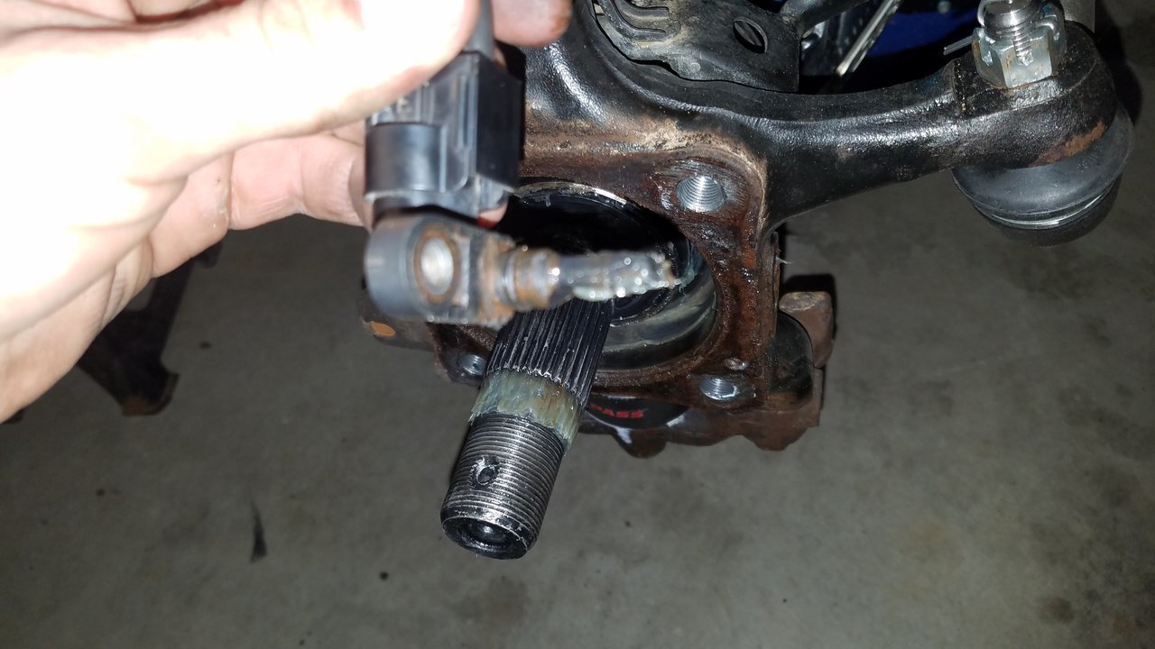

    Note: Now is a good time to remove your speed sensor, gentle wiggle and use a flat head to pry away from the housing. Check your housing for any excess debris, burn marks and broken seals/ bands.

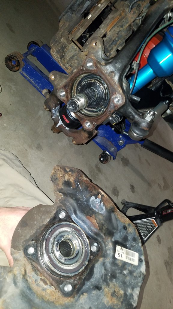

    How to Remove Spindle:

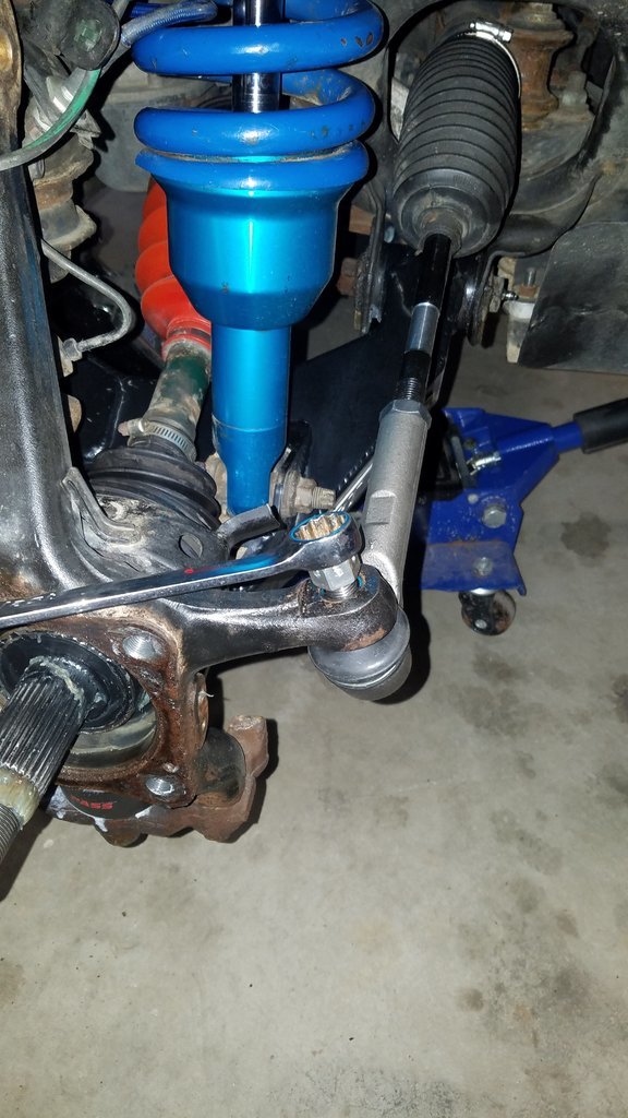

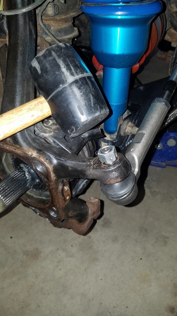

    1. Break your tie rod free of the spindle. Remove cotter pin, remove castle nut, invert castle nut and thread flush with bolt. Hit with hammer until free. Leave in place for the time being. (prevents turning of the spindle)
    2. Break the UCA bolt loose- leave nut at the end of the bolt. [No Pic]
    3. Break the two knuckle bolts loose and remove.
    4. Remove UCA bolt and Tie Rod castle nut. [No Pic]

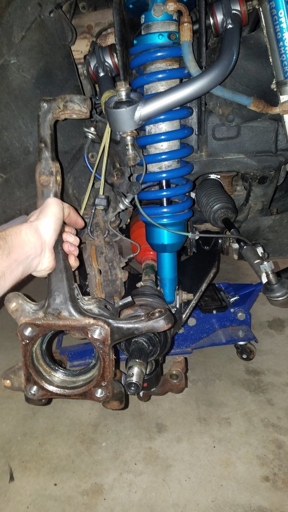

    5. Support your CV axle with one hand and separate the spindle from your UCA, Tie Rod and knuckle. It should easily pull away with minimal force.
    Note: At this point you can break away and clean up your suspension components and wheel assembly. Remove old contaminants, replace seals, wipe down and regrease components for install. Be careful with your CV Axle, ensure nothing is resting on your boots and that its not under pressure. Now is also a good time to hang your axle away from the lower joint.

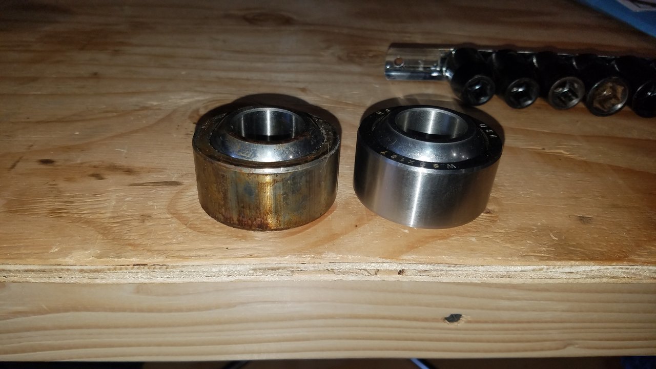

    How to Replace Uniball:
    1. This is best done with a friend, but the talented can pull this off as well. Using two large socket wrenches break the spacer assembly bolt free from the cup of the uniball. This will likely spin easily, so ensure you have a proper hold before applying pressure. [No Pic]

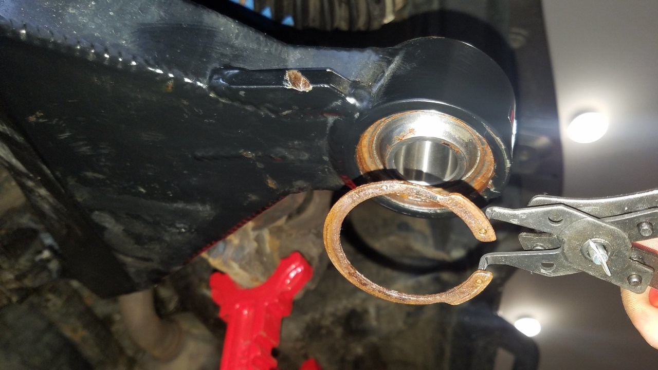

    2. Remove snap ring from under side of cup. This may require a flat head to remove crud away from the edges or to finagle free from the housing.

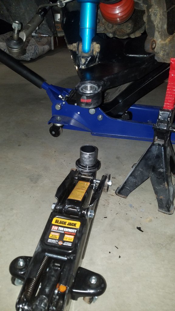

    3. With the snap ring removed, you can proceed to remove the the arm completely, and use a shop press to remove and install your new cups. OR as I did, a ball joint press while the arms stay on the vehicle.
    Note: Using the BJ Press, assuming you have enough space below your arms- you can successfully use the press to torque the cup from the housing by tightening the push rod. If there is not enough space OR your adapters are too large. [ TC/ DK cups are exaclty 2" from outside to outside] you may be able to use a socket to substitute for an adapter. I used a 33mm with success.
    Note2: In the included video: I did not have clearance, so I simply rotated the bearing and used the push rod to apply pressure to break the cup free. [old bearing was trash anyways] As you will see the video shows how much pressure was behind it, due to being seized. I learned my lesson the first side so I saved my floor with the dog bed. Once the cup breaks free it is easily tapped out with a socket and mallet. [Not my proudest moment but here's the shot]

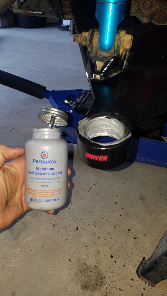

    4. With the cup removed clean out the housing as best as possible. Ensure any grease is removed and apply some anti seize to the inside of the housing. Once complete use your BJ Press or an additional floor jack to push the new cup into the housing. This should be relatively easy. If the cup is resisting or requiring a great deal of force it is likely crooked. Back it out and retry. It should press to the top with the snap ring groove becoming visible from the bottom.
    Warning: Be weary of using the floor jack method. This will cause the Arm to move which could throw your vehicle from its perch and result in harm or damage. Ensure your truck is properly seated at all times while doing this. My 650lb spring was enough to cause minimal movement while pressing the new cup into place.
    5. Wipe any excess Anti seize that has pushed through the housing away, and install the snap ring.

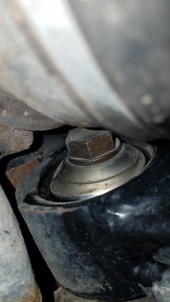

    With Dirt King LCA's you have to remove the spindle in order to gain access to the head of the uniball bolt. Makes things easier pressing the cup in/out as well.
    Here is an image to elaborate the small space.
