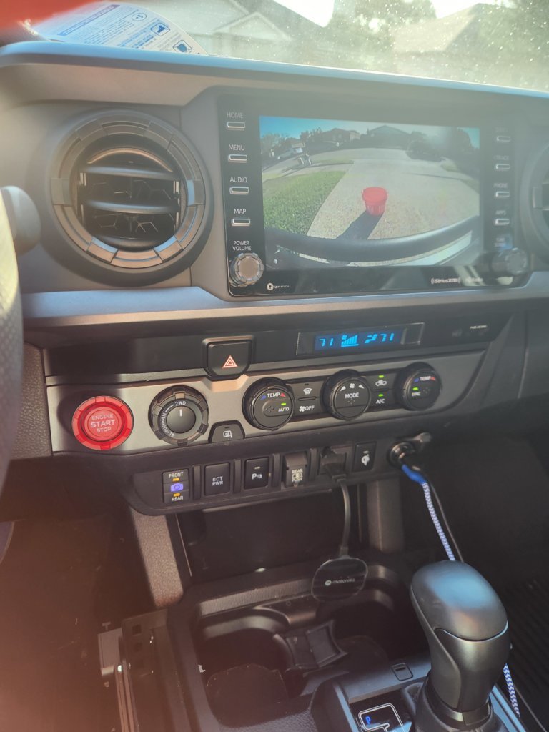

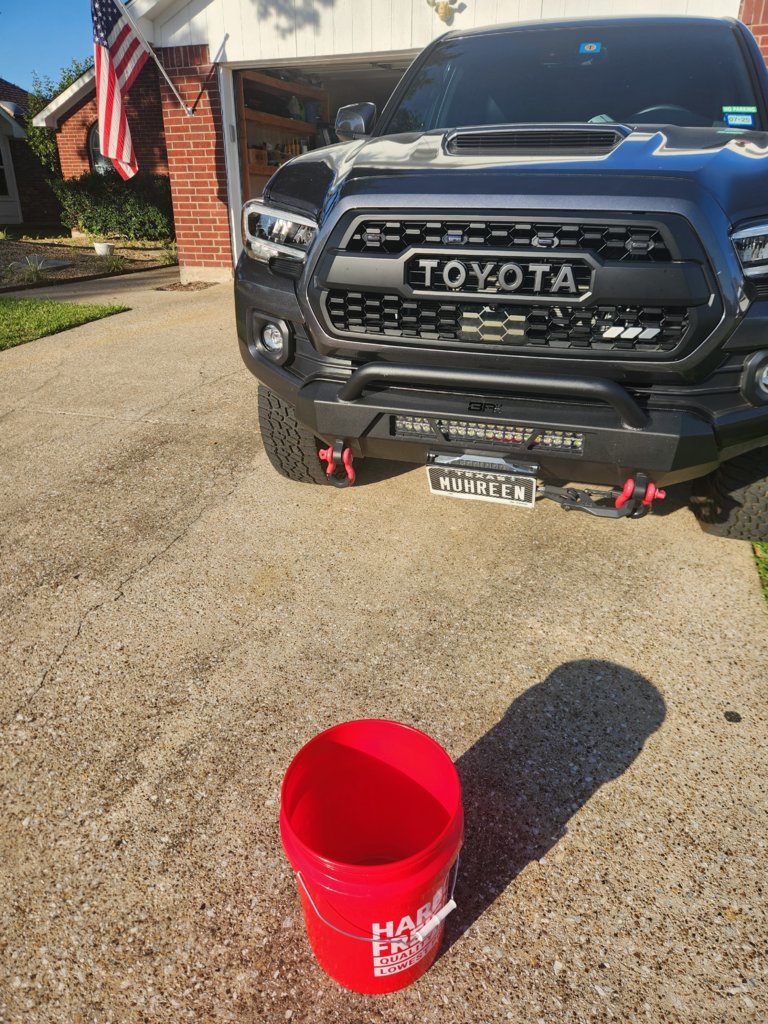

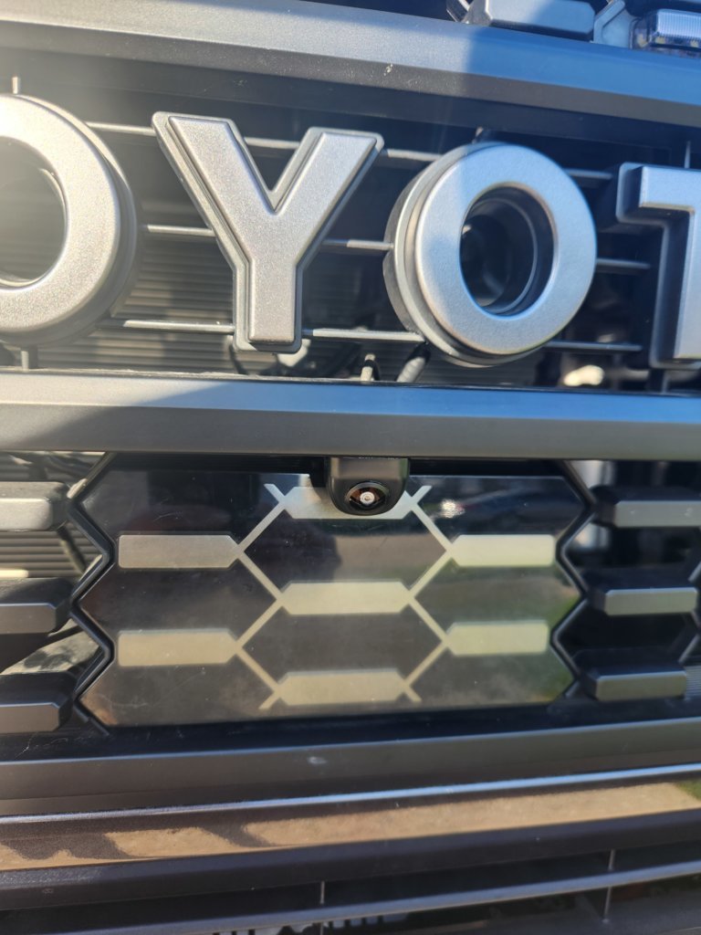

    Installed yesterday. Front camera mounted center and directly above TSS garnish on aftermarket TRD PRO Grill.
    65 miles round trip journey today, utilizing the Dynamic Cruise Control for approx 20 Miles. No issues with TSS.
    Very useful modification.
    Image on screen "appears" closer than reality. Slightly short of 3ft in image.
    Rear Camera works just as expected, using switch or shifting into reverse.

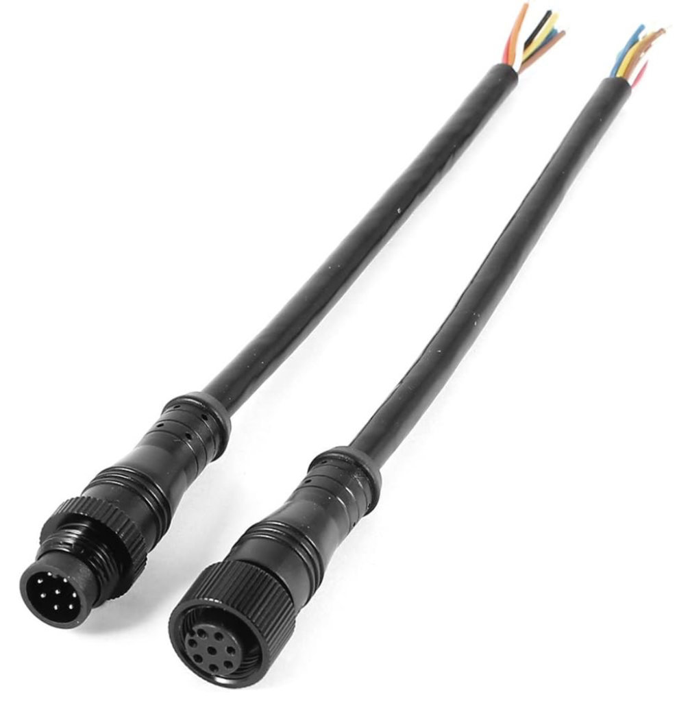

    Hey everyone. If you used the camera in this thread, the way it’s wired is pretty much one way. Start at the grill and run the wire to the cab. Issue is, if you ever need to remove your grill (say to replace the radiator like I just had to do), you either have to cut a notch in your grill to remove the camera bolt or cut the wire and re-attach all 6 thin leads together again when done. I ended up soldering the plug linked below after cutting the wire so that I now have a quick disconnect anytime I need to pull the grill in the future. As mentioned, the camera in this thread has 6 leads and this water proof plug provides you with 8 connections (more than enough, just terminate two of the leads). Just make sure you use individual heat shrinks and then one larger heat shrink to seal it all together. Works wonders once completed. https://www.amazon.com/dp/B007VBSUKS
