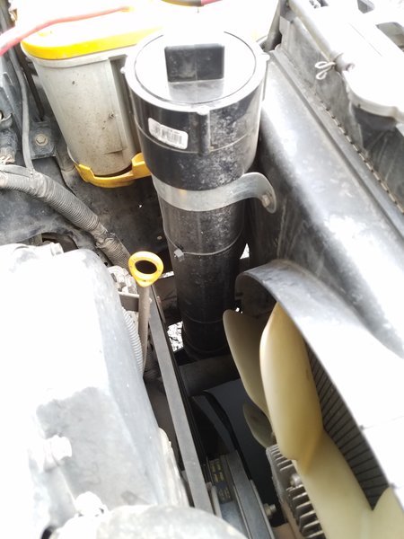

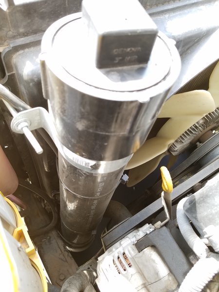

    I made mine out of ABS and retained the factory pump and level sensor.

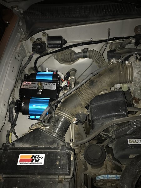

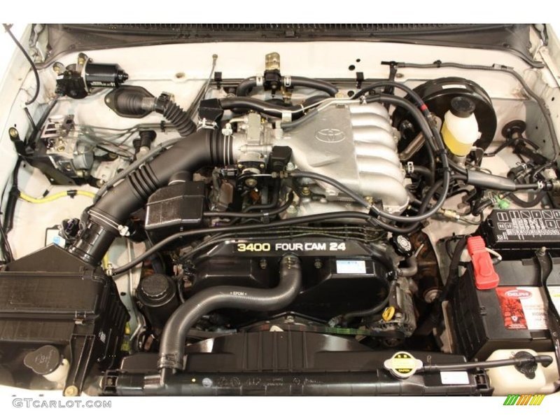

    IMG_0595.jpg @Phessor do you have more pics? I am considering the pvc route because my ARB compressor took up some valuable real estate in my engine bay. Just trying to figure out how to mount it.

    @roosterburm I made mine out of ABS pipe and used a conduit clamp to secure the top and large zip ties for the bottom.
    Level sensor on the bottom and pump on the side.
    I extended the wires and tubing. It has worked great for me and holds almost one gallon.

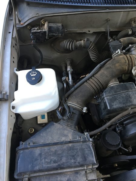

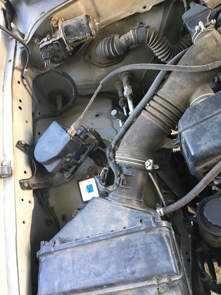

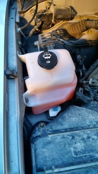

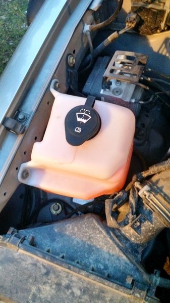

    Just got mine installed tonight, fits great and factory plug in like you said!
    Just got mine installed, direct plug and play!
    Before
    Removed the cruise control (I'm sure this is a cardinal sin to some). I used it once for around 20 seconds on the last 3k mile road trip so it's not a big loss for me. Plus the holes for the reservoir lined up perfectly in that spot aaaand I still have open space for a second battery or arb compressor. Personal preference...
    In and done. Wires ran and plumbed. Works great and looks factory!

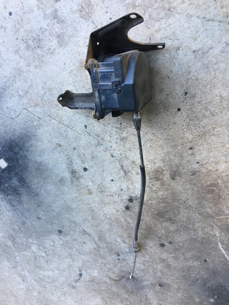

    Where is the go to spot for people relocating the cruise control module? I wanna relocate the reservoir here but also plan to get a second battery back there as well.
