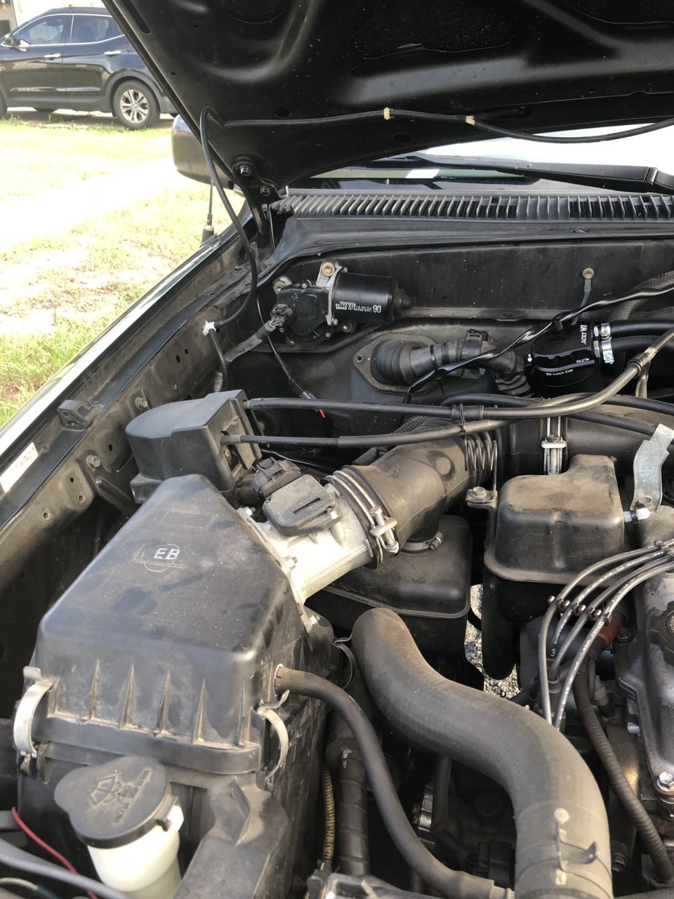

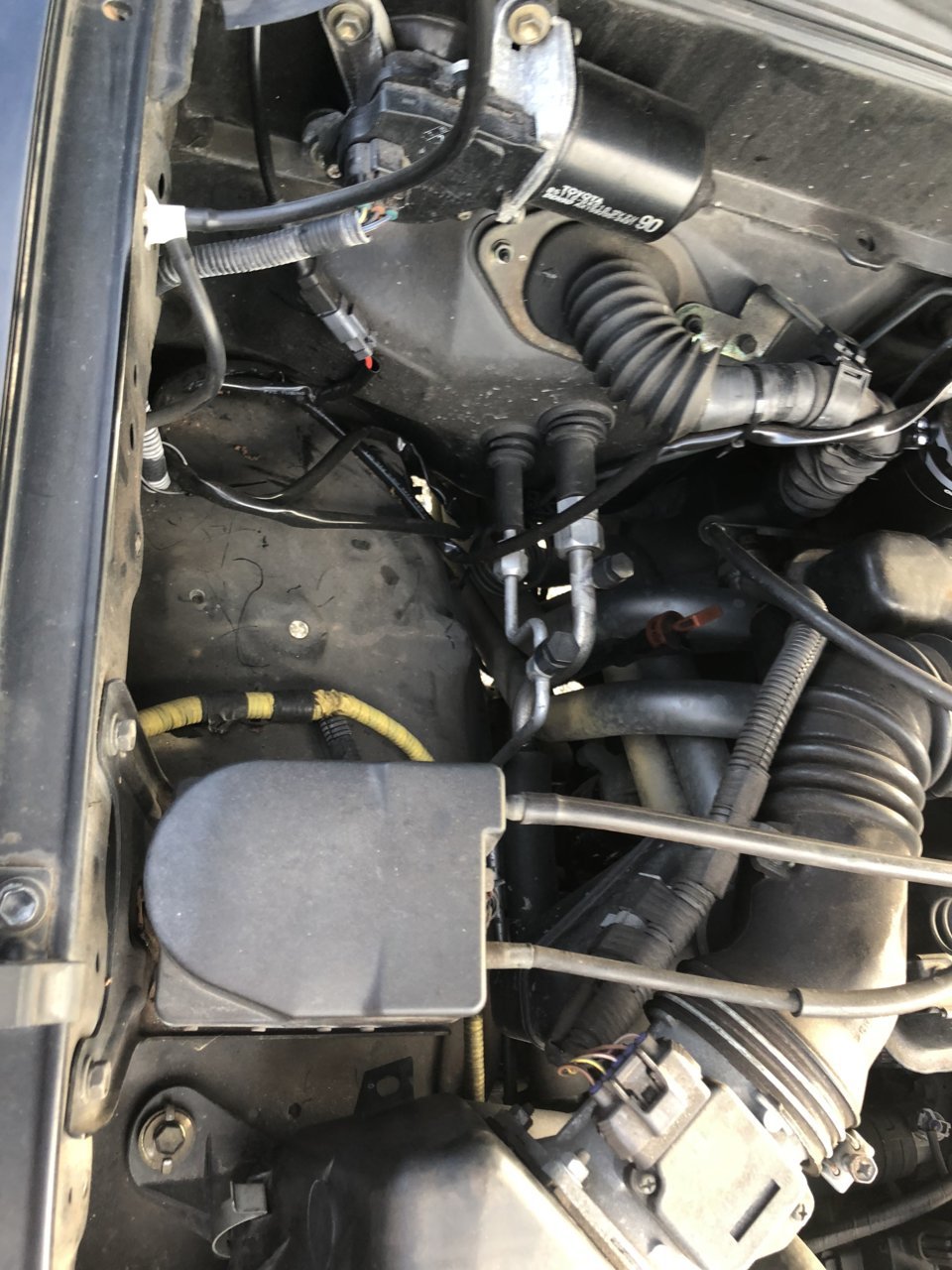

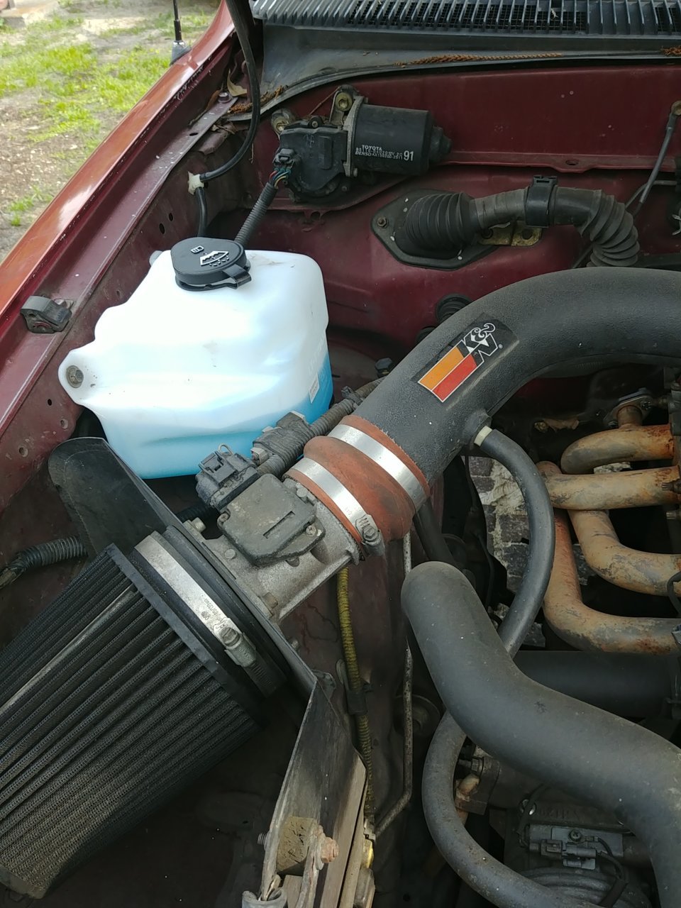

    Did the relocation today on my 01 non abs non cruise control with the linked Amazon reservoir.
    Looks good and works well!
    I just used two of the bolts that hold the OEM reservoir plastic to the wheel well. Used a hole saw to drill a 1-3/8" hole for the low fluid sensor. Didnt use any sealant and have zero leaks. Used the toyota pump and low level sensor.
    Thanks for the idea!

    Pics?
    ThunderOne[QUOTED] and DJB1[OP] like this.
  8. Jul 15, 2018 at 2:25 PM
    #48
    jdubdvdt
    jdubdvdt Well-Known Member
    Sep 3, 2017
    #229028
    93
    Tampa, FL
    01 4x4 Ext. Cab Impulse Red
    Dont mind my dirty engine bay. Haven't cleaned it since playing in the dirt haha

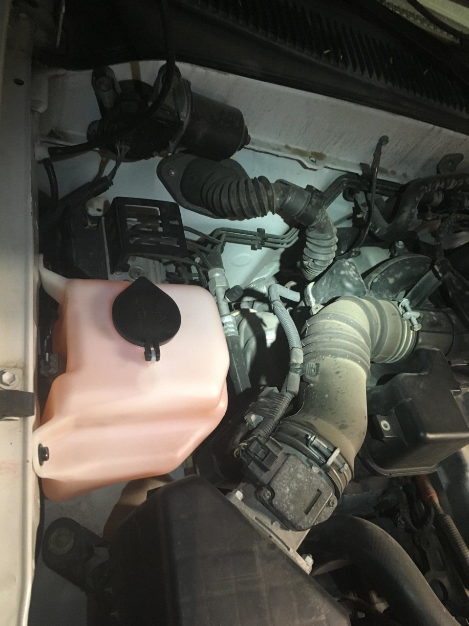

    My Kia Sportage wiper reservoir was still working fine but I was getting a little tired of how rednecky it looked, plus I just got a raise, so I spent a frivolous $29.00 on the OEM-style reservoir. I did have to bend part of the ABS modulator bracket out of the way, but I don't care because next time I'm in the mood for a big project, the rest of the ABS components are getting amputated.
