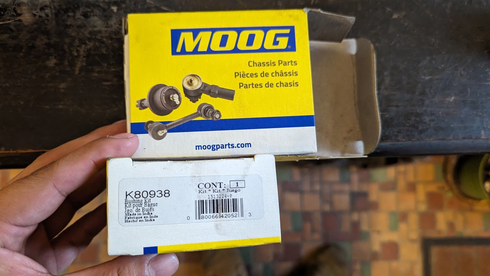

    I ordered some a pair of new bushings from Moog (which seems pretty much very similar to OEM), as well as beefier pair of bolts, nuts and washers from BelMetric. I dug this info out from this posting, where someone else was also working on the same components:
    1. Moog Pair Set of 2 Front Lower Shock Absorber Bushings for Toyota Tacoma 4WD
    2. Hex Flange Bolt 10.9 Fine M14X1.5 / 18mm Wrench DIN 6921
    3. Fender Washer HV 140 Steel DIN 7349
    4. Flange Nut Smooth Class 10 Fine Thread Steel DIN 6923

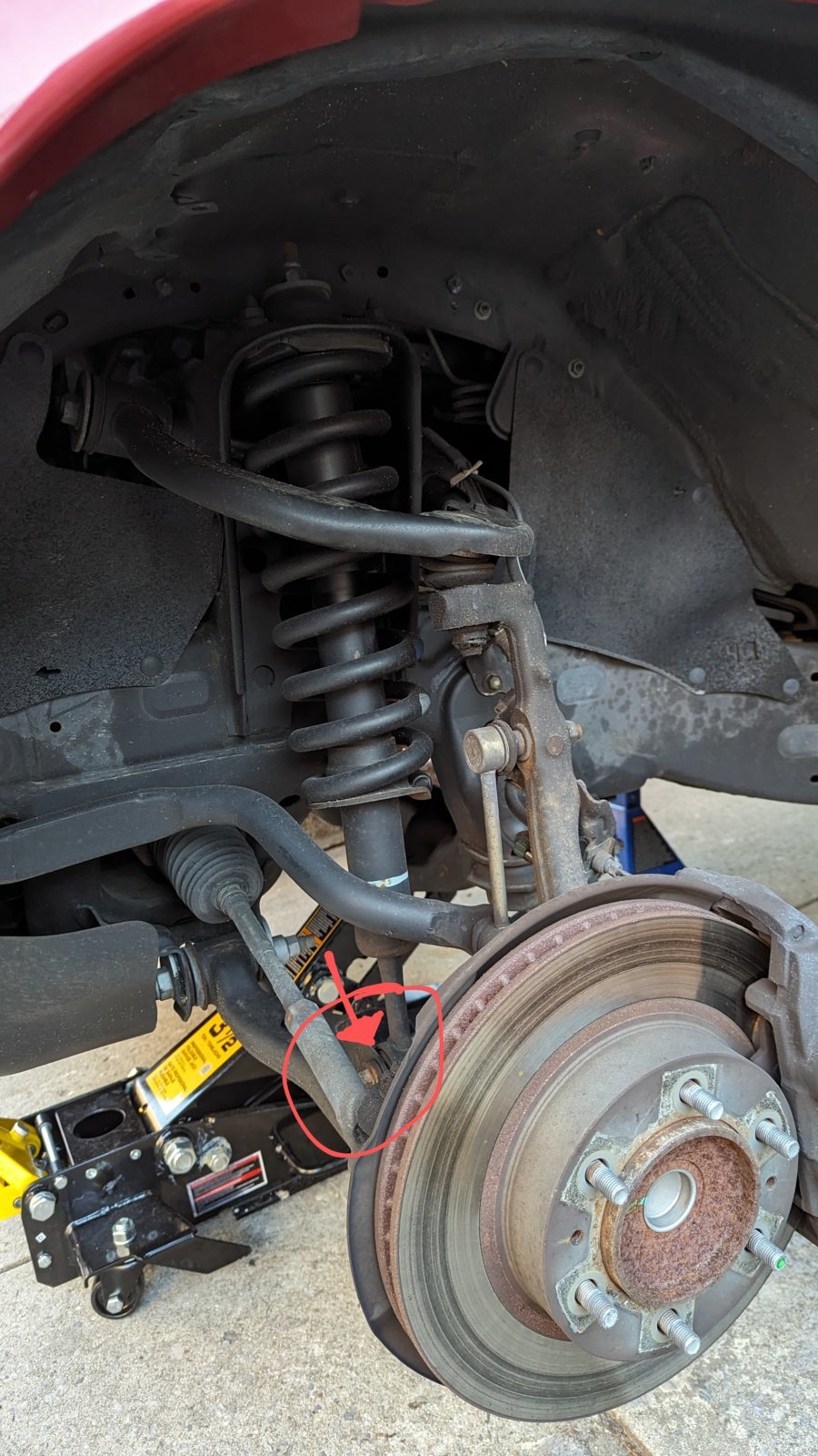

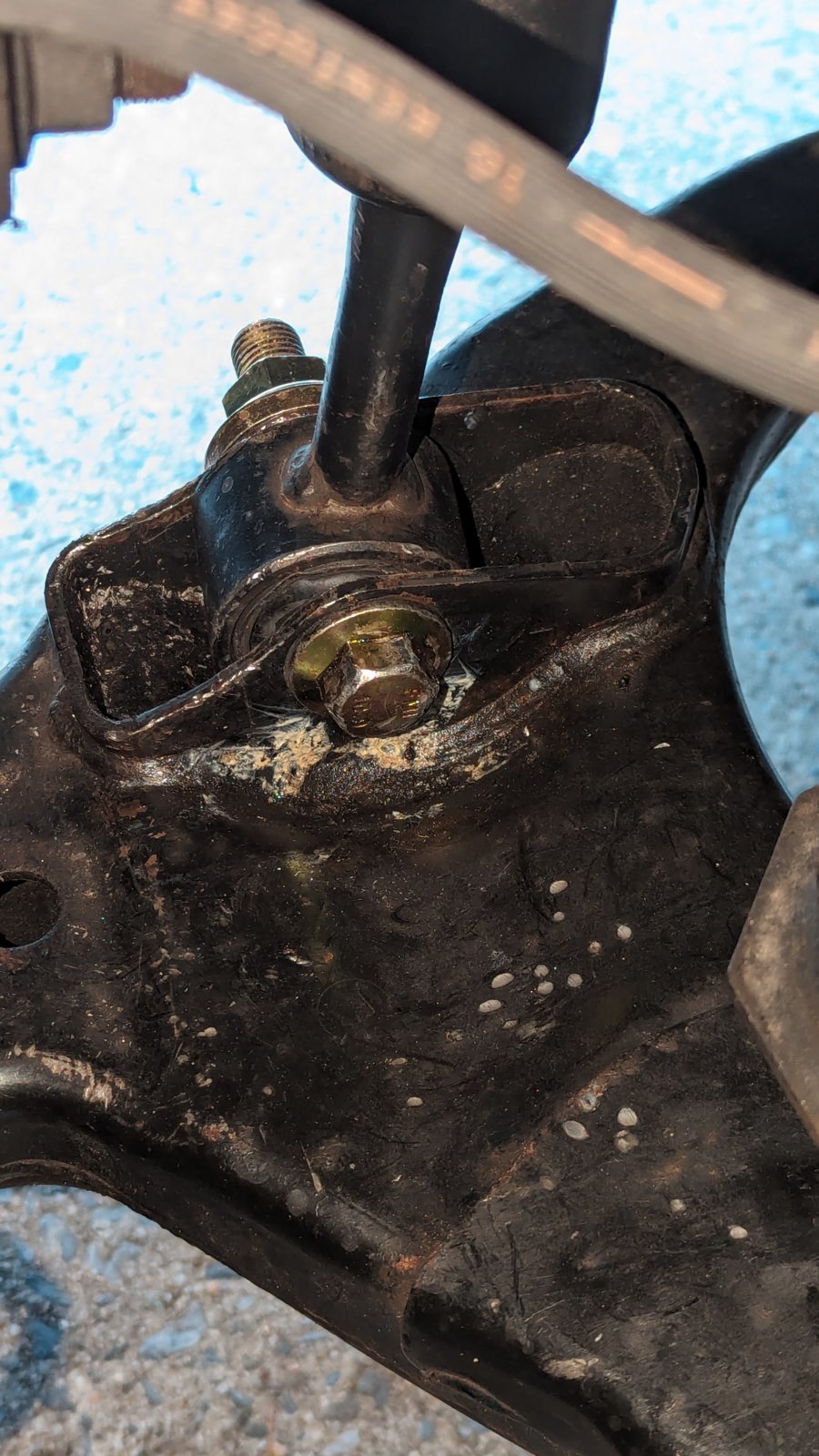

    I started by taking off the front wheels. It helps to turn your wheels for better access to the front lower shocks and bushings.

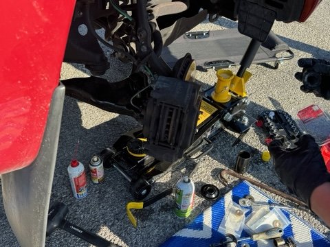

    Once the connecting bolt and washer were taken out, we used a tiny bit of gentle force with a Rubber mallet to dislodge the lower end of the bushing from the pocket it sits in on the lower control arm, so we can press the bushing out.
    (Forgive the following images, my brother took some of these on his iPhone)

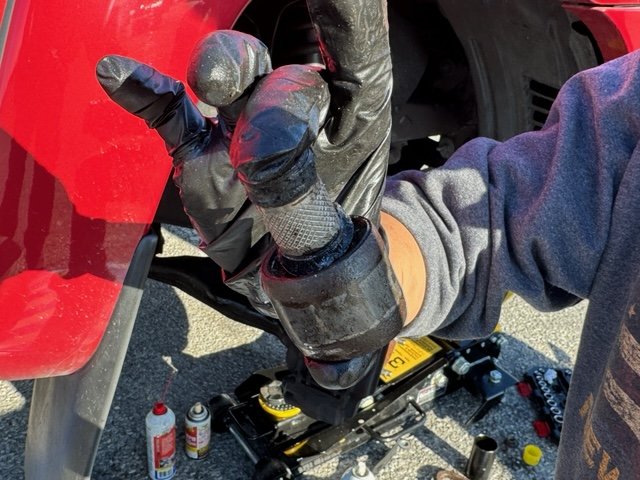

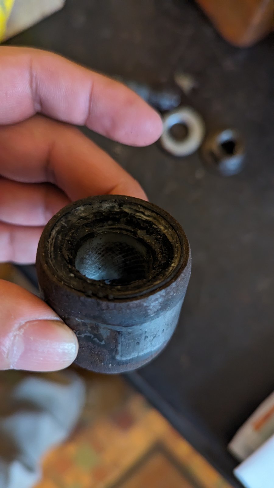

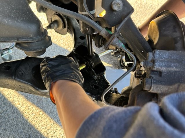

    It took plenty of brawn, diligence and force, but my Father and I managed to pull out the bushing on passenger side. Anti-rust penetrator and lubricant helped a bit. We were careful to not knock anything important, like the ABS and brake cables along the struts.

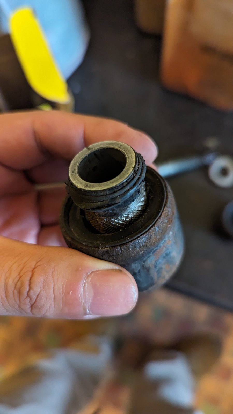

    Here's a close up of that worn bushing,
    Now, we had to replace the worn out bushings. We gently pressed the new bushing into the lower shock, careful not to bite into the rubber of the new bushing as we pressed it all the way in. We were also super focused on keeping the tool kit completely straight as we pressed it all the way in. In retrospect, a handheld clamp with a handle or a vice grip would've been super helpful with this

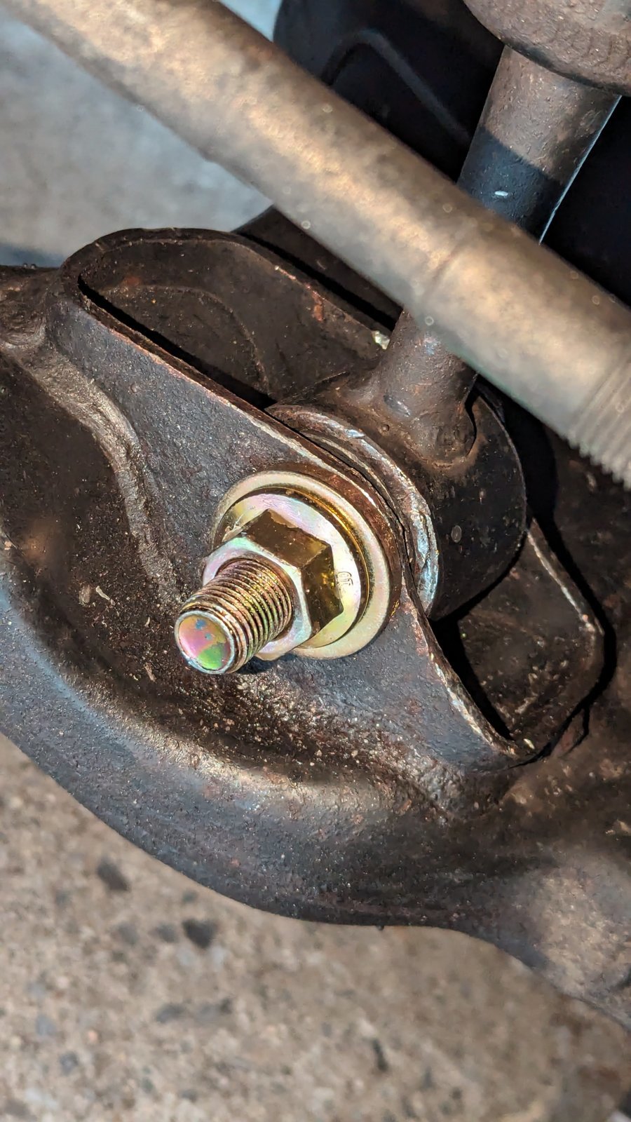

    Then it was pretty much easy to mount the washer and bolt, and then re-tightened the bolt to ~85 ft./lbs. I wish I had this guide earlier to help with torque specifications.

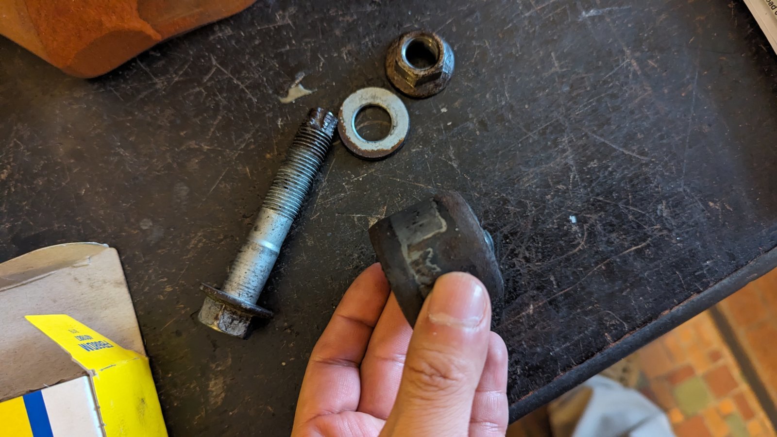

    We proceeded to do driver side as well, and being tired from already working the other side, this took a bit longer. Still, in the darkening of an increasingly cold night, we managed. Here is the old driver side bushing and the undersized bolt washer and nut:

    Here is the results in the morning after:
