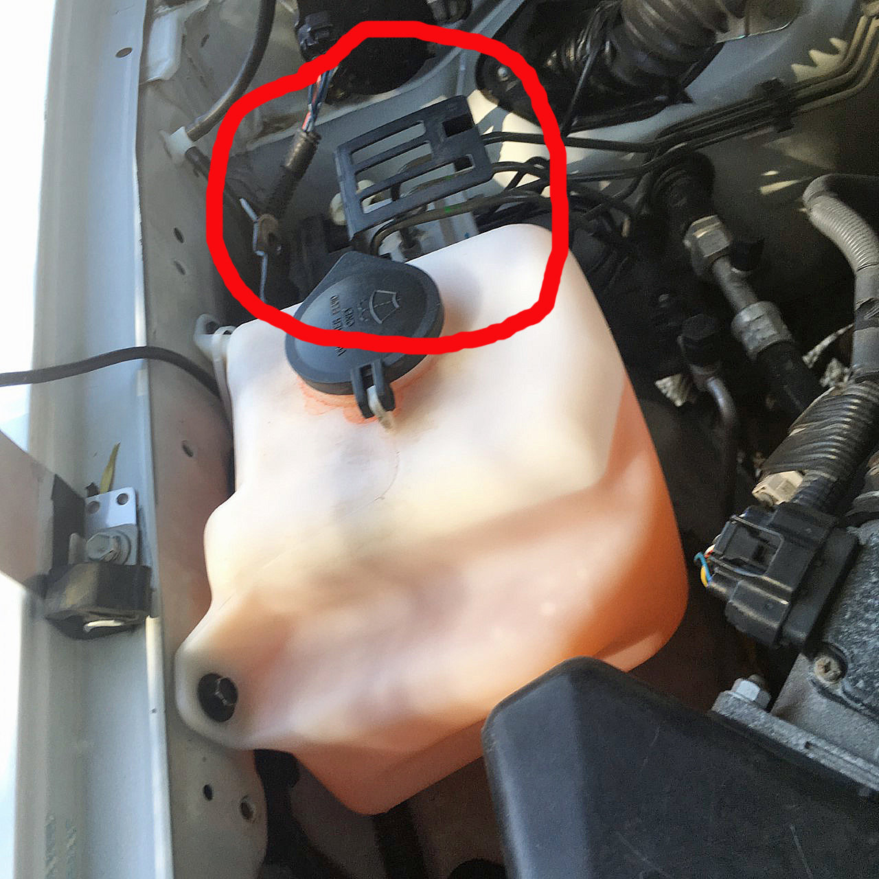

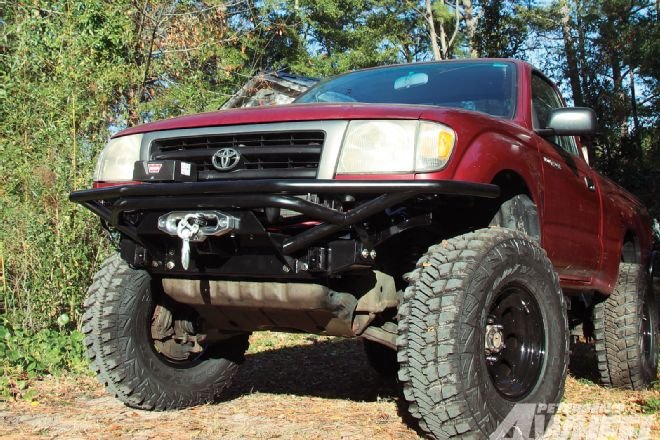

    Well, @Burro, I obsess over every modification and try to plan ahead so I don't have to redo anything in the future. I put on a Trail Gear front bumper a few years ago because they're cheap, light and have good winch access. When I get a winch, it will be much easier to install or repair compared to a plate bumper. I relocated the wiper fluid reservoir and some wiring into the engine bay, so the TG bumper install looks clean and functions well, with nothing hanging down to get snagged or smashed off-roading.
    The wiper reservoir is now right behind the air cleaner, and the ABS modulator is behind that:

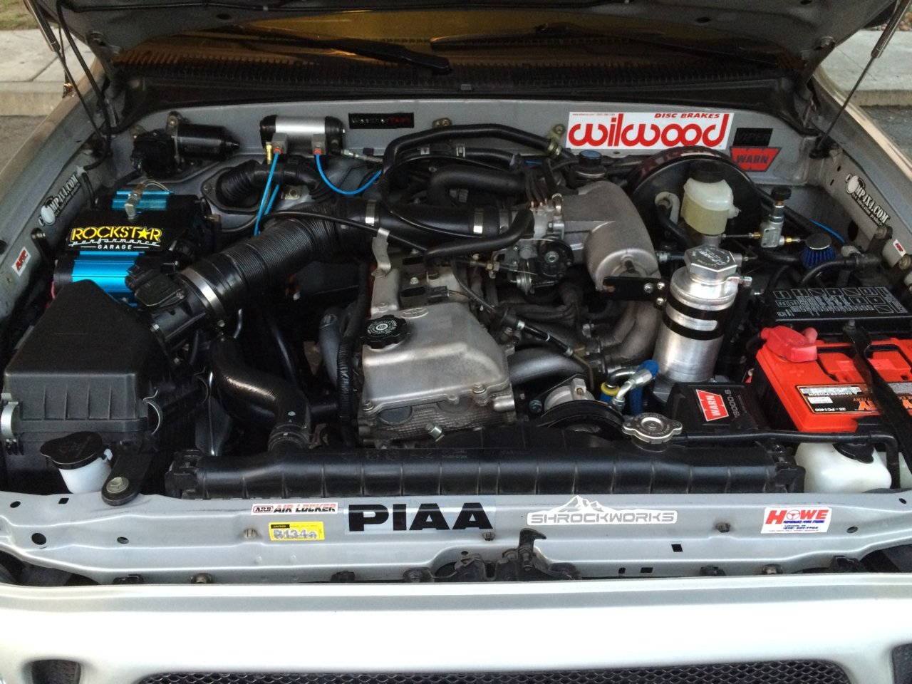

    DJB1,
    I went through this dilemma several years back. In this photo, you'll see I mounted the winch solenoid near the battery, eliminated all things 'ABS' throughout my truck and went with the ARB twin compressor system. It airs up tires quickly AND runs my 1/2" impact.
    If you need the Toyota OEM brake line part numbers, I can provide them.
    As for the windshield washer tank, I am making a 2 bracket/ mount system tomorrow for the relocation. It'll reside next to the air box using an OEM tank and plumbing. The 2nd set will go to 1999regcab.

    DJB1,
    There are a total of 6 components you'll need.
    4 brake lines and 2 ea - black plastic clips that support the RT side brake line as it travels along the fire wall.
    1. The black clips aka: Clamp, Brake Tube - 47372-35170. 2 of these required.
    2. Short PS brake line aka: Tube, FR Brake, No.5. 47315-04060. Only 1 of these required.
    3. Long PS brake line aka: Tube, FR Brake, No.3. 47313-04120. Only 1 of these required.
    4. Short DS brake line aka: Tube, FR Brake, No.4. 47314-04060. Only 1 of these required.
    5. Long DS brake line aka: Tube, FR Brake, No.2. 47312-04080. Only 1 of these required.
    I suggest removing the LSPV while you're at this. Go with the Wilwood unit which you can see in the upper RT hand corner in my photo.
    This gets rid off more unneeded plumbing, works much better and cleans up the rear axle.
    Good luck.

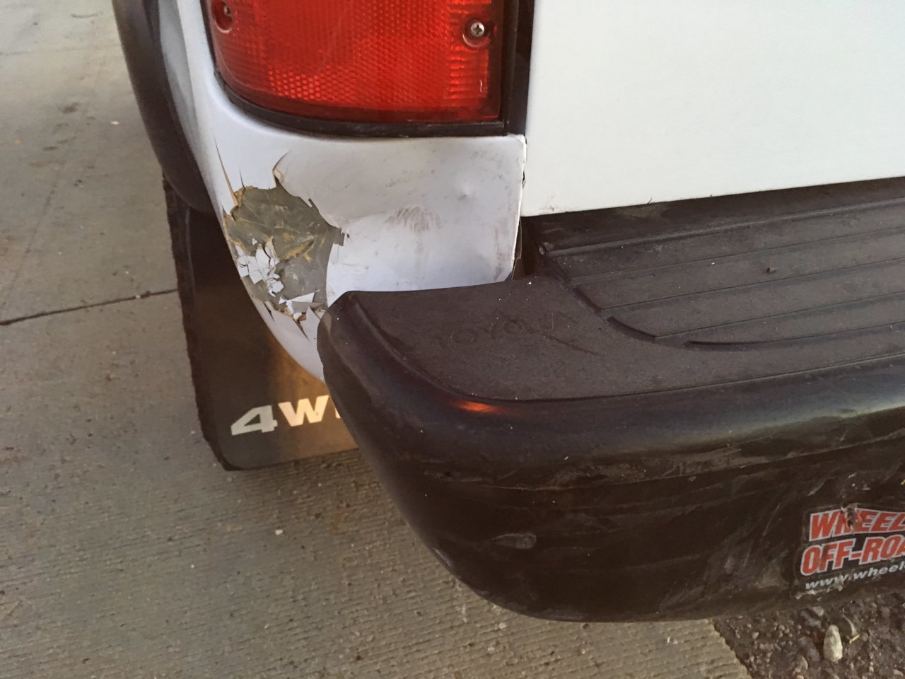

    You can’t have anything nice...

    That sucks! Your fault or someone else?
    I’m guessing someone else
  9. Sep 28, 2018 at 5:59 PM
    #149
    DJB1
    DJB1 [OP] Well-Known Member
    Jun 8, 2013
    #105835
    2,223
    Dave
    SLC, UT
    2003 Regular Cab 4X4 5MT
    It was the other person’s fault. Fortunately they are insured.

    Wrap around bumper?

    If the repair estimate is enough to pay for a Relentless rear bumper with swing outs.
